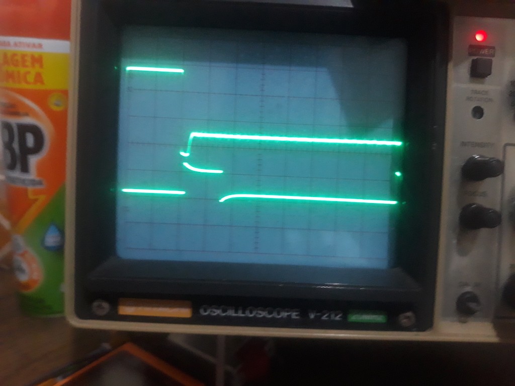

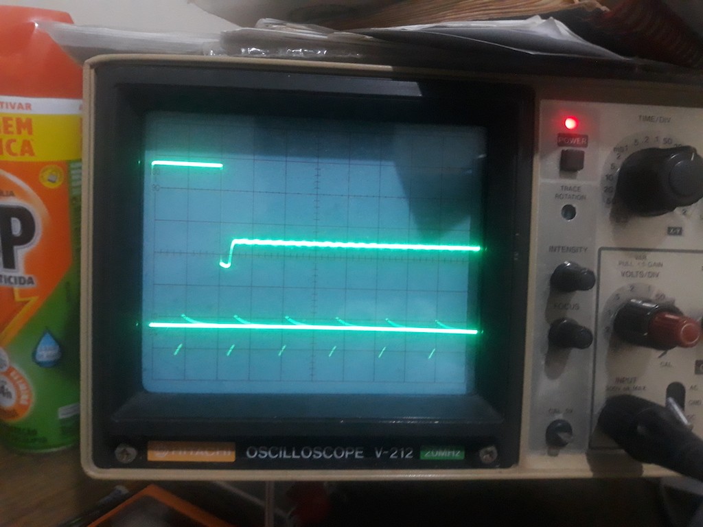

    I'm trying to build a Stm32 controlled Pi detector. Until now, I have made the TX part and I'm now in the step of reading the ADC data to detect metal and ignore the unwanted signals (EFE, GB, etc).
    The MCU I'm using is stm32f407xx and I'm using one of its internal ADCs (ADC1) with DMA transfer.
    My doubt is if I should make ADC readings at specific time windows (for example, 10us after TX pulse ends like in regular Analog detectors (sample delay)) or if I should use the DMA in circular mode and make some kind of calculations to check at what moments look for the relevant signals.

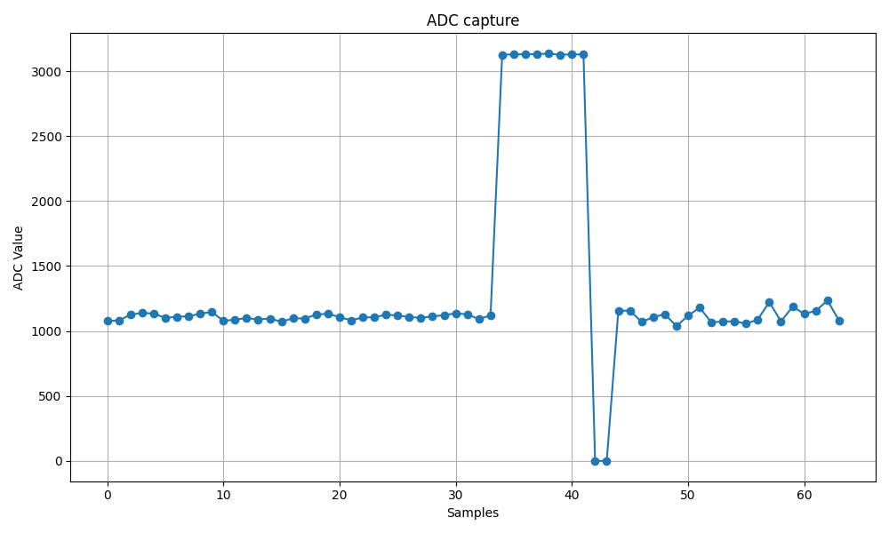

    Below is a capture of 64 samples of my ADC with DMA in circular mode:

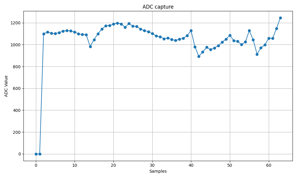

    Below is a capture of 64 samples of the ADC in normal mode, captured after a delay of TX pulse end (seems a little strange to me):

    I would rrecommend to sample synchronously.
    ... all ADCs basically have a modulator at their input so if you sample asynchronously you are looking at the product of Fo and So where Fo is your signal fundamental Tx Frequency and So is your sampling frequency.
    If this product falls within your target passband then you will get uwanted side effects in the data.
    Oversample and integrate for best results.
      Thanks, I'm trying to implement it that way using timer triggers and interrupts. I'm currently using bare metal code, if I choose to use the HAL library, you see a relevant performance impact or is this something I should not worry about?
        I have tried to use the ADC with DMA but was not able to properly synchronize the sampling to the correct times (decay curve). So I make a "manual" ADC read (Capture_ADC_Samples() method ) and now it basically works with a simple average.

                      Thank you, I will try that later, anyway I tried to use hardware triggers and ACD with DMA but was not able to check the capture times in the oscilloscope in a consistent way.
                        I tried your code from Deepseek (it required some fixes to work) but again, as I have tried before, when using DMA with circuar mode, I have ADC data from the entire time window and not only the most important part (the decay curve), as it can be seen below.
                        I added an image for each case (a python chart displaying 64 samples and a scope image showing the preamp output on channel 1 and the ADC capture start / end on channel 2)
                        Synchronized ADC (sample window):
                        I think I will use the second approach (synchronized sampling) as it contains only the useful data and I can focus on it, otherwise I will need to have logic to extract the decay curve only.
                          For now, I just gave up the direct sampling because it seems too slow. Now I will use the Stm32 just for controlling the timings and to add some detection logic at the end, using analog demodulation.
