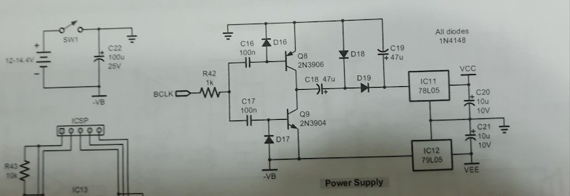

              I'm now trying to change the circuit to use a NMOS coil switch like an IRF840. I changed all the power supply and now VB+ is the ground. I'm powering the STM32 board from -5V of the 79l05 regulator connected to STM32 ground and circuit ground (VB+) connected to the STM32 5v pin. Until the preamp all seems to work ok, but now I have a problem: the STM32 3.3V outputs, when referenced to the main circuit ground (VB+) are not measuring the correct voltage and this causes problems with the ADC readings (VREF), etc. Is there any other way of properly powering the STM32 with 5v and share the same ground? Thanks.
              I'm using the following power supply schematic:
                Would it work by powering the STM32 from the 78L05 instead of the 79L05, using the VB+ as the STM32 ground and the main circuit ground? You could use an extra 78L05 if the STM introduces noise

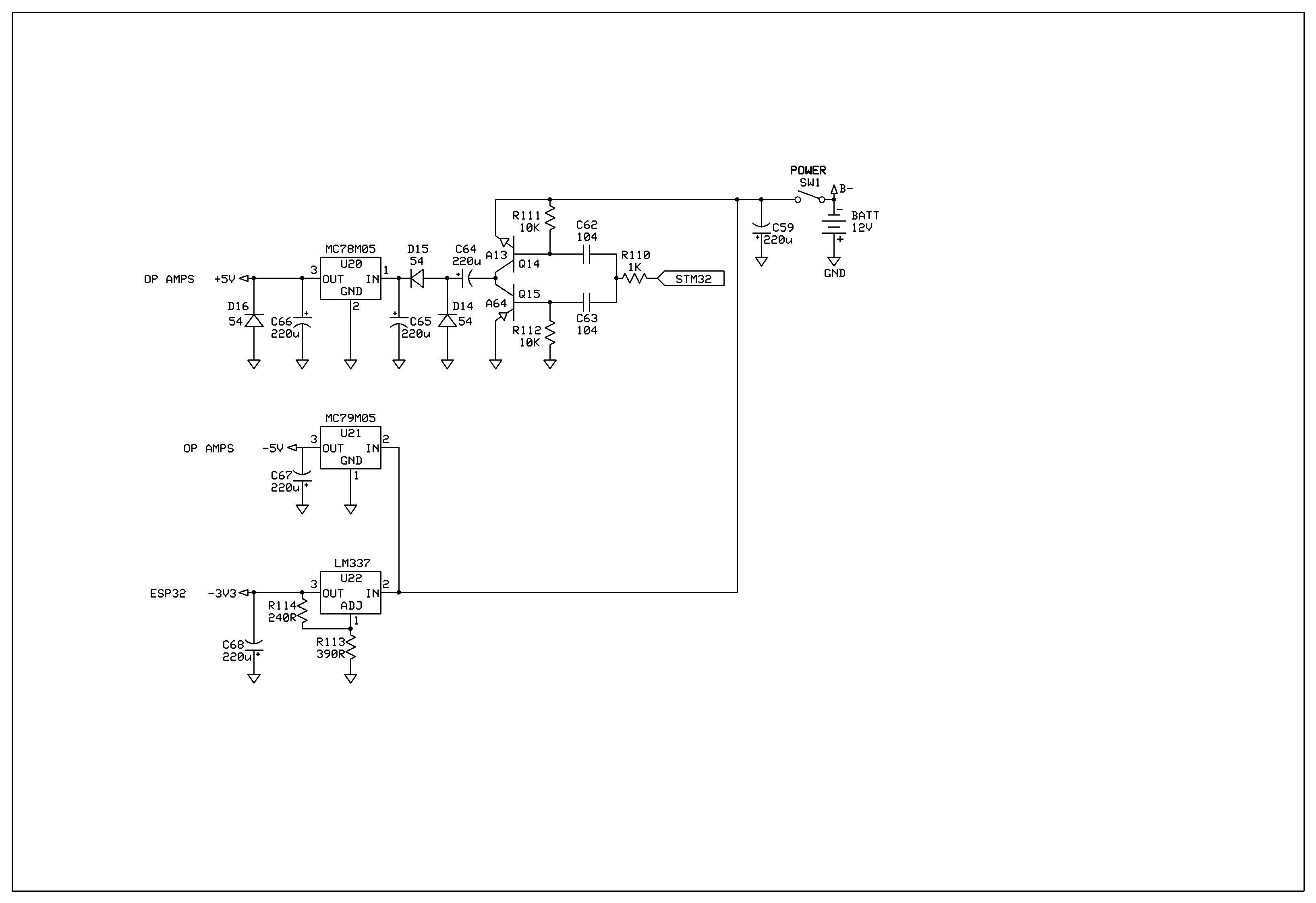

                  Hi Cristian.
                  I'm using this schematic in my project, and it works very well. My ESP32 is also powered between GND (+BATT) and -3.3V.​

                    Hello, Christian.
                    This circuit does not provide power to the processor chip.

                      I am back again with this project. I'm now trying to use the GS5 lite from Eduardo power supply, with a LM337 regulator from -12v to provide -3,3v to power my STM32f407vet6 dev board and I am wiring it from -3,3v and GND.
                      The Stm32 board powers up, but does not run the program, it seems like it stays at programming state or something like that.

                          I am running the 3.3v pin of the board connected to my circuit ground (+VB) and the GND of the board to the -3.3v of the circuit regulator (LM337) so the board sees 3.3v.
                            thats fine but the logic levels will be wrong for the programmer which wont be connected like that.
                              Thank you, what you suggest me to do? Is there any other option to power the stm32 board in another way in a circuit like that (where we used VB+ as GND)?
                                There are 2 ways to deal with this, I have used both.
                                1. Disconnect the power supply to the board, then connect the programmer and allow the programmer to power the board with +3.3V and ground. When programming is done, disconnect the programmer and then apply the -3.3V power supply. This method means you cannot use a run-time debugger.
                                2. Use a galvanic isolating USB cable to drive the programmer. This will provide DC isolation so that you can power the micro from -3.3V and still program and debug.
