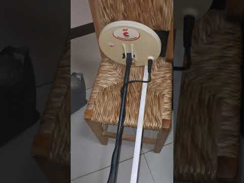

          I got a much better sensitivity now after reducing the sample width from 10us to 5us. So that explains that my main problem is noise?

            Some more tests: https://www.youtube.com/shorts/SNQcJdVVXW0
            Details
            Hardware: Power supply, TX and preamp almost the same of Goldscan 5.
            Coil size: 23cm
            Freq: 2.6khz
            TX pulse width: 100us
            Sample pulse delay: 10us
            Sample pulse width: 5us
            Analog demodulation driven by 4066 with software controlled timings
            ADC reading from the output of TL072 sampling integrators
            No GB nor EFE subtraction yet. Just the main sample with software average driving a PWM VCO.
            Audio output: piezo buzzer
            MCU: Stm32f407vet6 dev board
            Some results:
            - 1 euro coin: 28cm
            - 2.4 gram 18k gold ring: 26 - 28cm
            - 0.9 gram gold nugget: 10 - 12cm
            Would you try to get more performance (distance / depth) or is it better to go further to the next steps now (GB, etc)?
            Thanks.
