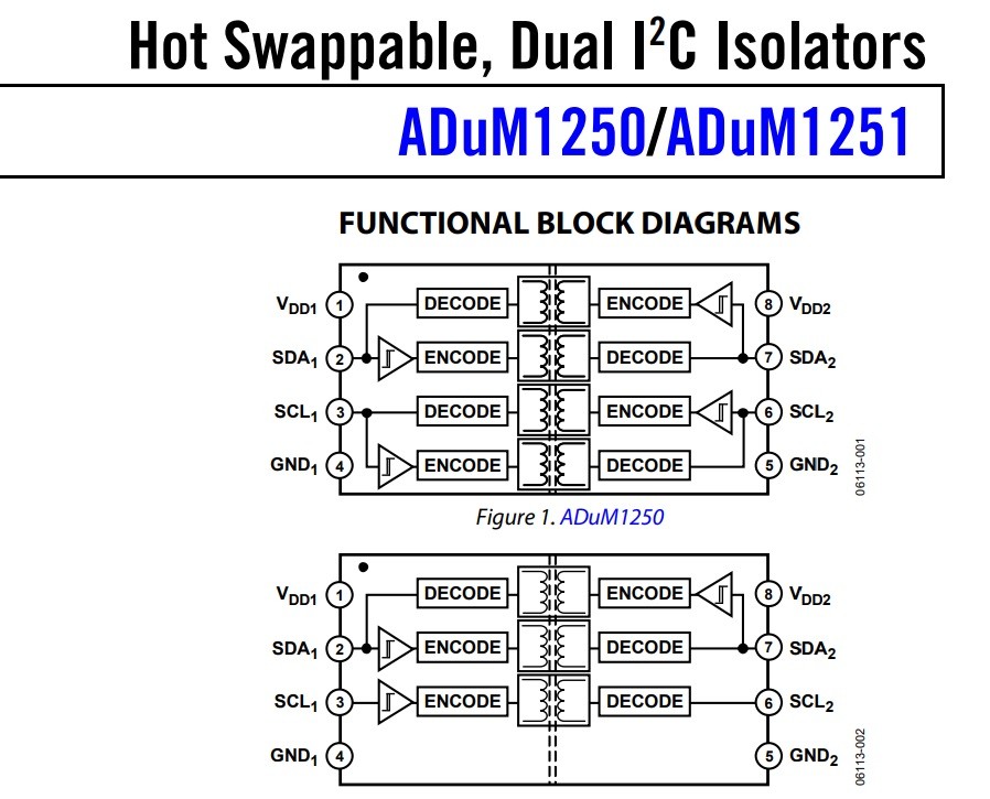

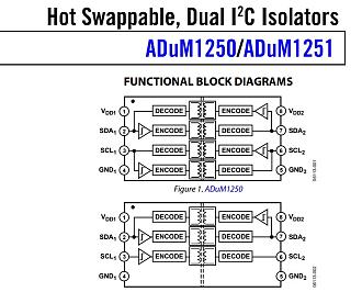

        Wouldn't it be okay if you use isolated DC-DC power supplies, for example XP Power SCT01F12S3V3 or Roboway B1203S-1WR3, but then you have to use the signals from the STM32 not directly, but with optocouplers for digital signals PC817, 6N137 or digital isolators ADuM12
          It is a good idea but I am concerned if using optocouplers could introduce some unwanted delays in the execution.
            I don't know, try digital isolators too, you can't know until you test them, and I haven't used them, if anyone knows, please share. Click image for larger version

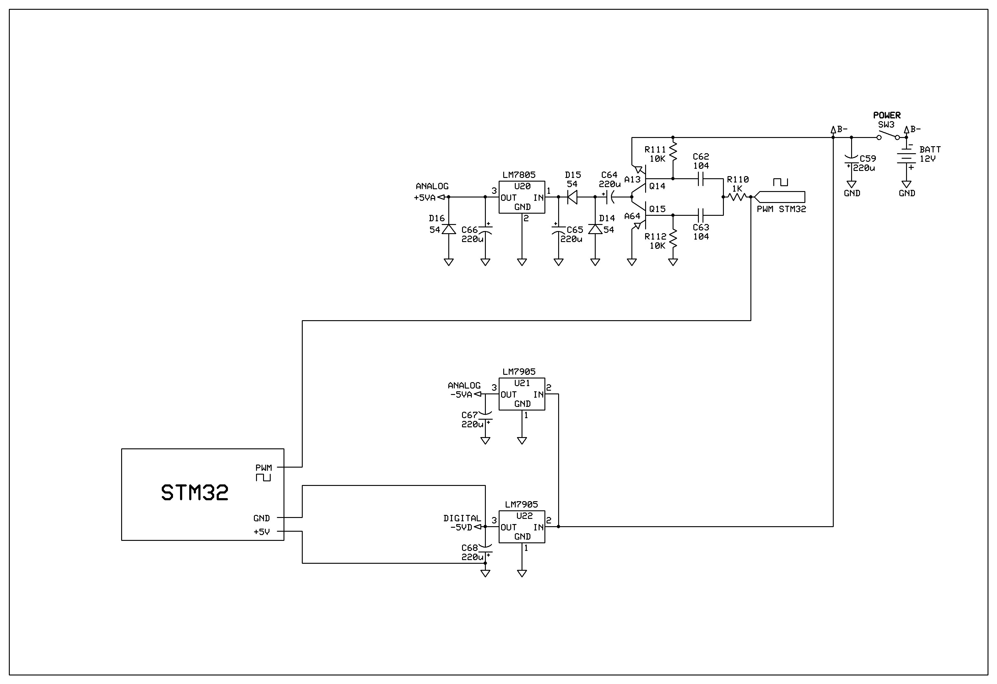

                I am running the MCU from the negative supply because I dont have a positive voltage do feed it, as the power supply I am using uses VB+ as GND.
                Check the attached schematic (my only change there is that I'm using a LM337 instead of the LM7905 that comes from -12v).

                      What should I do to drive the -+5v charge pump with the PWM signal?

                      • #41
                        Hi Cristiano.
                        I've attached a diagram of the charging pump you need for your detector. I use the same diagram for my projects and it works quite well.​
                        • #42
                          Originally posted by eduardo1979 View Post
                          Hi Cristiano.
                          thank you !
