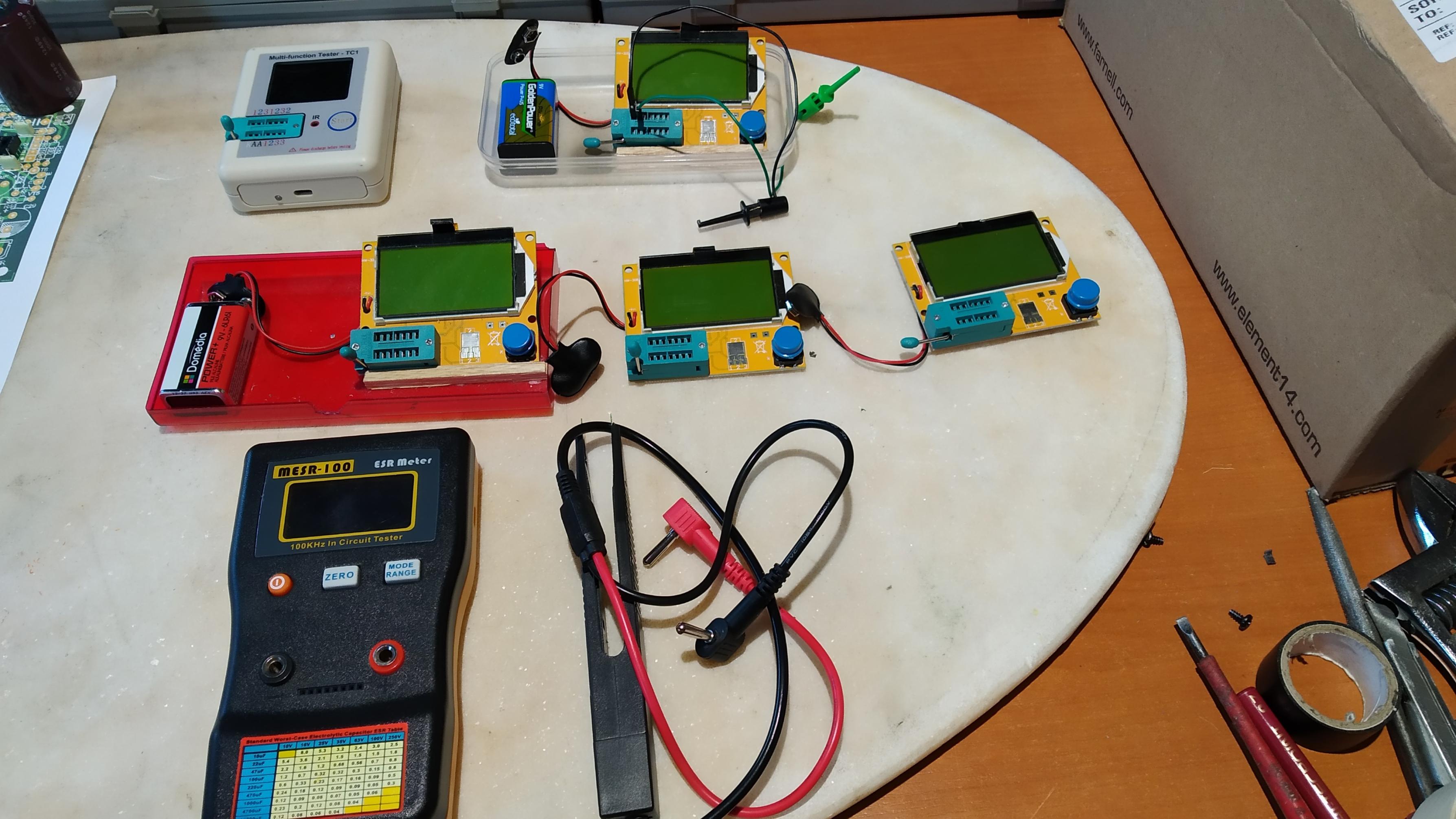

            Click image for larger version  Name:	IMG_20250921_082926.jpg Views:	0 Size:	581.8 KB ID:	441042
            I think I have ESR covered. The white tester top left, I had two of those, they did not last long. Bought 4 yellows ones and I have not manage kill any of them, very robust & cheap.
            The black gadget is accurate but only does ESR. The black tweezers look handy for SMD which I have not done before.

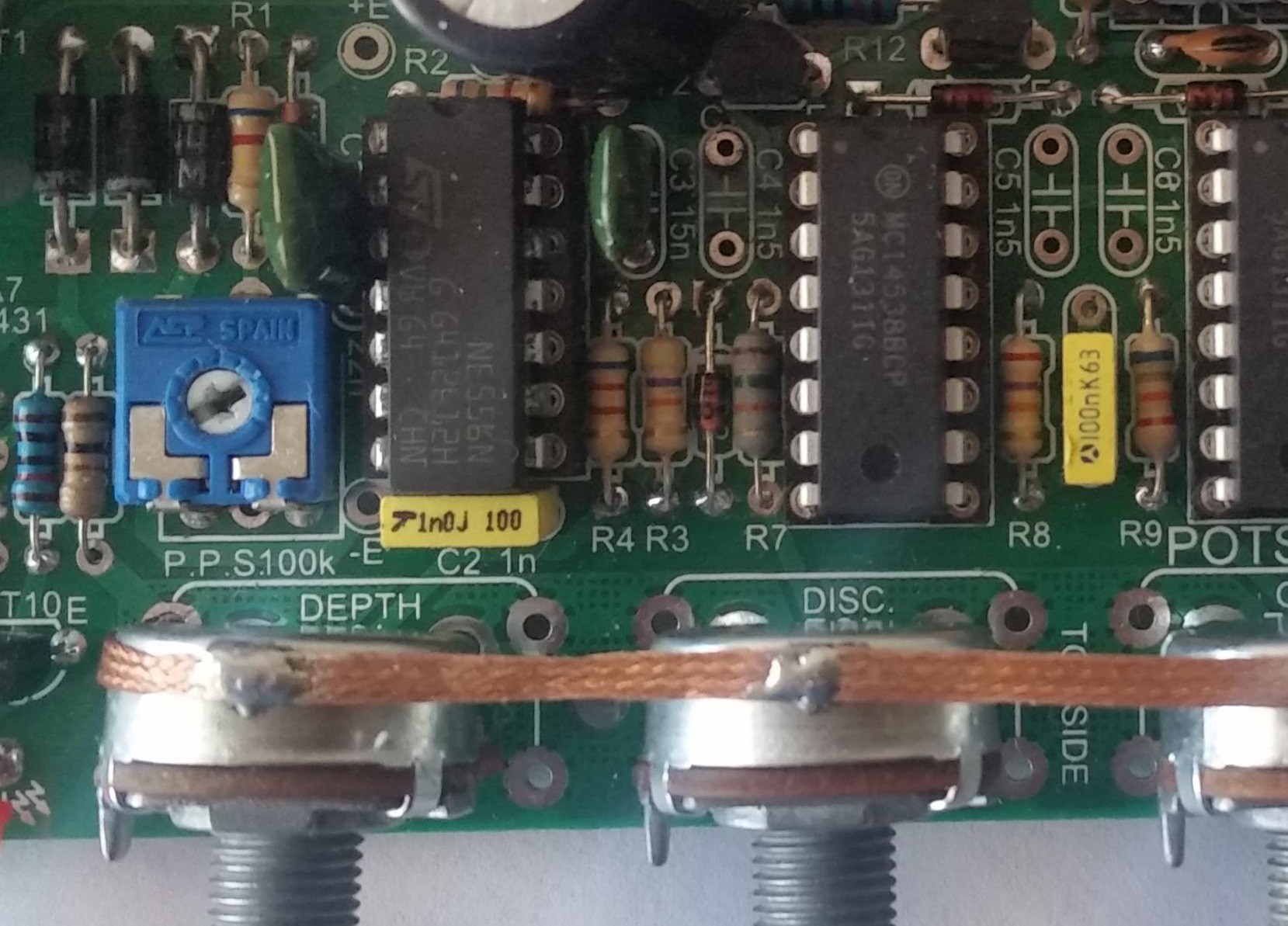

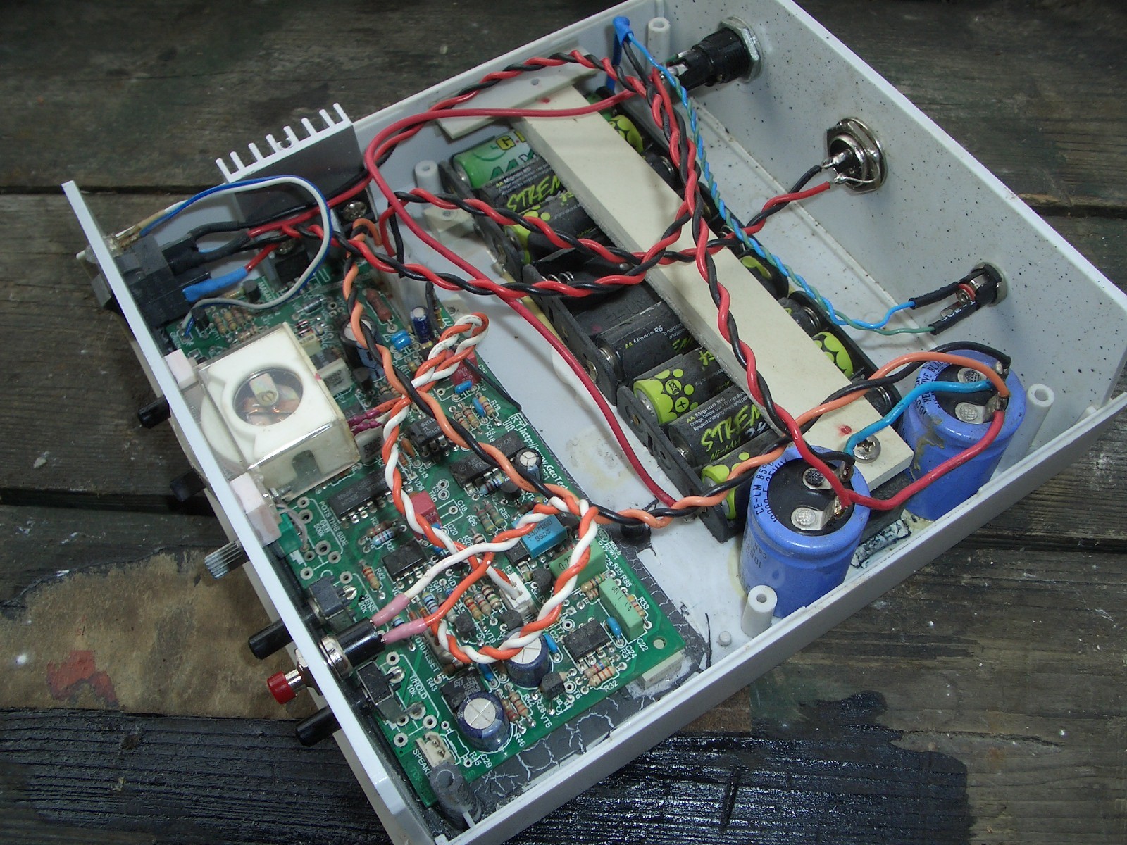

              A few questions I have with these 2 images.
              The difference in soldering technique, which is the best?
              The missing components in image 2, is there a reason they are not there?
              The reason for the braided wire across the potentiometers?

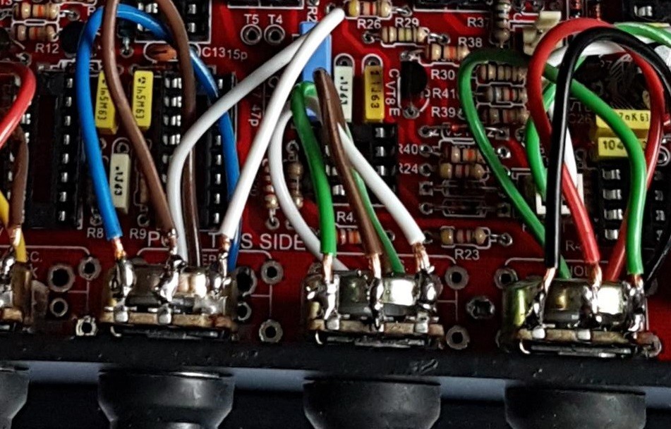

                  first pic a guy sets the pots in any place of face housing panel he wants. his pots 'pins back angle', not fitted the pcb directly.
                  second pic with braided wire is ESFI protection of the pots. pots are metallic and electrostatic goes from your hands you touch the shafts creating a noise in circuit.
                  no missing components. i do UNIVERSAL places for the pots and they are all DIFFERENT. people can set that they have in trash box. Click image for larger version  Name:	CIMG6230.jpg Views:	0 Size:	370.1 KB ID:	441049
                    Caps: stand them up or lay them down, doesn't make a difference.
                    Pots: mounted to the PCB is cleaner and less likely to have EMI issues, but more limiting and difficult to layout. Mostly it's just preference. The braided strap is for grounding and is likely overkill.

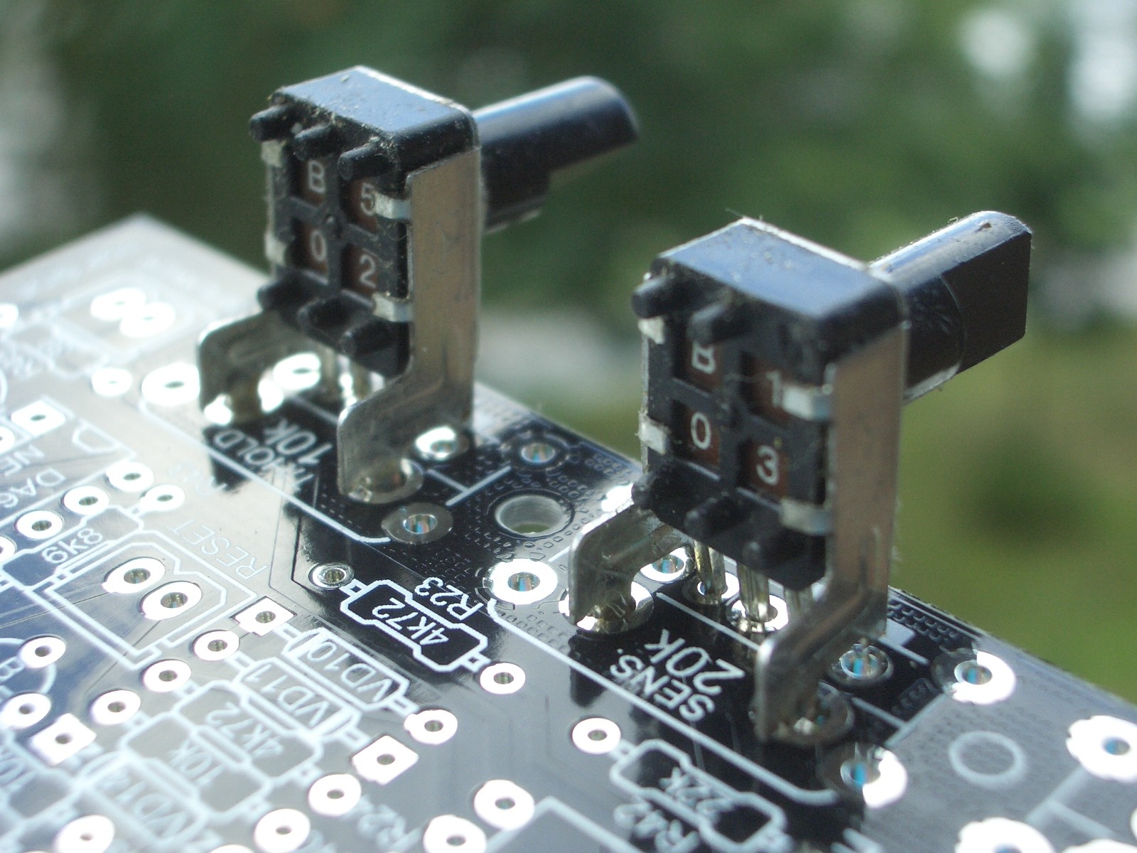

                      Pots were projected right on pcb because a customer must not be overloaded by questions what-wire-where-goes. the layout is very clear and clean for everybody.
                      you put a pot directly in the pcb and it is right. pakistani guy got working DP, without a knowledge in electronics, it is sure meaning everybody can do.

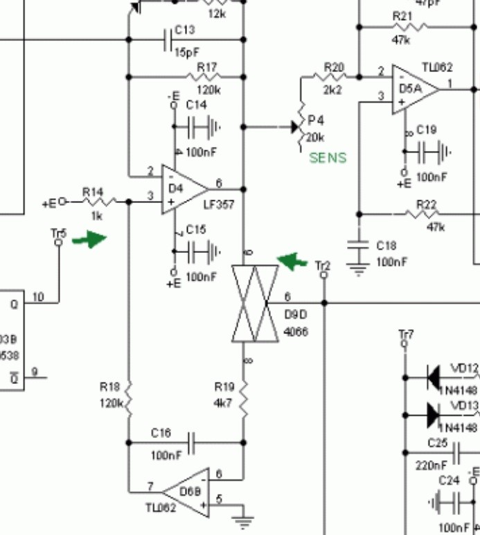

                        Actually, there is another problem that I remember when I did Delta Pulse 15 years ago, it is the slow recovery. Please Carl tell me what the correction should be to have a fast recovery after the signal. Click image for larger version

                          On soldering you missed what I meant. Its the soldering top and bottom on components such as resistors.
                          Is it necessary to solder on top as well?
                          Are there benefits or even disadvantages to using more solder?
                            in my opinion not. take strong attention that the metalization is tin. i can not pay for 2 oz copper cause it will be two times above price. so the boards are 1 oz.
                            you have not to delete the copper resoldering components. if you will accidentally delete the copper nobody will help you.
                            metallization is in every hole but you do not see it, unvisible. a hole with deleted copper does not conduct a current from one side of the board to another and break up a circuit line, you get big trouble in repair, in troubleshooting.
                            clean every pin of resistors and capacitors by rubber eraser (kids use) before soldering.
