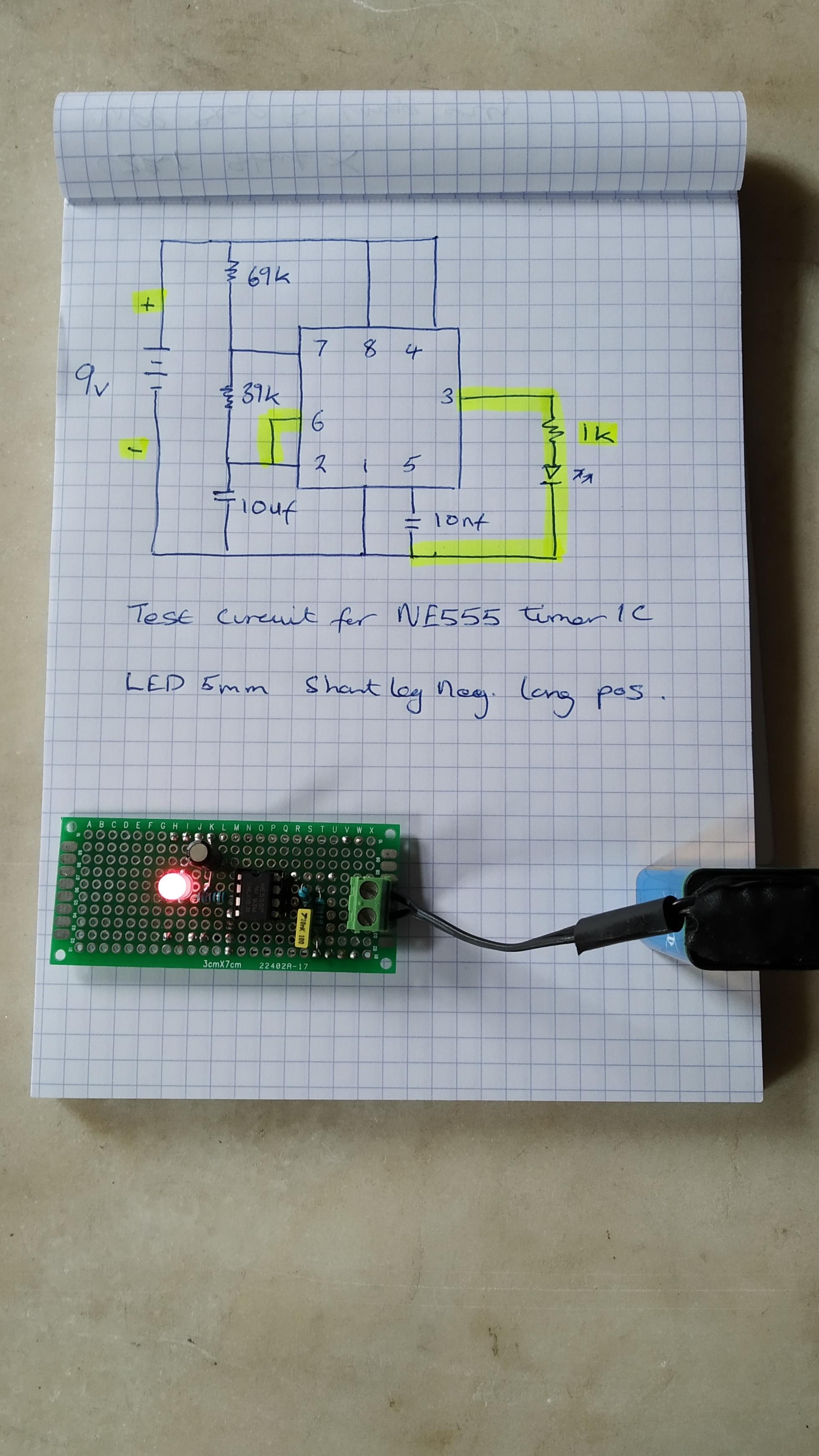

              I'm starting with building a NE555 tester. I've found what I think is a good example on a Youtube video with actual spoken words not canned music.

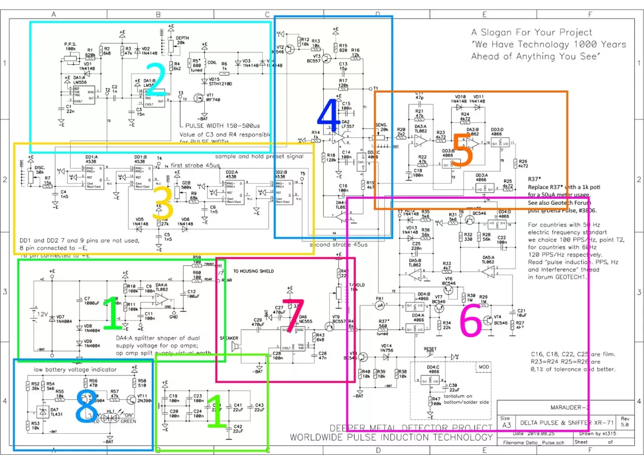

                Hi Infamy,
                Thanks for your reply. Based on the Deltapulse schematic drawn by KT315, I've drawn the order in which I would begin assembling the detector. In Block 2, where you need your test coil, you should already have a ready-made one. Maybe that will help.
Name:	Delta Pulse by KT315 (blocks)2.webp
                  absoliutely right, Geo, but i suggest to check sound isolated on stage 2. your is 7. i got very much requests why no sound getting and they were extremely offended.
                  sound must be ALWAYS - it is rule.

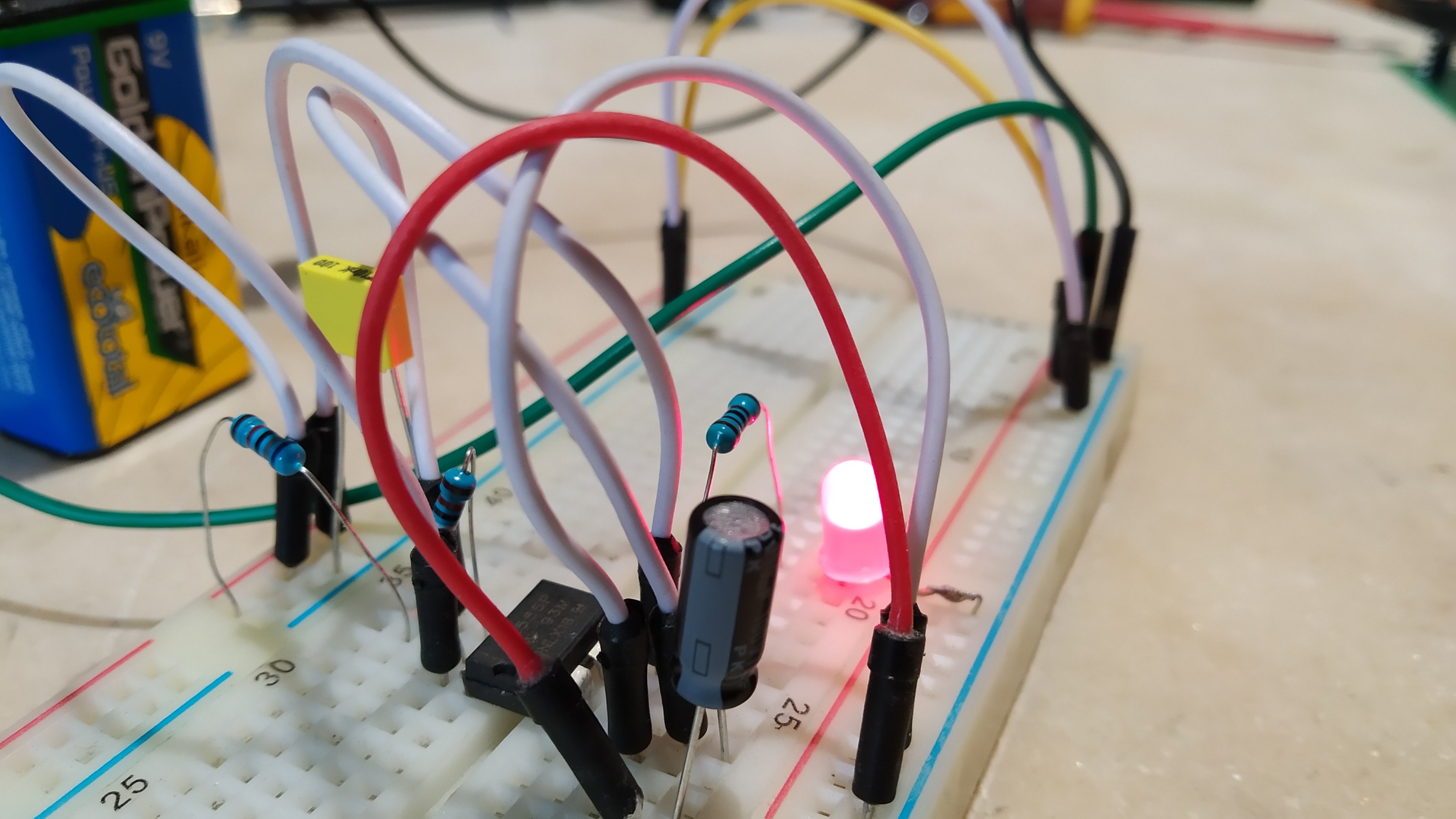

                      NE555 Tester. Faulty NE555 chips were identified as a problem in past Delta Pulse builds.
                      This tester should remove one problem to start with. Original design can be found here.
                      Click image for larger version  Name:	IMG_20250913_172250.jpg Views:	0 Size:	812.2 KB ID:	440844
                      The original design had the resistor value missing next to the LED. I used a 1k resistor as that is what I used on an
                      amp when I wanted to change the light colour of the dials. Originally the design used a 1uf capacitor, but a
                      10uf capacitor is needed to make a 1 second led flash inteval, I did not change original capacitor symbol which is
                      probably wrong. A couple of things I found out, worth doing a continuity test if nothing is working, the current does
                      not go the whole way down the bread board so its possble to have the battery connected to nothing. Worth highligthing
                      the schematic as you complete a part, so easy to miss a connection even on something as simple as this.

                        Hi Infamy,
                        Well that's a result, thanks.
