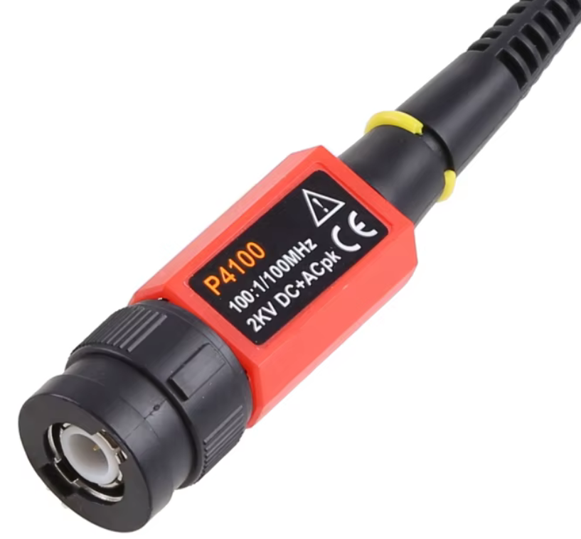

    I've just bought x 100 probes and I wondering when is it safe to use x10 probes & the oscilloscope is not going to go up in smoke.

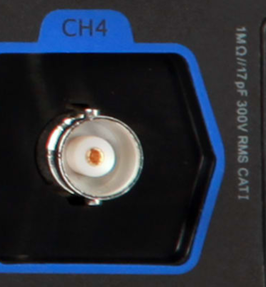

      On the probe issue, your oscope should have a max voltage rating shown close to the probe jacks. My digital scope is 300v rms and my analog scope is 400v rms. Furthermore, the probes should also be labeled with a max rating. My 10x probe says 300v (150v in 1x) and my 100x probe says 2000v.

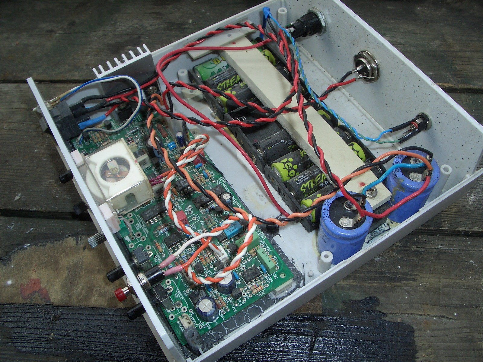

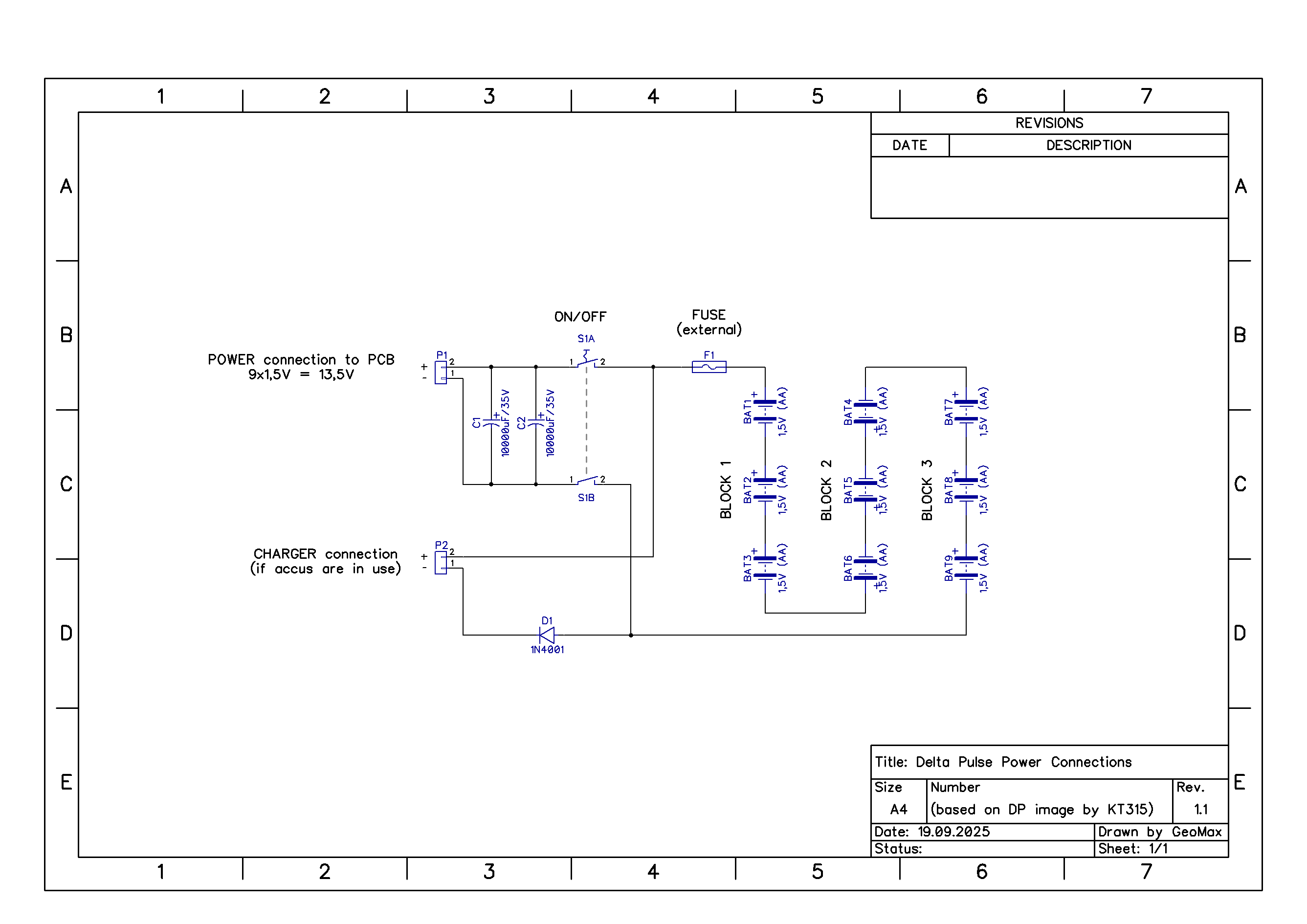

              This is from the KT archive on the DP. What advantages do you achieve with that pair of 10,000 uf caps. as I
              I have a good pair that I have salvaged. Is there a schematic of this battery set up or could some one draw one as I can not trace all the cables.
              I assume there is a fuse in there some where?
              Are there any advantage of using Lipo batteries?

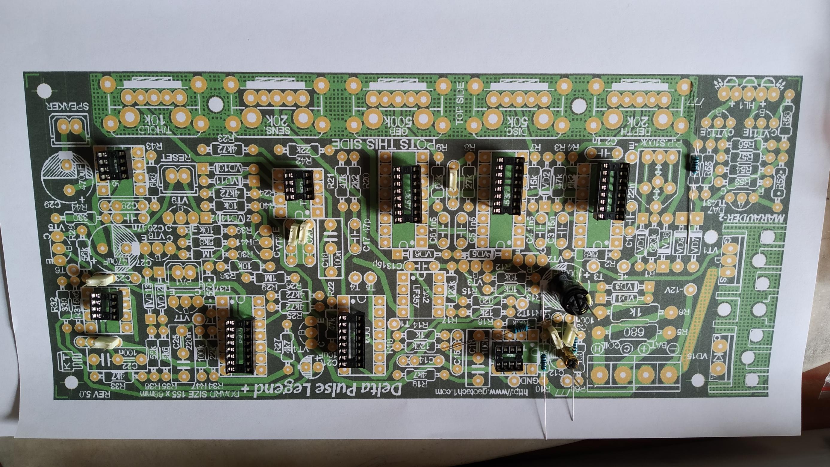

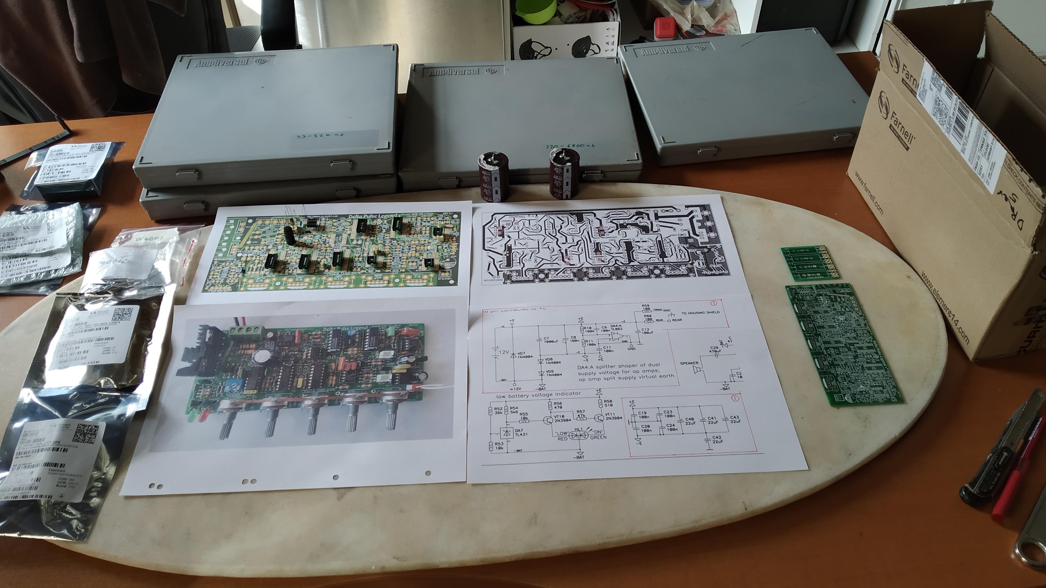

                Stage 1
                Before arriving at stage 1 obvious mistakes.
                The wrong component value.
                Ordering SMS instead of through the hole components or vice versa.
                Writing SMS when it should be SMD surface mounted devices.
                Wrong size component, distance between legs.
                Working from the wrong revision.
                Not ordering all the components required.

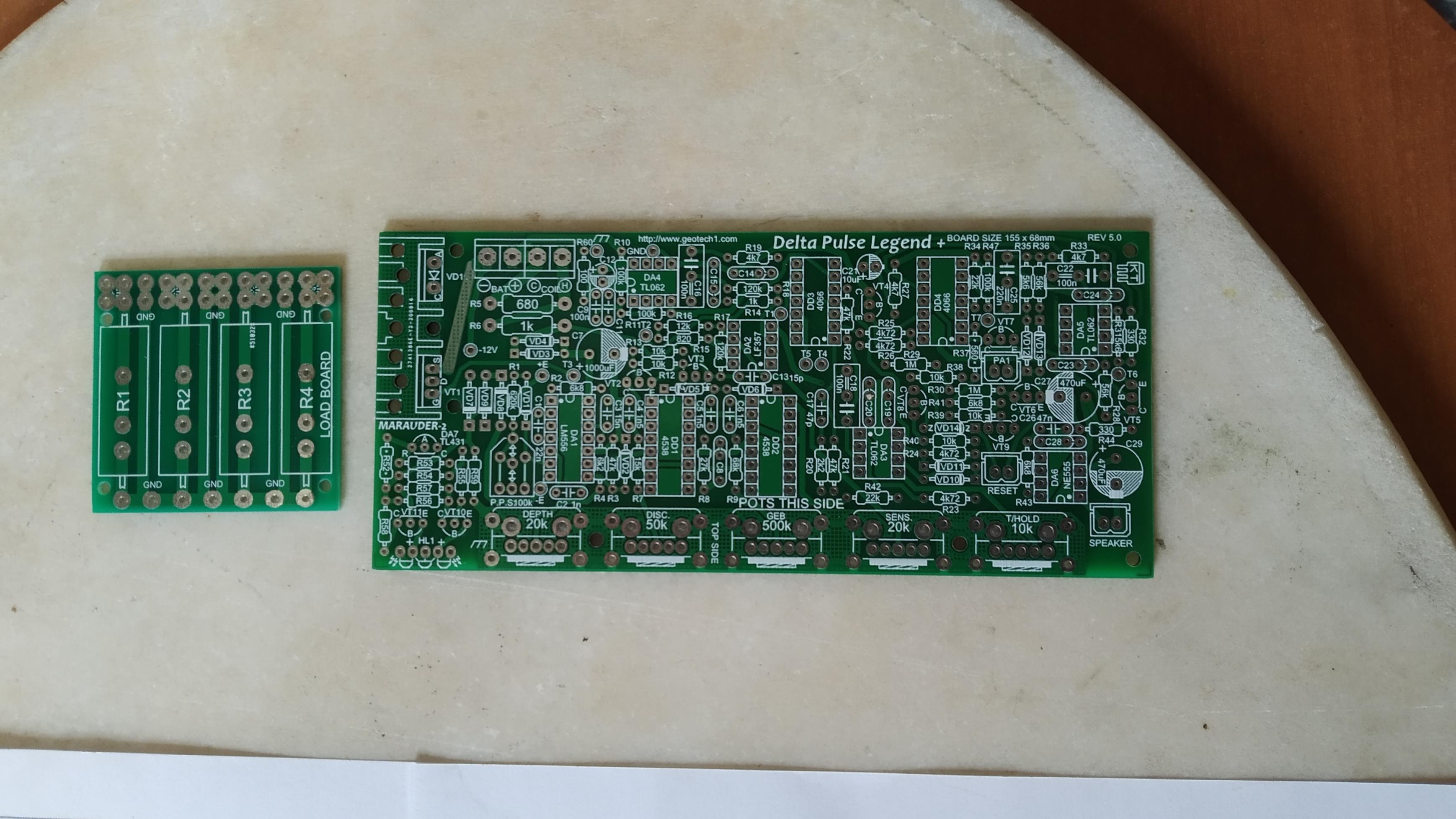

                Well this my layout for not messing up. On the side out of shot is a component list to double check values, and track down components like C10.
                Image 3 is what I ordered and I still don't know what to do with that small board. any suggestions?
                Soldering I will probably use 0.5mm solder wire as it gives the cleanest finish for my setup and
                1mm for something big like those 10,000 uf caps in the background of image 1.

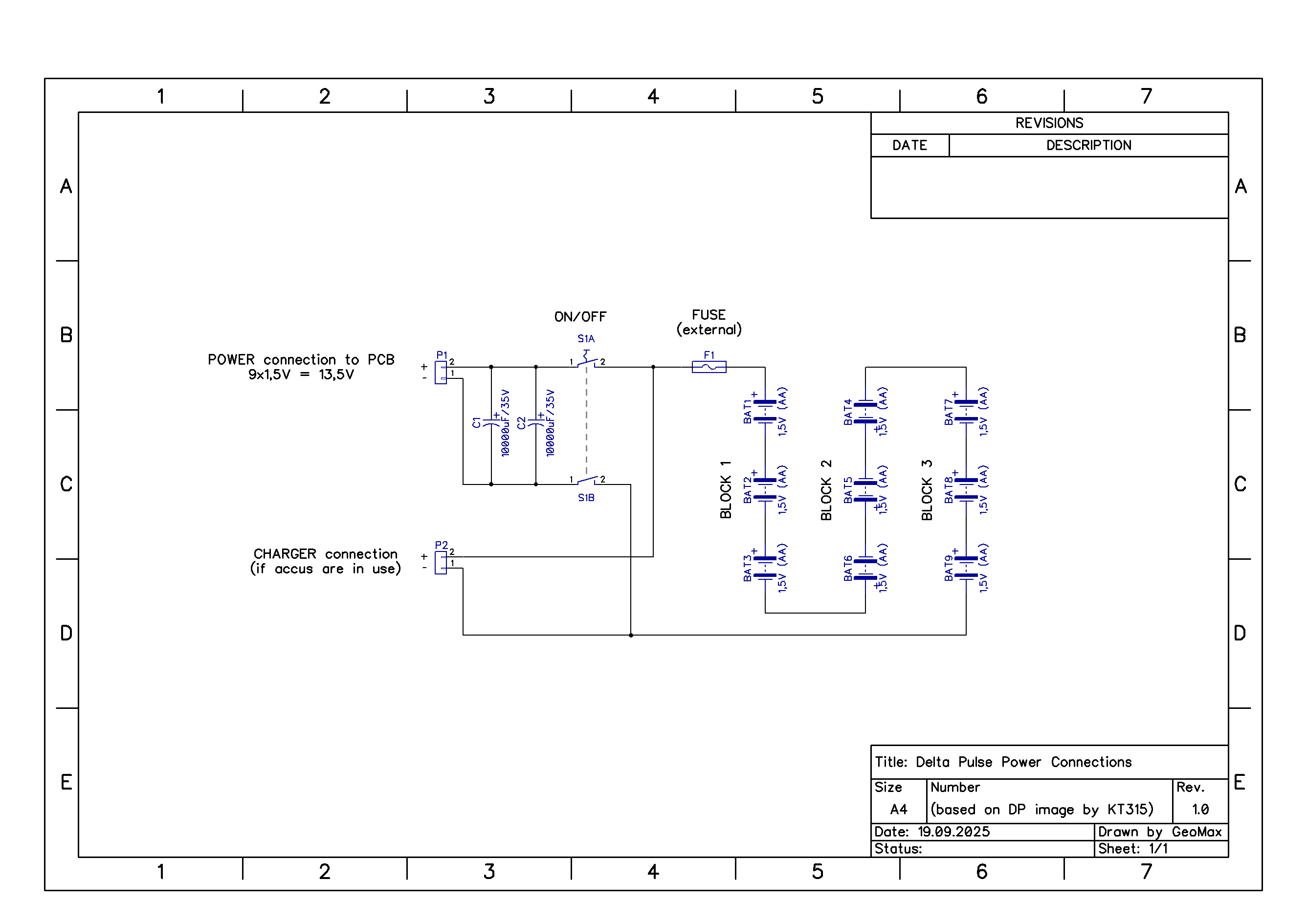

                  Hi Infamy​
                  The wiring of the batteries/accus with on/off switch, fuse and battery charging socket should look like the circuit below.

                    Hi Infamy​
                    Thanks that looks straight forward any idea for fuse value?
                    I guess the reason for the large caps is to reduce noise if that is the case the quality audio caps I have be a good fit as I understand they are designed to be smooth.
                    The value of 35v for the caps is that calculated or a guessetimate?
                    I ask because I know if you do not have the exact value you go up and never down. But is there a point where going up in voltage creates problems.
                    My caps are 71v I don't know enough to know if that is bad and I never found answer to the when I change caps on CD players.

                            This value is approximate, but 25V capacitors would also be acceptable. I usually use twice the power supply's battery voltage as a guideline for capacitors in the power supply (2 x 13.5V = 27V, the closest standard value would be 35V). If your caps have 71V is also okay.
                              Hi Infamy​
                              Click image for larger version  Name:	Delta Pulse Power Connections.png Views:	0 Size:	50.4 KB ID:	440988

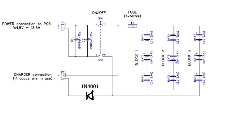

                              ideal just add a diode, polarity protection. it is in a shrink tube. Click image for larger version  Name:	dp.jpg Views:	0 Size:	33.6 KB ID:	441007
                                Hi KT315,
                                thanks. Here's an update with the diode...
