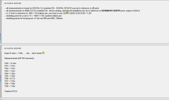

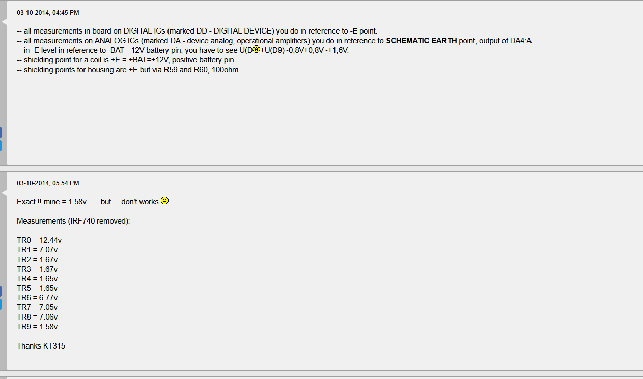

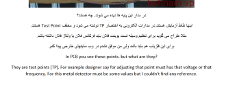

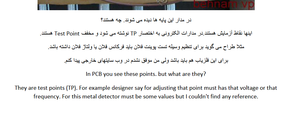

      Click image for larger version  Name:	Test Points.png Views:	0 Size:	59.1 KB ID:	441347
      "In PCB you see these points. but what are they?
      They are test points (TP). For example designer say for adjusting that point must has that voltage or that
      frequency. For this metal detector must be some values but I couldn't find any reference.​"
      This the only information I have found on the test points.
      Click image for larger version  Name:	Voltage Values.png Views:	0 Size:	39.4 KB ID:	441346

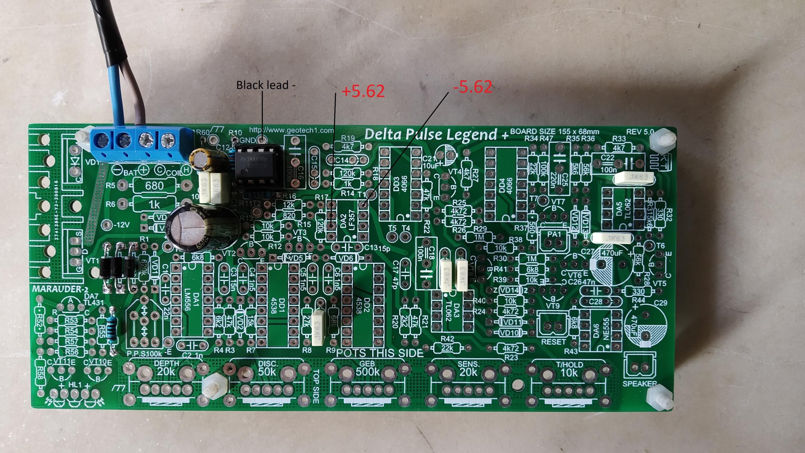

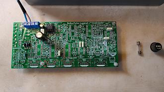

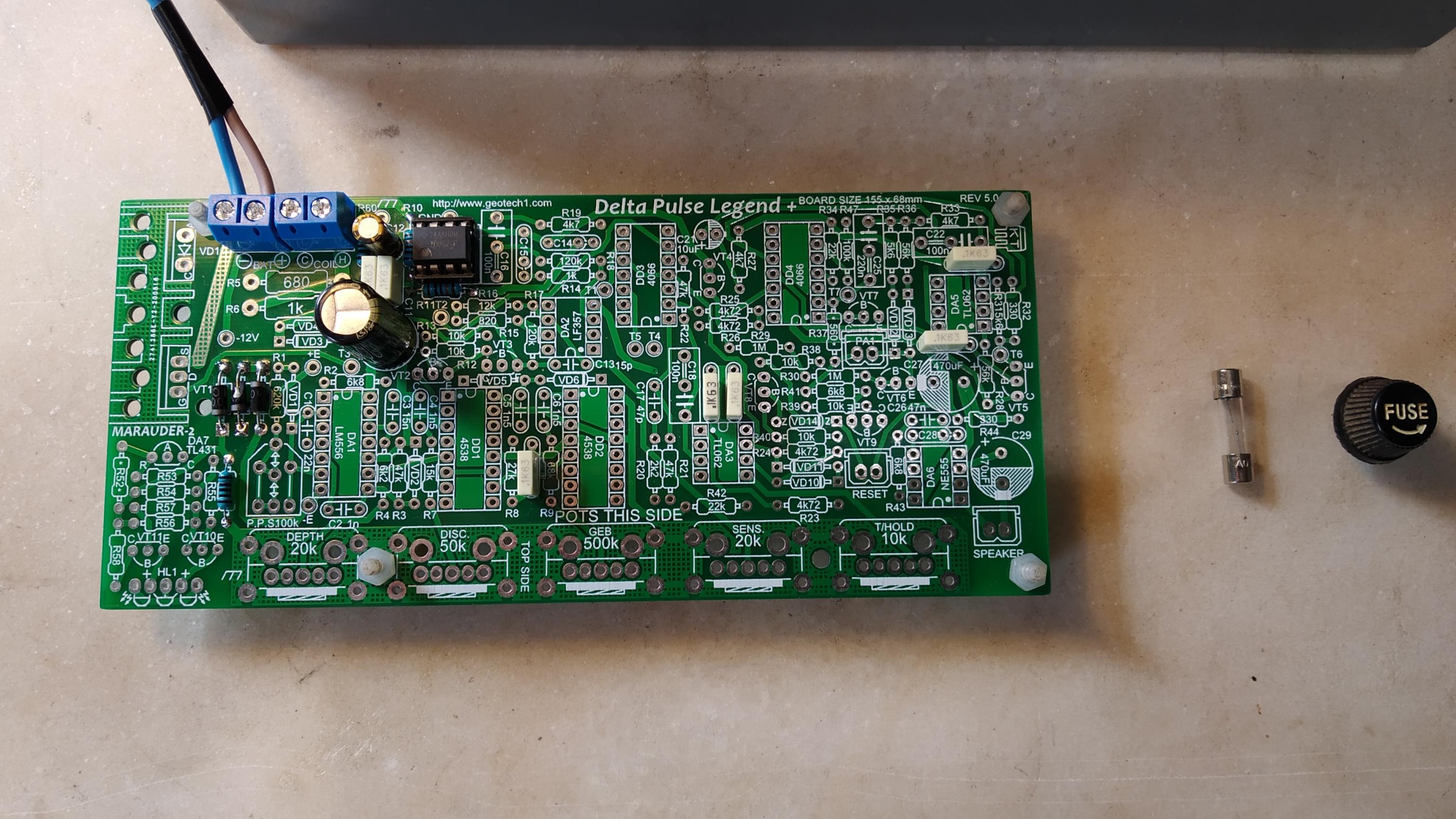

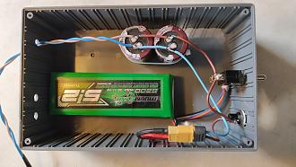

      Stage 1 Test with battery connected
      Click image for larger version  Name:	IMG_20250928_152752.jpg Views:	0 Size:	552.1 KB ID:	441348 Click image for larger version  Name:	IMG_20250928_152737.jpg Views:	0 Size:	633.1 KB ID:	441349
      Well VD9 exploded VD8 was dead and I changed VD7 although it checked out OK. C23 was changed for a better value it was out by 10%.
      C43 22uf cap SMD on the back was dead it was the one the wrong way round, change all other SMDs even though they had good values.
      Tested again, nothing blew up but as for values unable to say if all is working properly as I don't know what values I should have besides approximately 12v values.
      LF357 gives reading but what should they be and on which legs?
      Will look at the TP list of values today to see if that reveals anything.
      Soldering, resoldering on this board is not easy as the holes operate as if they have two doors of solder on either side of the board.
      Best method I found for clearing the holes was to use a bread board connection wire that has a strong pin.
      Heat solder, press in pin, heat solder on other side then rotate pin through this cleans the hole.
      Used a 3.5amp glass fuse in the power supply, that seems to have passed stage one testing.
      PS if it were only politics.
      Its Survival.

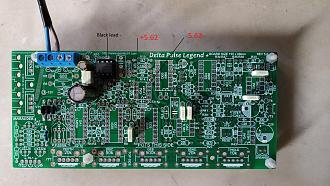

        Stage 1 test at 3 minutes, values on LF357 legs 4 and 7.
        Using the PI Polones as I guide I have the following results.
        Click image for larger version  Name:	Stage 1 Test.jpg Views:	0 Size:	606.5 KB ID:	441353
        • #64

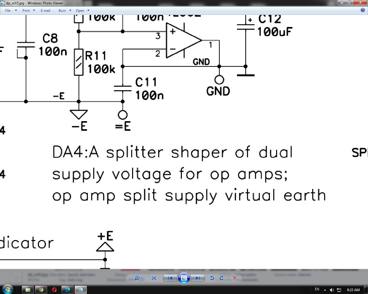

          good. on the splitter opamp output you have sure half voltage. but you measure in relation to the output, GND, it is -half and +half.
          5.62 + 5,62 = 11,24
          11,24 + 0.8 + 0.8 (VD8 VD9 diodes in the circuit) = 12.8V, your battery voltage.
          the schematic has full description in every its parts. you have to read.

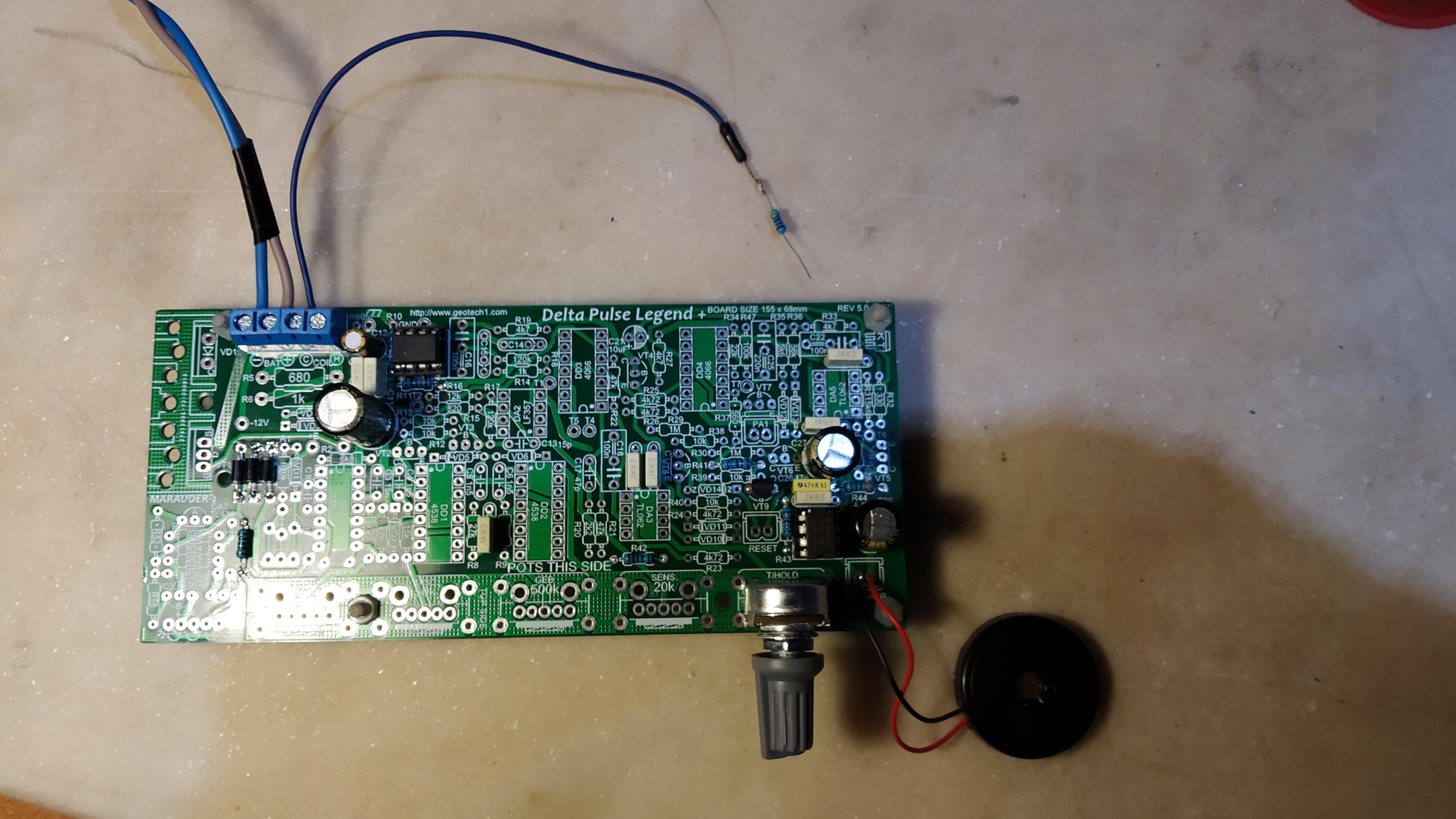

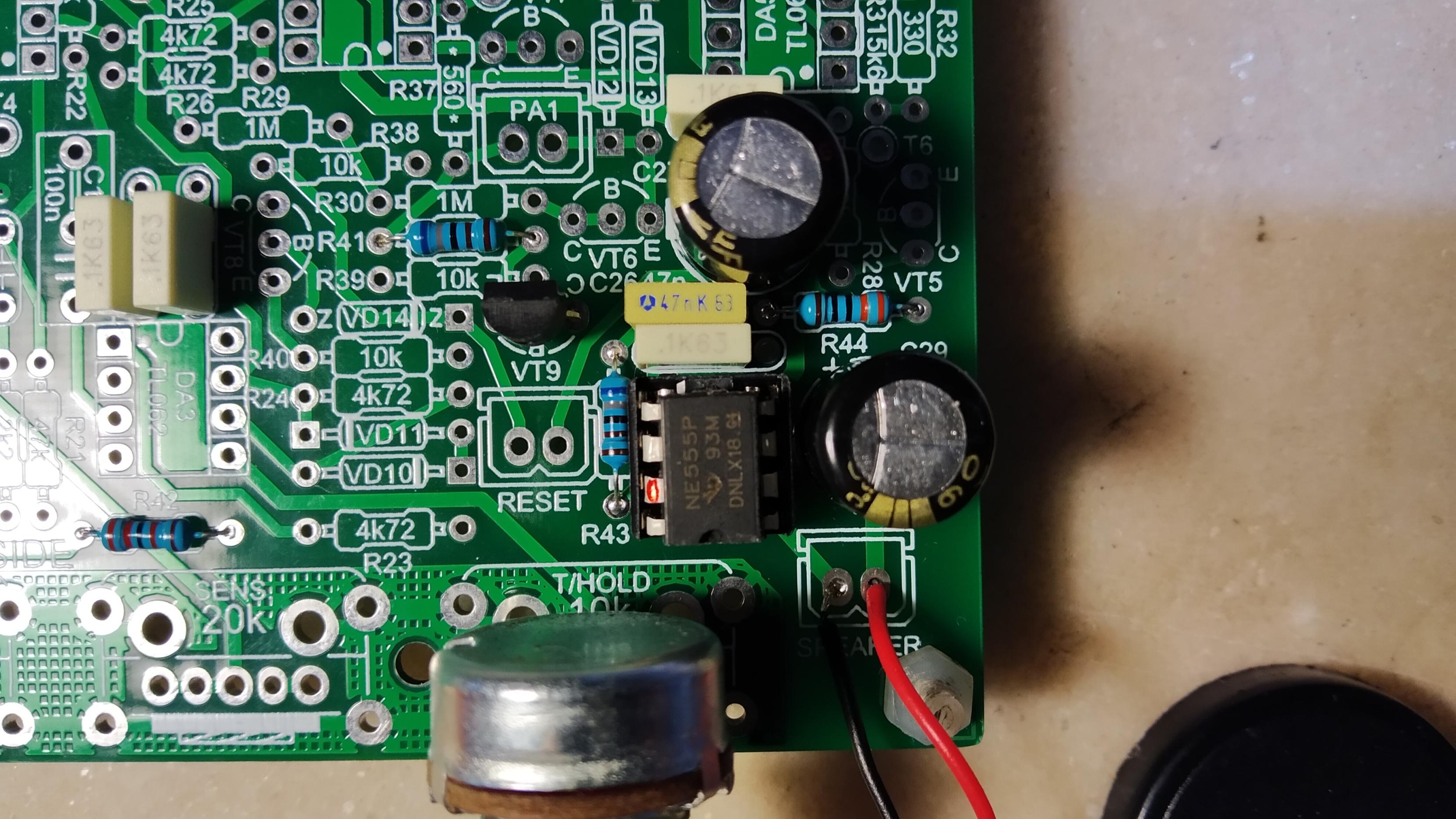

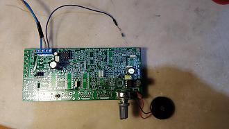

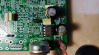

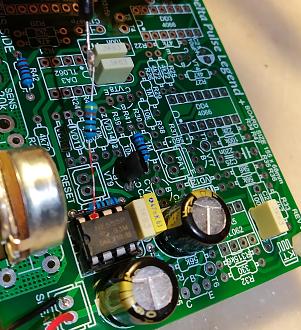

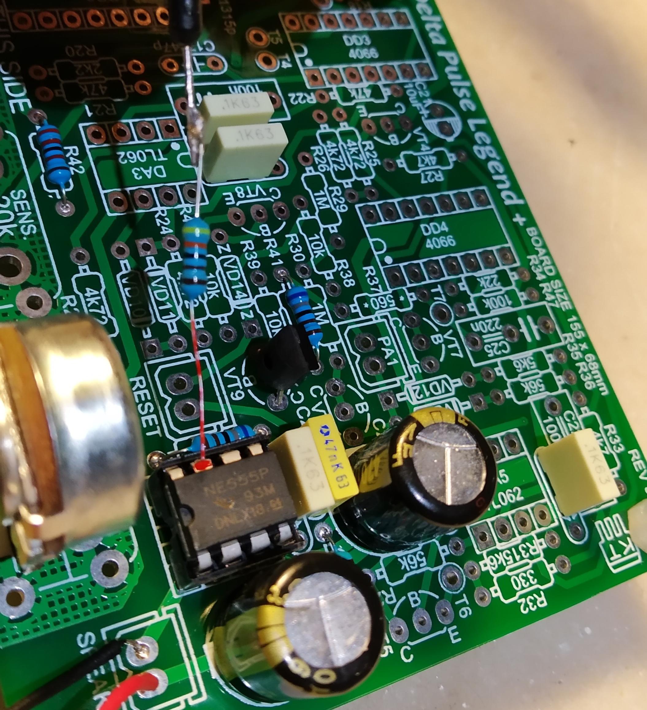

            Delta Pulse PI metal detector. 1 stage. Sound checking. Проверка звука.
            This is stage 2 in my build, Sound Test, passed.
            I used 3.7k resistor.
            Click image for larger version  Name:	IMG_20251003_202102.jpg Views:	0 Size:	564.4 KB ID:	441381 Click image for larger version  Name:	IMG_20251003_202153.jpg Views:	0 Size:	602.9 KB ID:	441382 Click image for larger version  Name:	IMG_20251003_202308.jpg Views:	0 Size:	549.2 KB ID:	441383

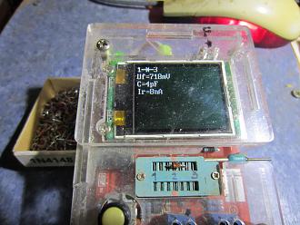

            PS where do the 0.8 values come from?
            Is this diode loss?
            If so its more like 0.6

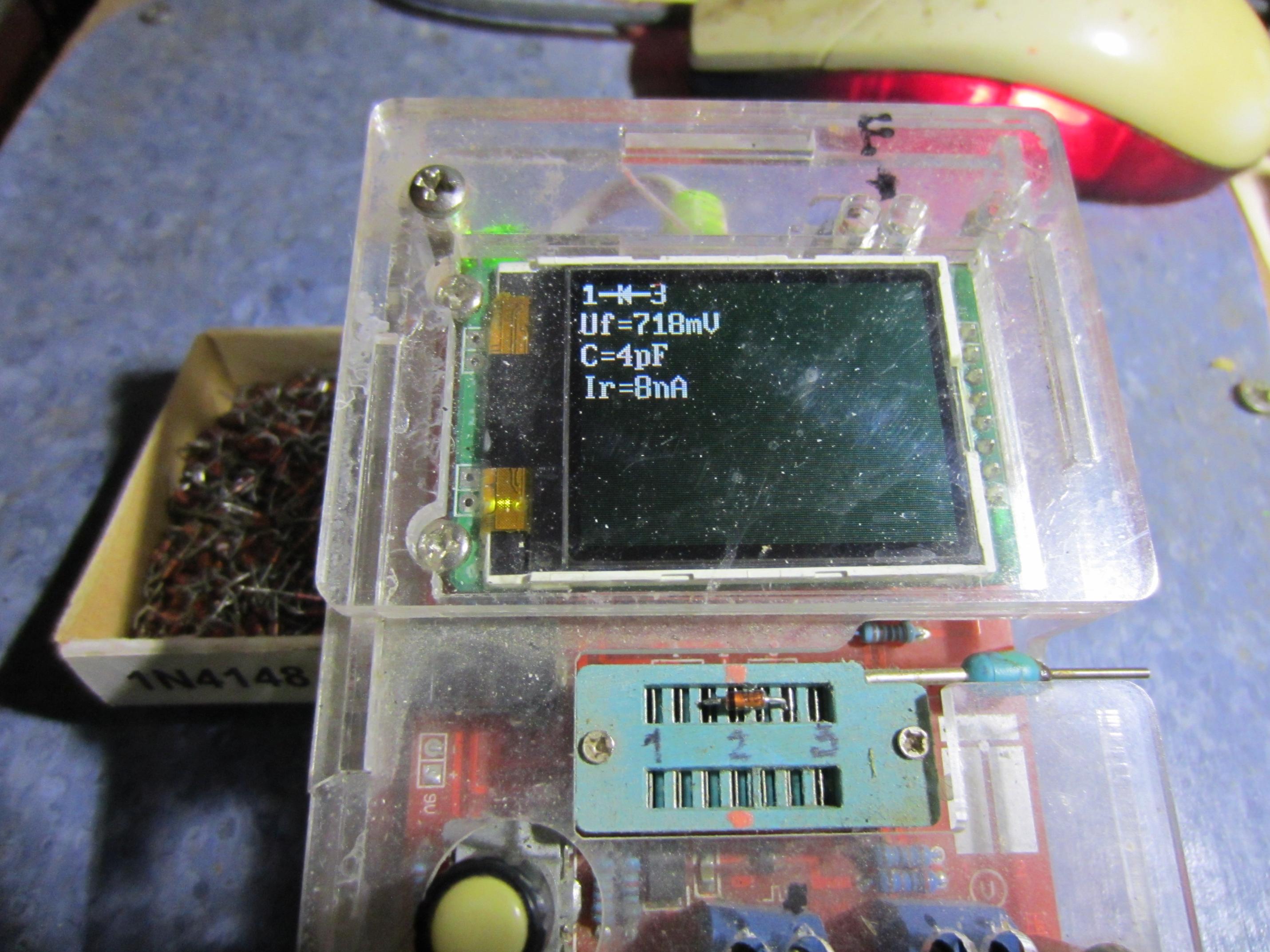

                i show on 1N4148, but 1N4001 is same. take a diode and put it in your tester. you see REAL direct voltage on the diode.
                A specific diode's VF depends on what semiconductor material it's made out of. Typically, a silicon diode will have a VF around 0.6-1V. A germanium-based diode might be lower, around 0.3V. The type of diode also has some importance in defining the forward voltage drop; light-emitting diodes can have a much larger VF, while Schottky diodes are designed specifically to have a much lower-than-usual forward voltage.
                Click image for larger version  Name:	IMG_2034[1].jpg Views:	0 Size:	539.0 KB ID:	441386

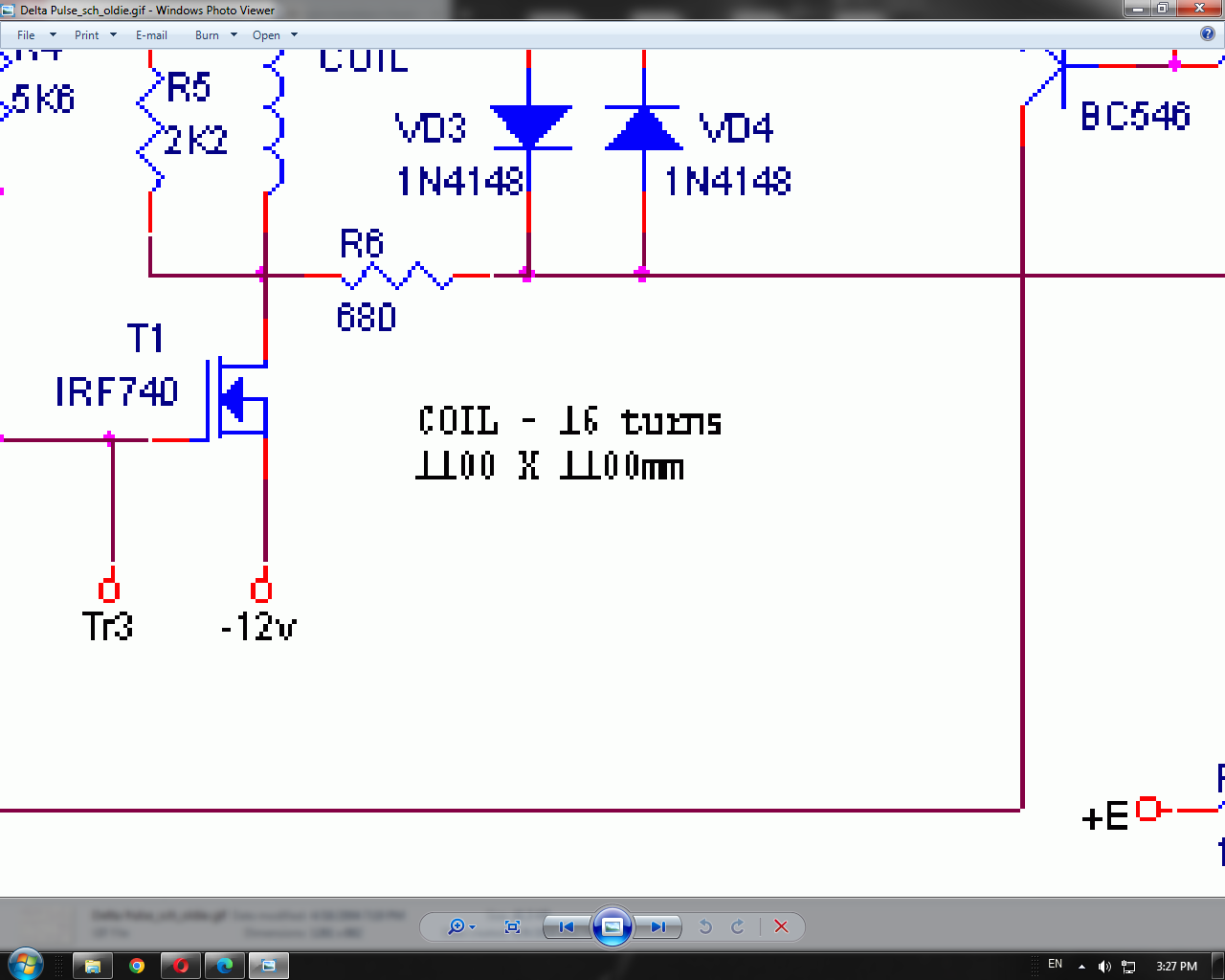

                            • #74
                              data on coil is on schematic. no another data, not exists. some Russians speak 500-550uH is good for DP. do not know. Bulgarians did not share this info.
                              you can use a 330uH+ coil.
                              uH everywhere is MICRO-HENRY.
                              Click image for larger version  Name:	image.png Views:	0 Size:	74.4 KB ID:	441544
