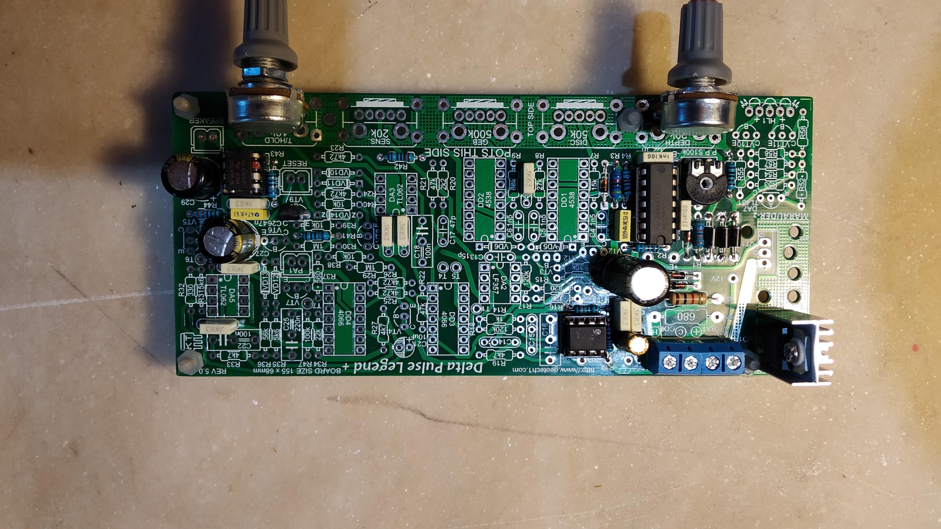

    So the first image is my board with stage three complete minus IRF840 and Resistor 680.

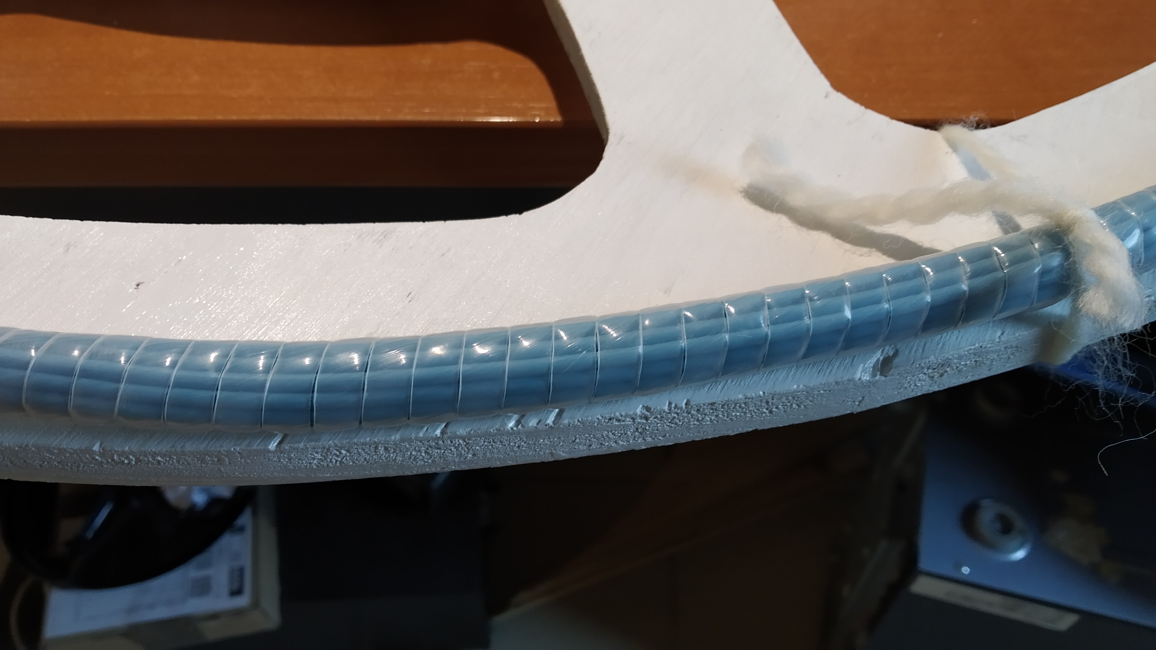

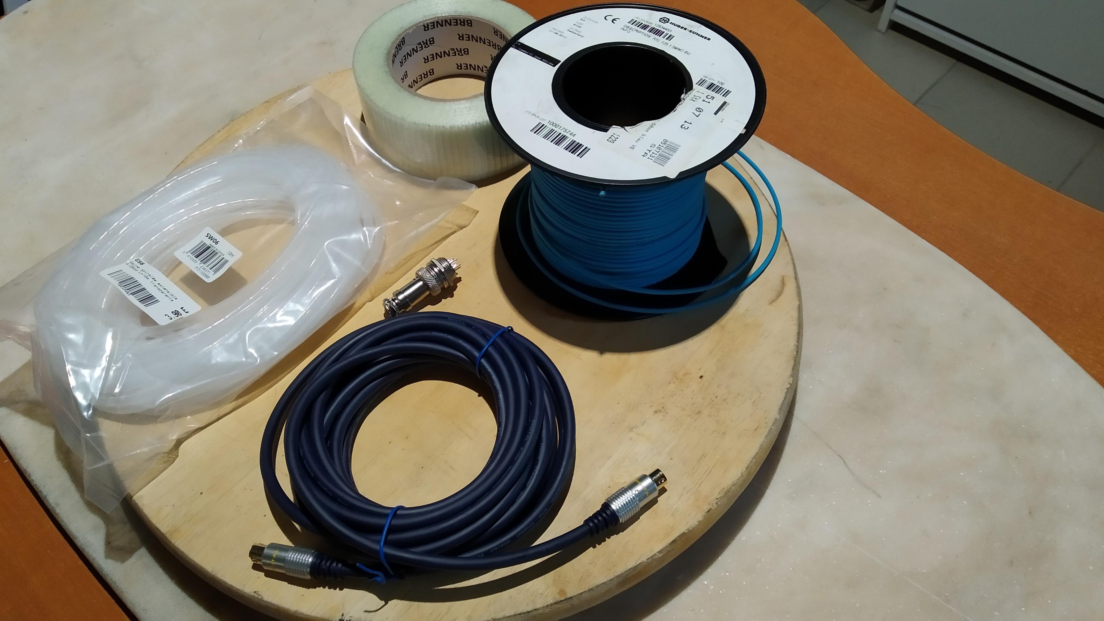

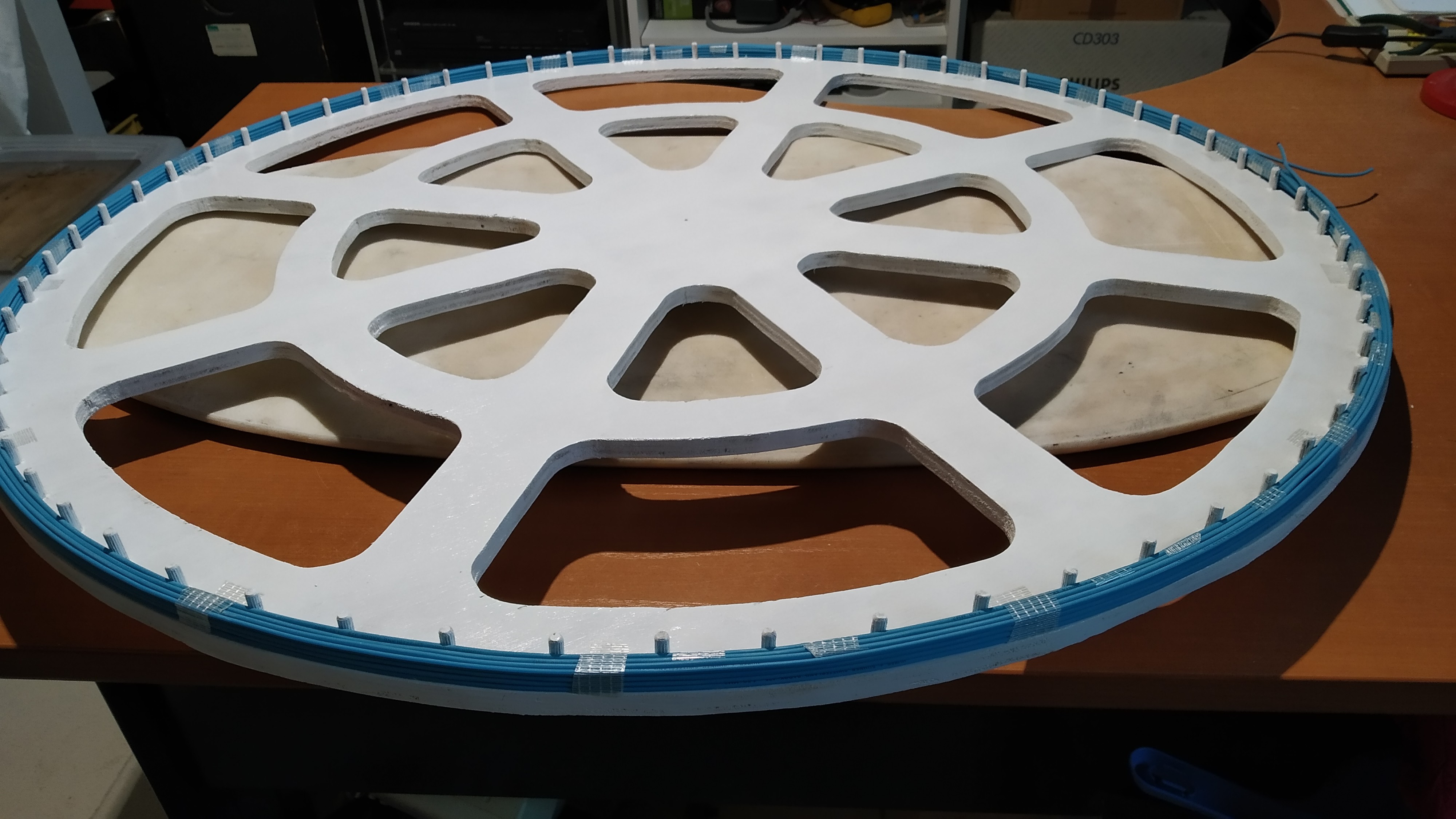

    Image 2 are the materials used to build my first coil, a 36 inch mono. The board underneath rotates, it's for the wire.
    Image 3 & 4 is the coil built with 4 rows 4 columns of wire 16 turns target inductance 750 uH.
    The dowel pegs that held the coil in place will be knocked out and the coil will be tied down with zip ties using the dowel peg holes
    I used tape to keep the wires in place. Using the spiral wrap was interesting. To achieve the tightest packing of the wires the tape need to be removed as I progressed
    so the wires could move and I had to stop fighting the wrap & and let the wires move naturally to find the best fit. The length of spiral wrap used was 10m. I had a bit left over, but not much.
    I used a an LCR Meter DE-5000 to measure inductance and resistance.
    Inductance LS = 731 uH with the spiral wrap. Next stage will be to wrapped with a water resistant tape, readings will change a bit, we will see.
    Resistance DCR = 0.6 ​Ω

        The paint on the spider web coil support is to protect the plywood base from water splashes. Eventually it will
        be sprayed black with a white outer edge, partly stealth partly cooling.

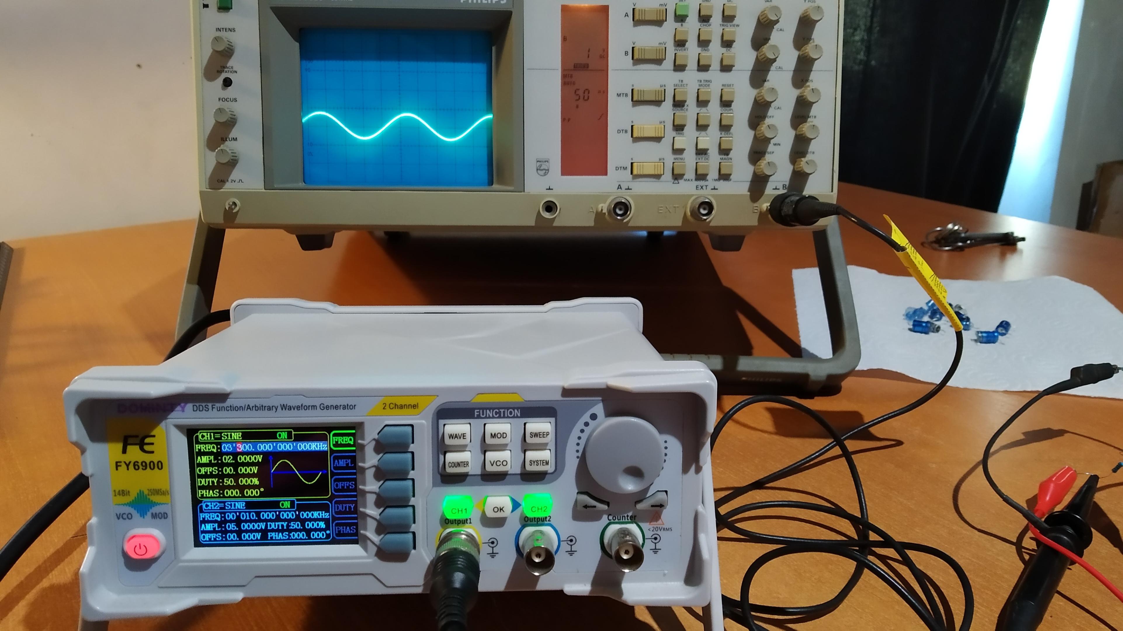

        So its just a signal generator Carl!
        Can you give a clear explanation of how this is done.
        All examples I have found using a signal generator also have a an oscilloscope attached.
        I tried using just a signal generator counter but no dice.
        On the 'Surf Detector' video using just oscope I could not see a resistor in play, is it necessary?
        OK so in the ITMD 3rd edition diagram there needs to be two cables from the signal generator on the left.
        The first cable is output and the frequency is changed until the second cable which is input, (cable dc input) shows
        an unstable frequency when you press counter.
        20.4 MHz is where it collapses on this coil, does that look like its in the ball park?

          Sorry, sig gen + oscope. Per the drawing in Fig 8.3, you use an oscope to measure the coil signal and vary the frequency until you get a peak. You can also reverse the position of the coil and resistor (as in Fig 8.2), then use the oscope to measure the resistor signal and vary the frequency until you find the null trough. I find the peak measurement to be easier.
          The Surf video uses coil ringing to measure SRF. For this you need an active PI transmitter with no damping resistor. The coil will ring and you just measure the ringing frequency. This is mentioned in the last paragraph of 8.1.1 and illustrated in Fig 19.11.
          I expect 20.4 MHz is way too high. I would expect below 1MHz.

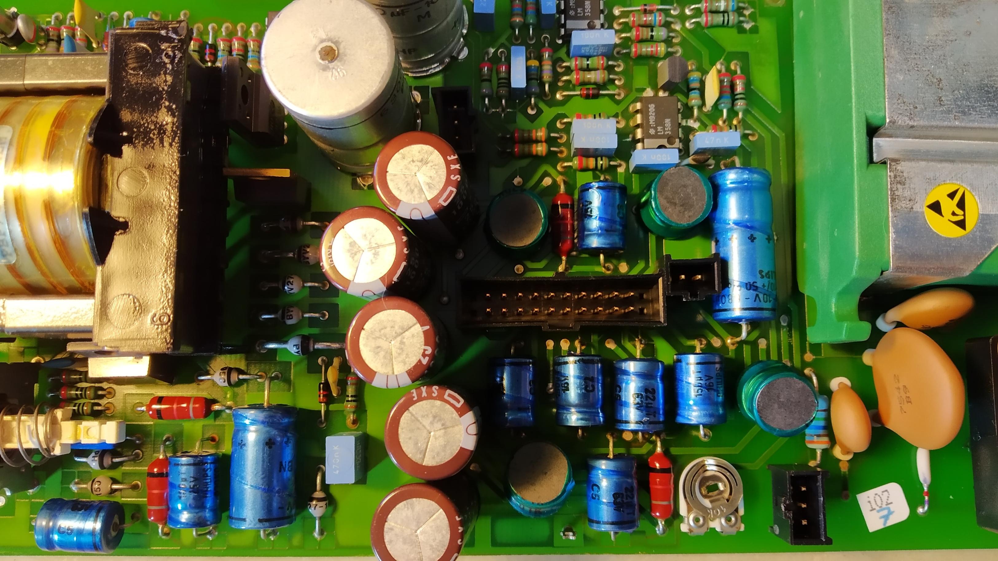

            Decided to get out the oscilloscope and check this, o'dear what I dreaded, 5 years not used.
            Power supply caps probably need changing as it did not coming out to play.
            That was the Philips PM3055 60MHz full of blue Philips caps, the worst type of cap I came across when repairing CD players.
            I have an Hitachi V525 50MHz I picked up not working, I guess now is a good time to fix them both.

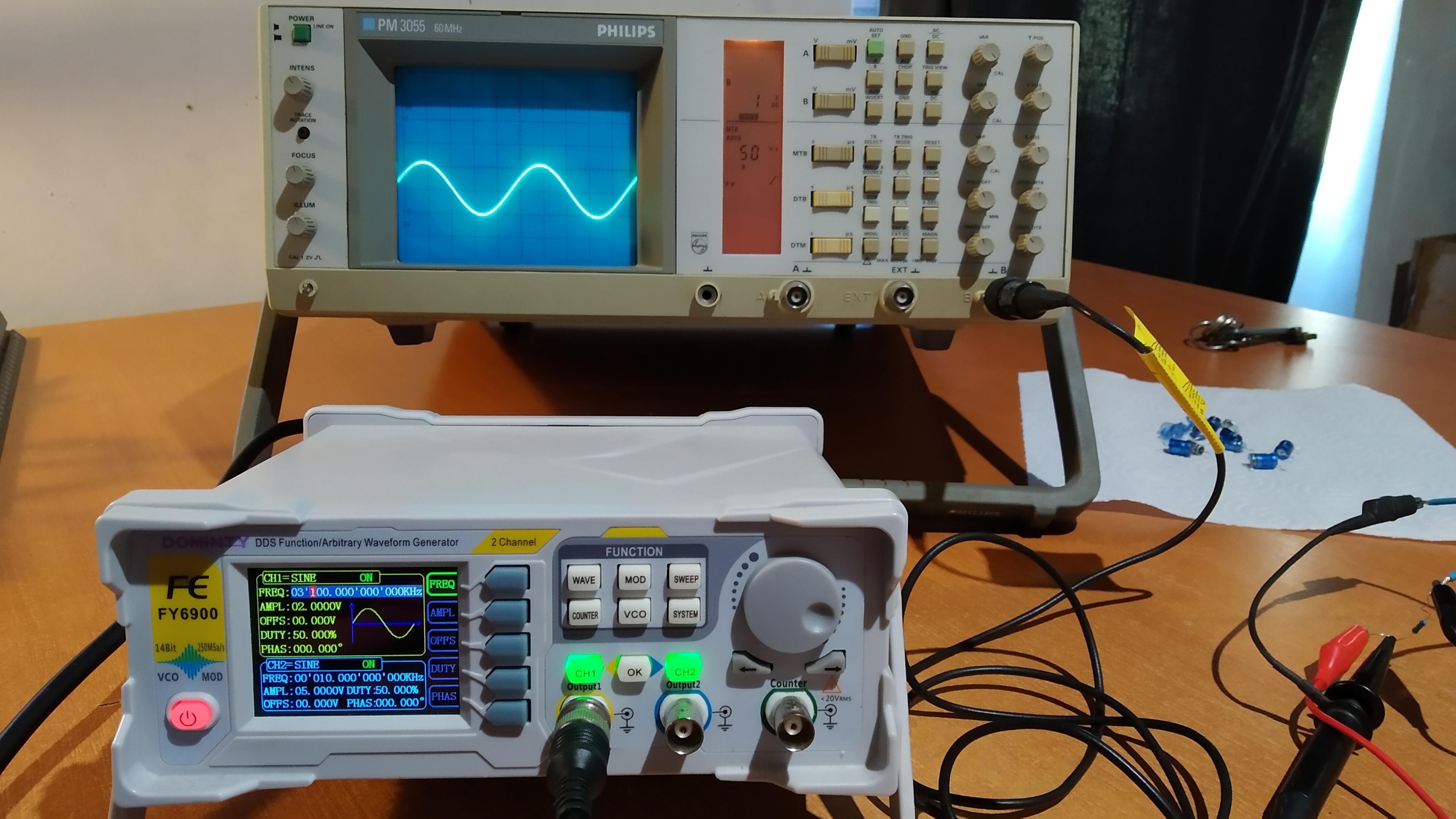

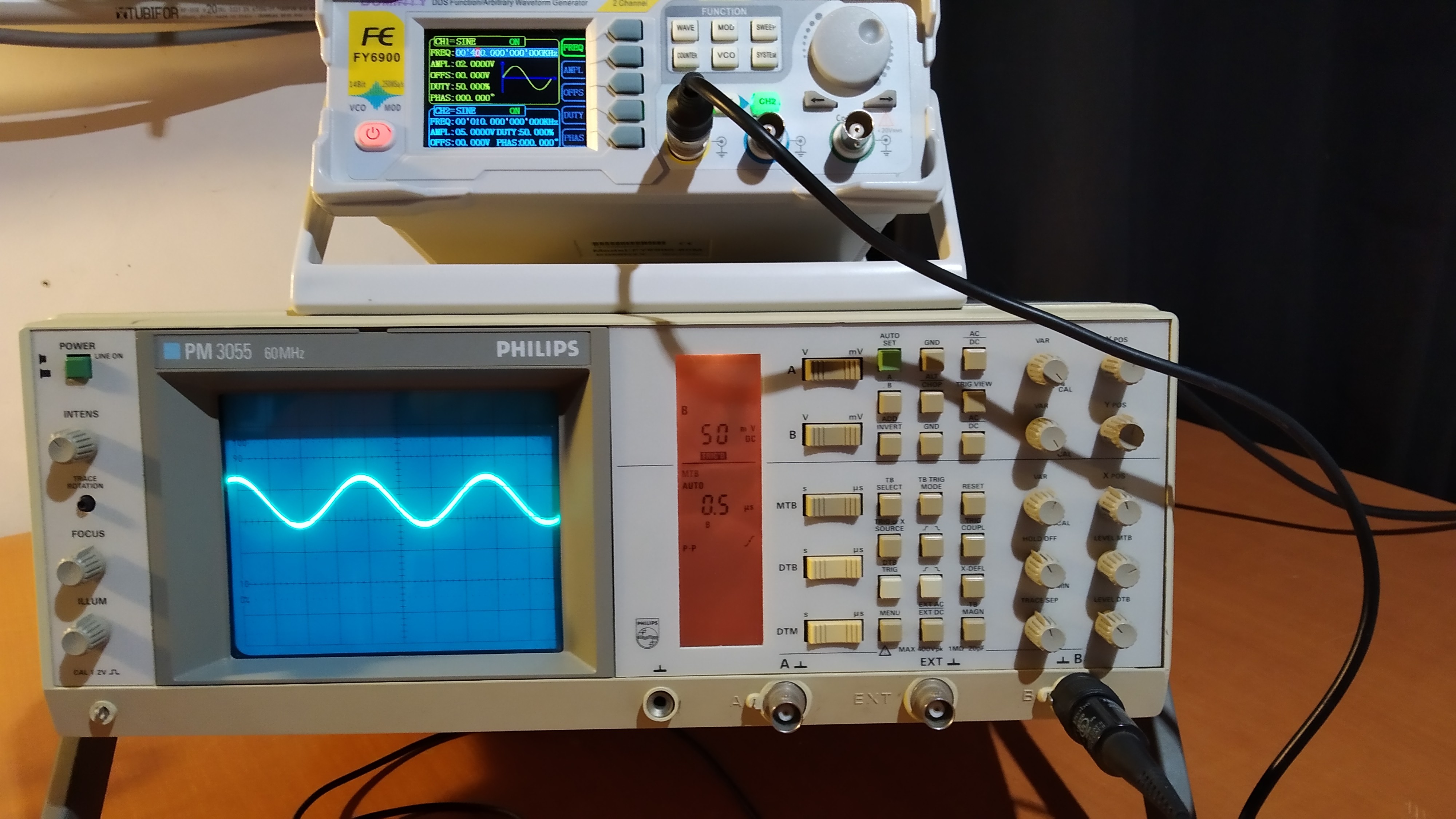

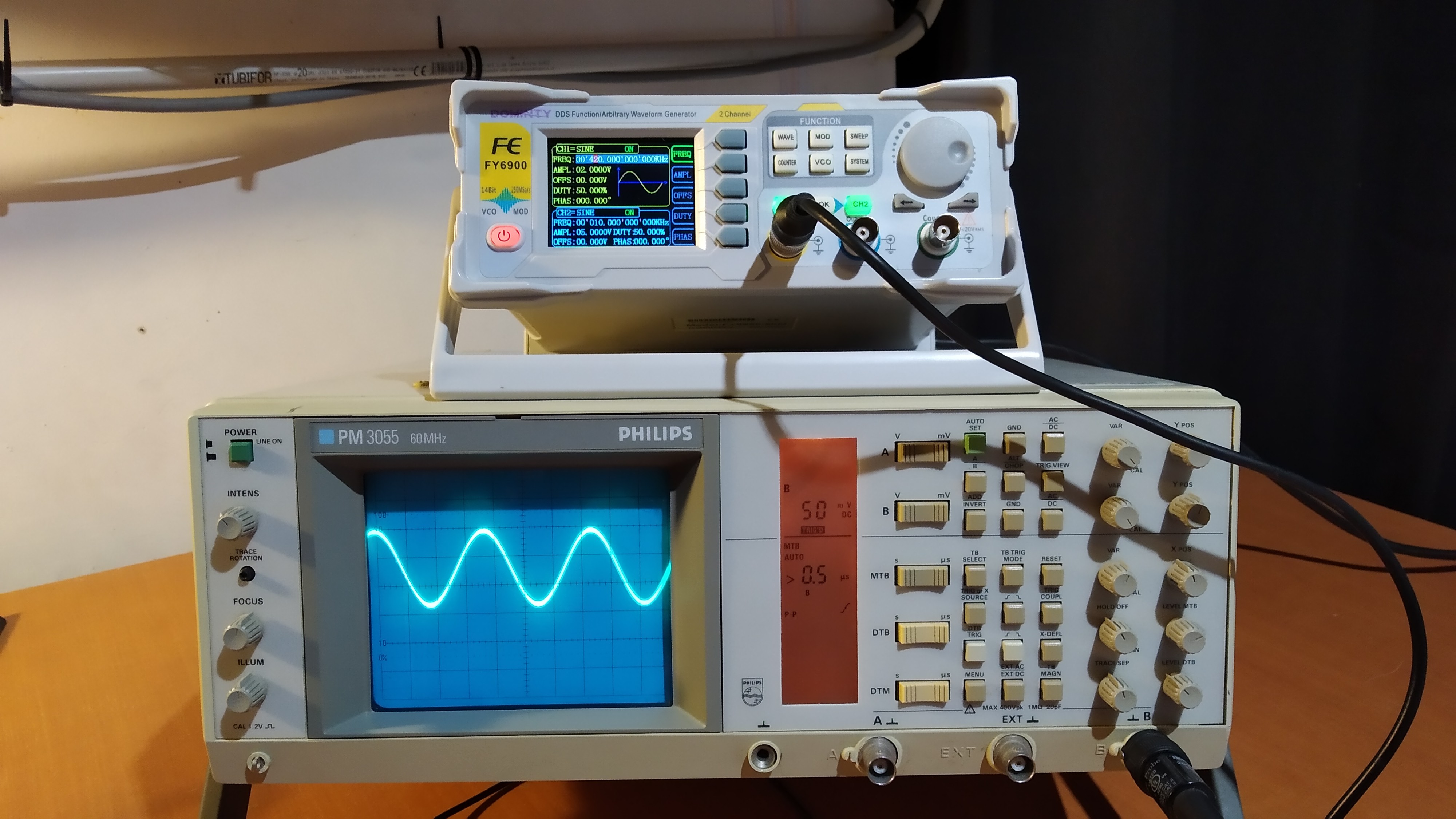

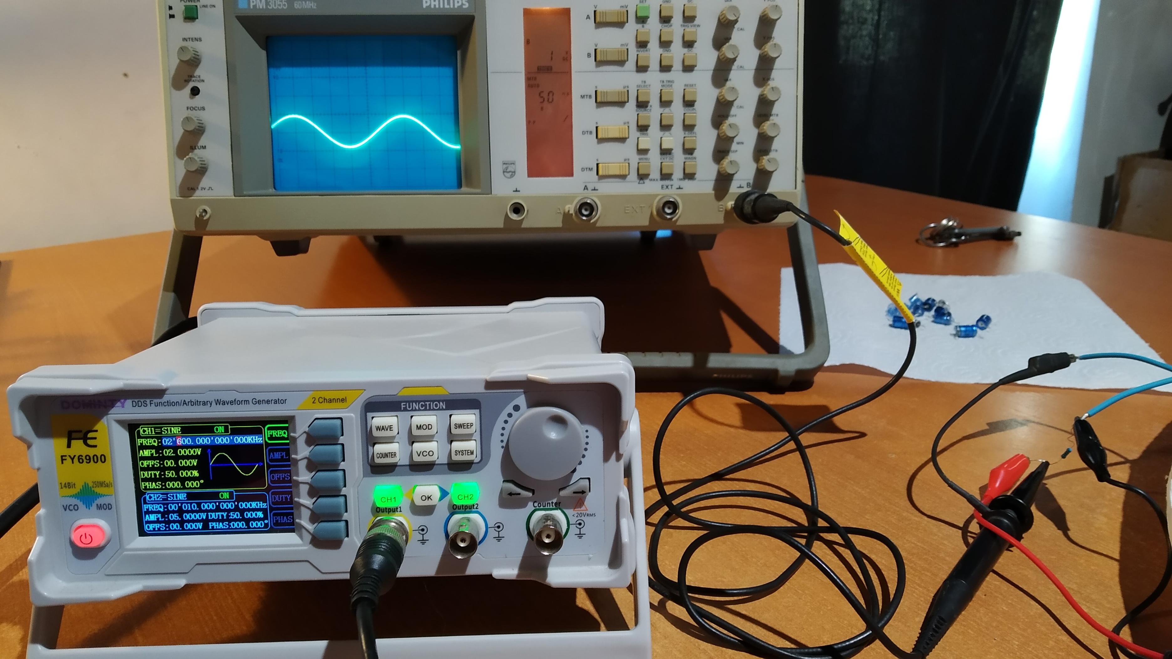

              Click image for larger version  Name:	IMG_20251027_083933.jpg Views:	0 Size:	560.3 KB ID:	442014 Click image for larger version  Name:	IMG_20251027_083953.jpg Views:	0 Size:	553.0 KB ID:	442015 Click image for larger version  Name:	IMG_20251027_084015.jpg Views:	0 Size:	553.0 KB ID:	442016
              This my setup for finding the SRF of the coil showing the collapse of the sine wave.
              Image 1 is 2.6 MHz Rise
              Image 2 is 3.1 MHz Apex SRF
              Image 3 is 3.3 MHz Fall

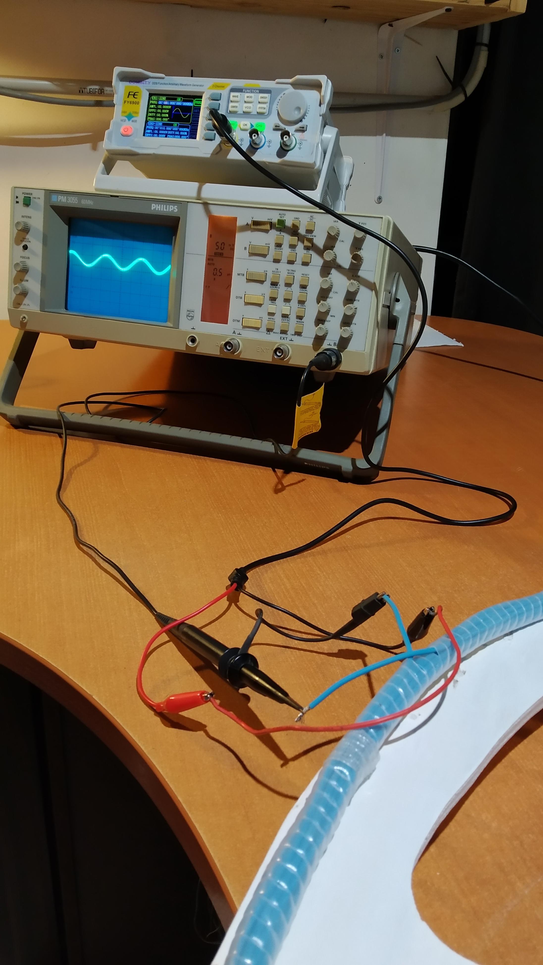

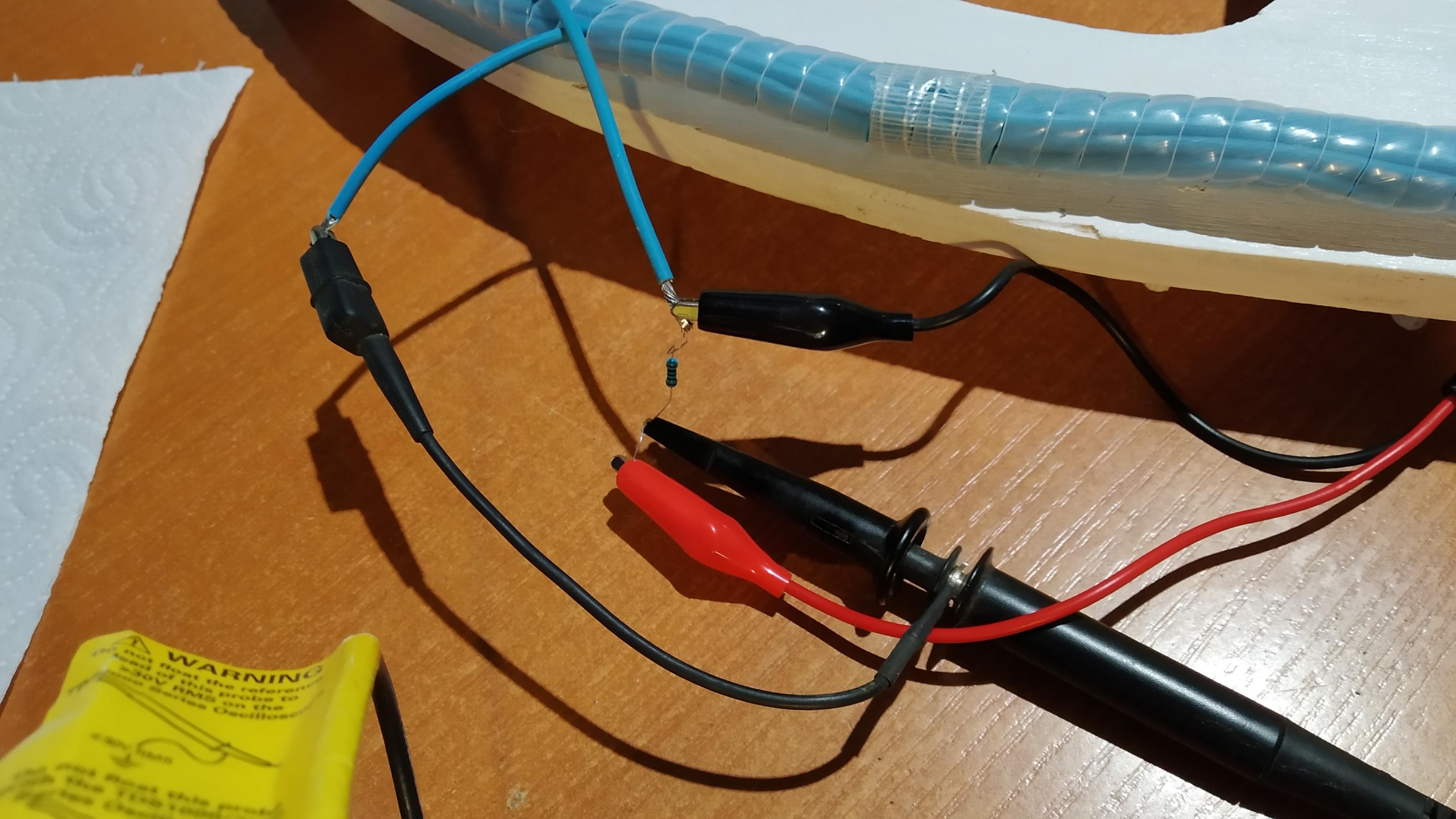

              Click image for larger version  Name:	IMG_20251027_084037.jpg Views:	0 Size:	548.8 KB ID:	442017 Click image for larger version  Name:	IMG_20251025_112924.jpg Views:	0 Size:	617.2 KB ID:	442018
              Image 4 is how the cables are connected, the resistor is 100 ohm.

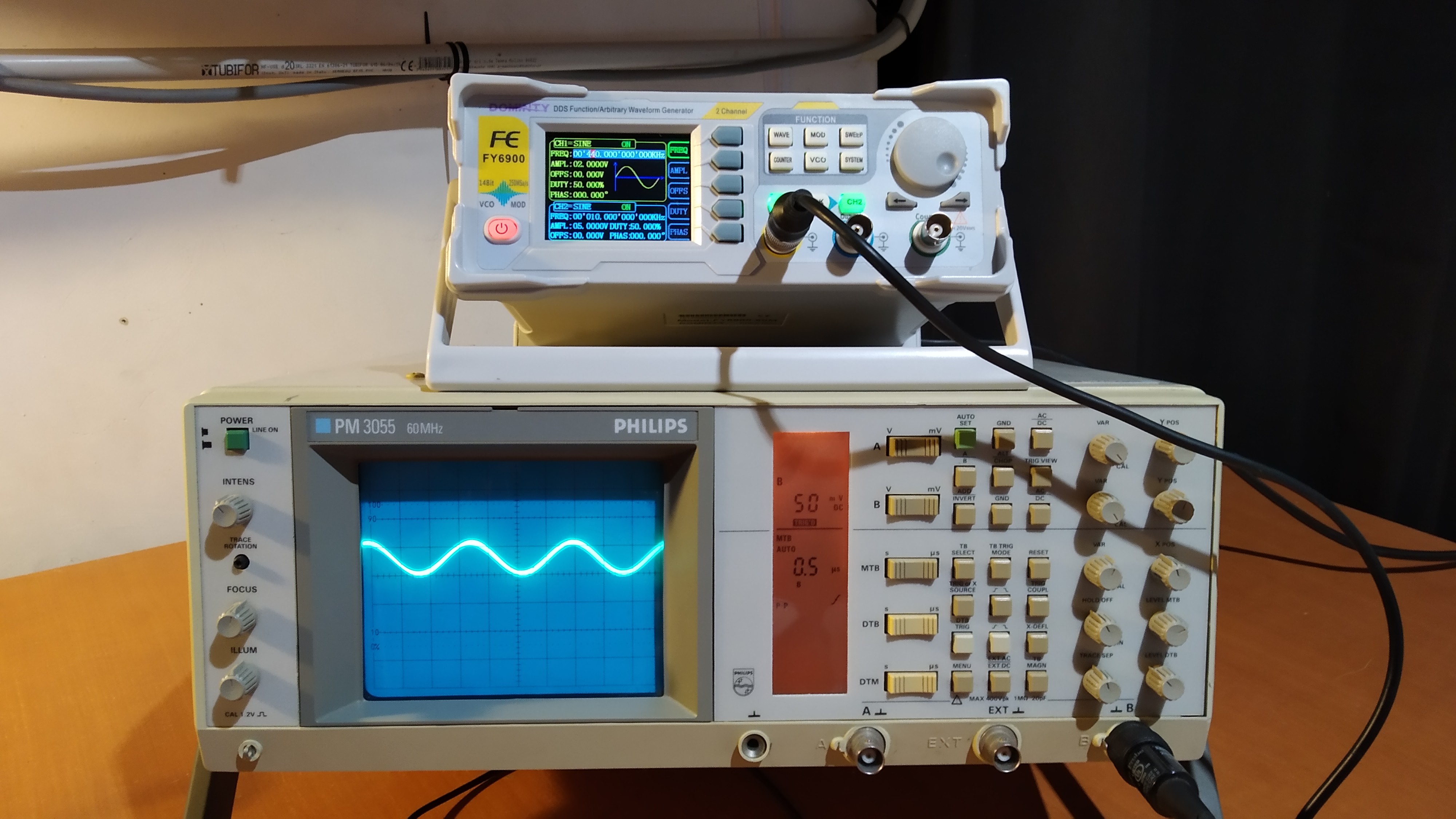

              Image 5 is the power supply board of the Oscilloscope I had to repair, full of lovely philips blue low value caps.
              The paper in the background of images 1-3 have the six bad blues also replaced 1 of the 2200 uf browns.
              Channel 1 is not as it should be out by x10 which is odd, means when probe is set to x10 you don't need to make any
              adjustments. Any suggestions as to whats going on?

              • #82

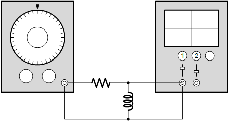

                Your connections are not correct. This is what you have:
                Also, depending on how the sig gen and oscope are designed, they may have an inherently shared ground (dashed line) through the AC power ground.

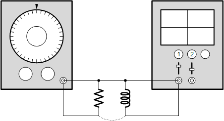

                This is what you want:
                Also, use the 10x probe setting to minimize the probe's capacitance on the measurement. If you look at Table 8-1 in ITMD3 you will see the measured SRF for some ~1mH coils. None of them are even close to 3MHz so you should immediately question your result. The best scramble-wound coil (Teflon) is 667kHz which yields a self-C of 60pF. Expect an SRF of 500-1000 kHz and a self-C of 50-150pF.

                  Their measuring setup is wrong.
                  In the last example by Carl I isolated the function generator and ran it off a battery, it was the only way to
                  achieve results which were reliable?, meeting the error criteria for x1 and x10 probe measurements 30-100kHz
                  from page 8 of 'Making a Fast PI Mono Coil' by bbsailor.
                  & close to the predicted value of 760 kHz from post #80.
                  What I had on my scope was a sine wave 2 volts peak to peak which drop slowly when SRF is reach?
                  I assume the point of change is the SRF but this does seem odd to me.
                  I expected a rise and fall, not just a fall.
                  This is a bit of a pigs ear as I still don't know if this is correct.
                  Averaging it out I have 693 kHz off a spread fall of 675-710 kHz.
