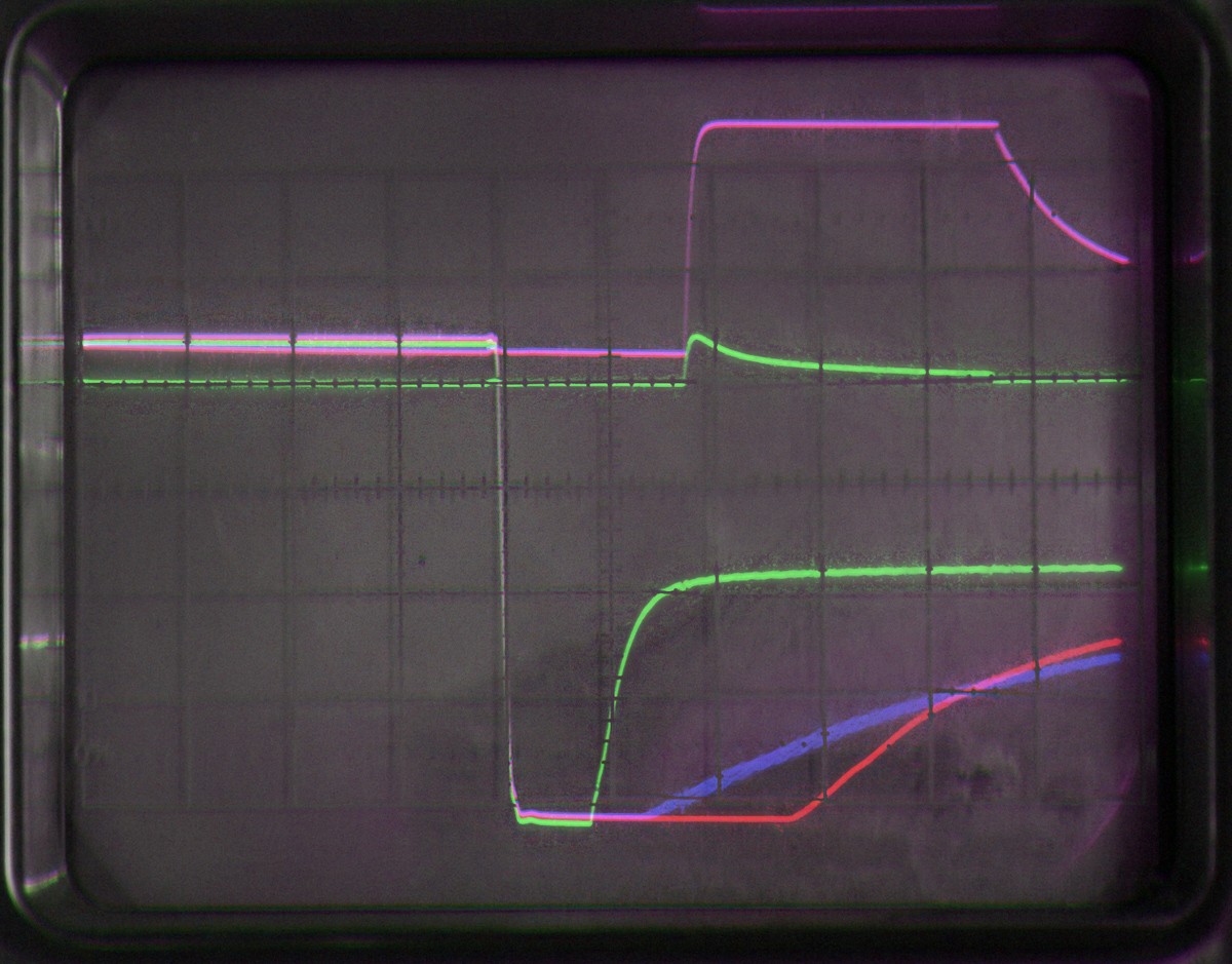

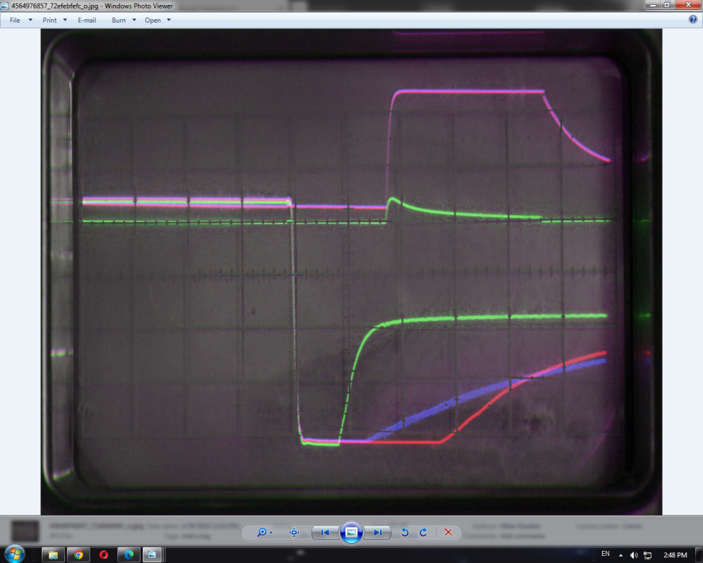

                  • #54
                    T2 and T3 are not for overload protection, they clamp the RC reset on D2A so that the timing delay begins when the preamp comes out of saturation, no matter what is loading the coil. I think there is something wrong, either with the transistors or with the RC.
                    i told how this part works many times. on a target T2 and T3 are turn off, no reaction. just on BIG target or a target near coil - OVERLOADING - when 'delta pulse'
                    has smoothed plot, T3 begins turn up, opens (by negative level of the Delta Pulse). T2 also opens - far "they clamp the RC reset on D2A so that the timing delay begins when the preamp comes out of saturation" - they clamp the RC reset on D2A so FIRST SAMPLE is taken from the right on X axis, via moving to the right, where amplitude of Delta Pulse is more low (blue line on the pic). and yes, D5 comes out of saturation because no overload signal on its input, no overload signal on its output, SAT continues working in normal mode, no influence.
                    it is sure clear for me Overloading Circuit Protection from the saturation and working just fine. it is done FOR NORMAL WORK OF SAT because DP is very sensitive non-motion PI detector.
                    T2 T3 turn off both
                    T2 T3 turn up both

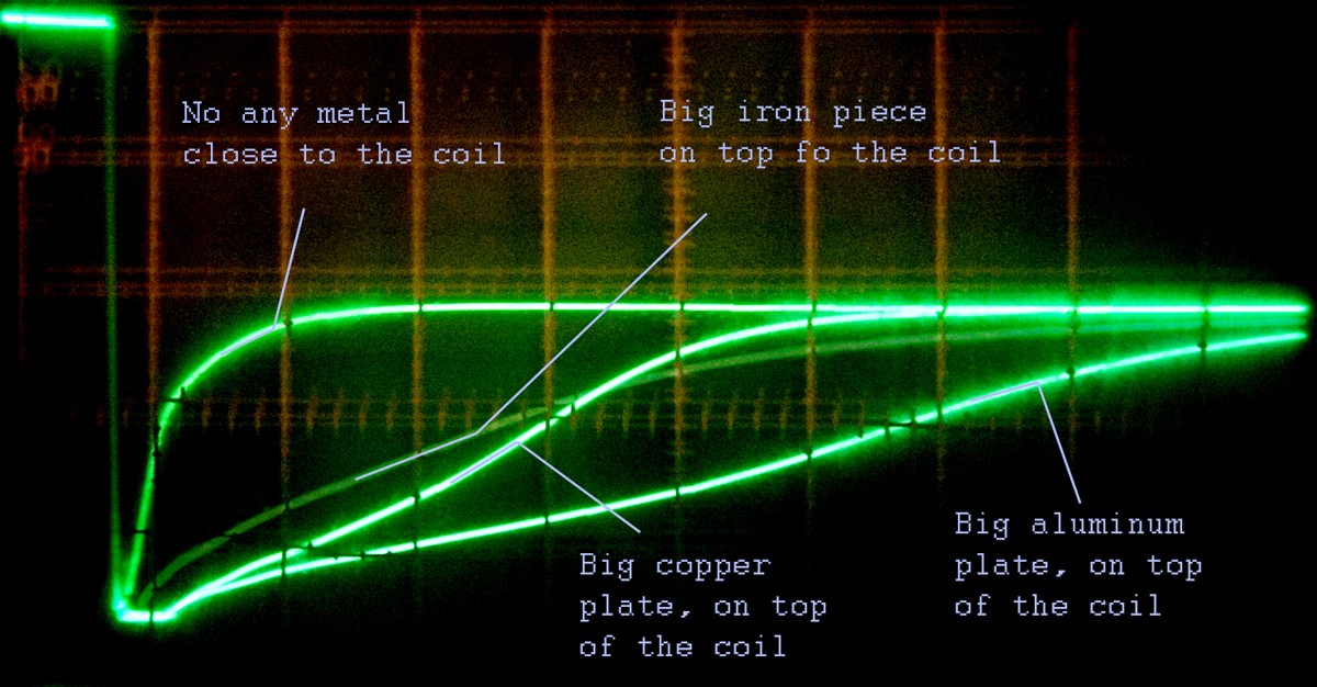

                    • #55
                      Originally posted by Jafar View Post
                      Maybe KT has them — if he or anyone else could kindly send some waveform images, I’d really appreciate it.
                      Karl, just briefly explain the role of each IC in the circuit and the order in which they should operate, so I can have a roadmap for continuing and troubleshooting.

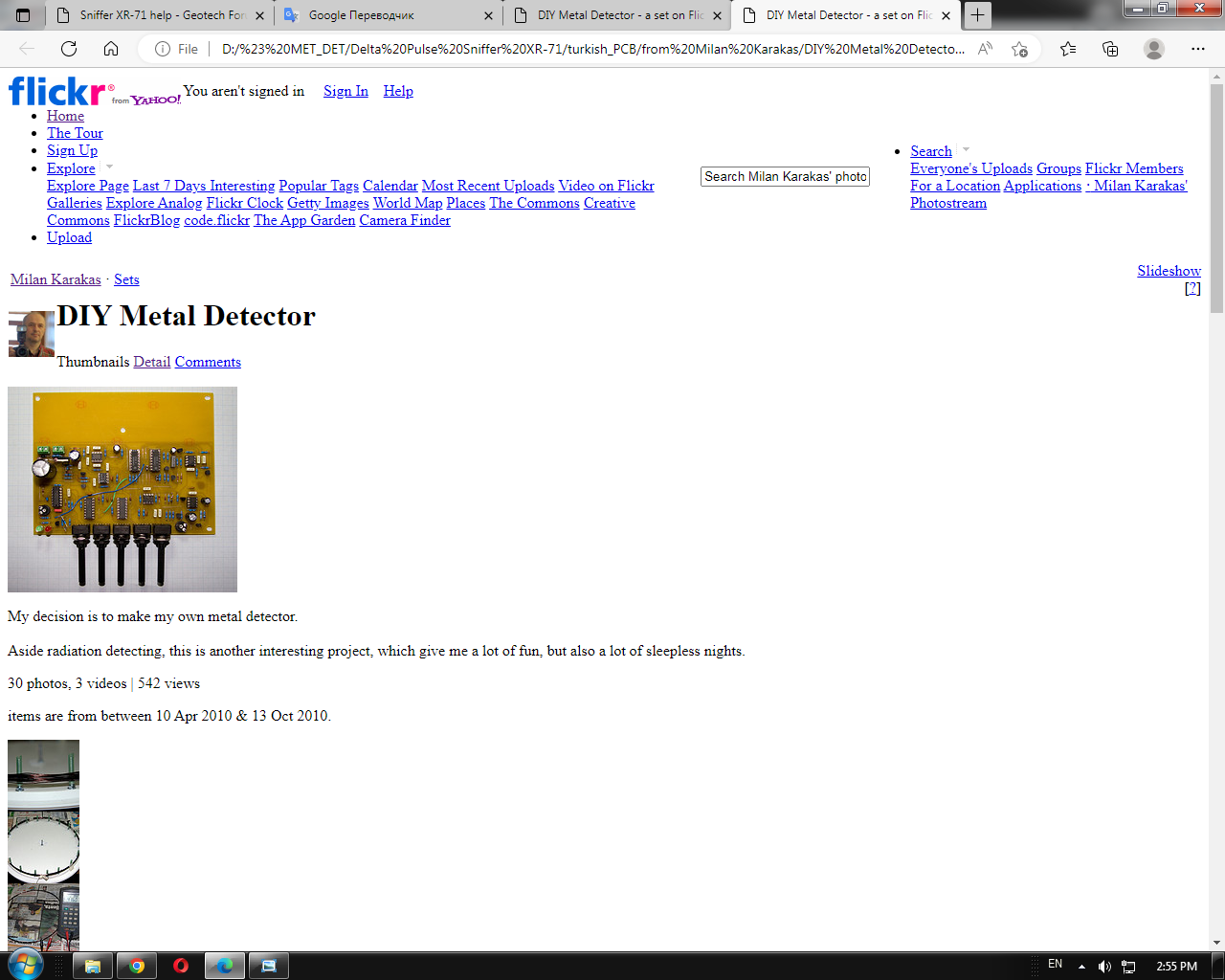

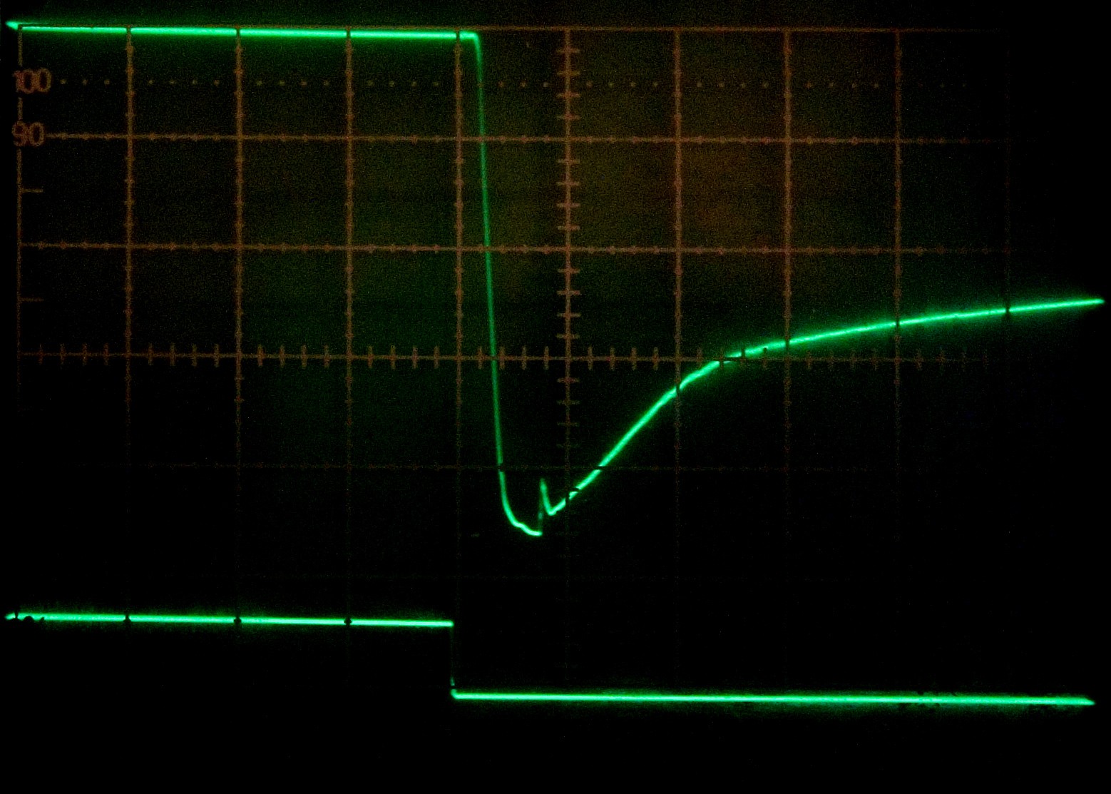

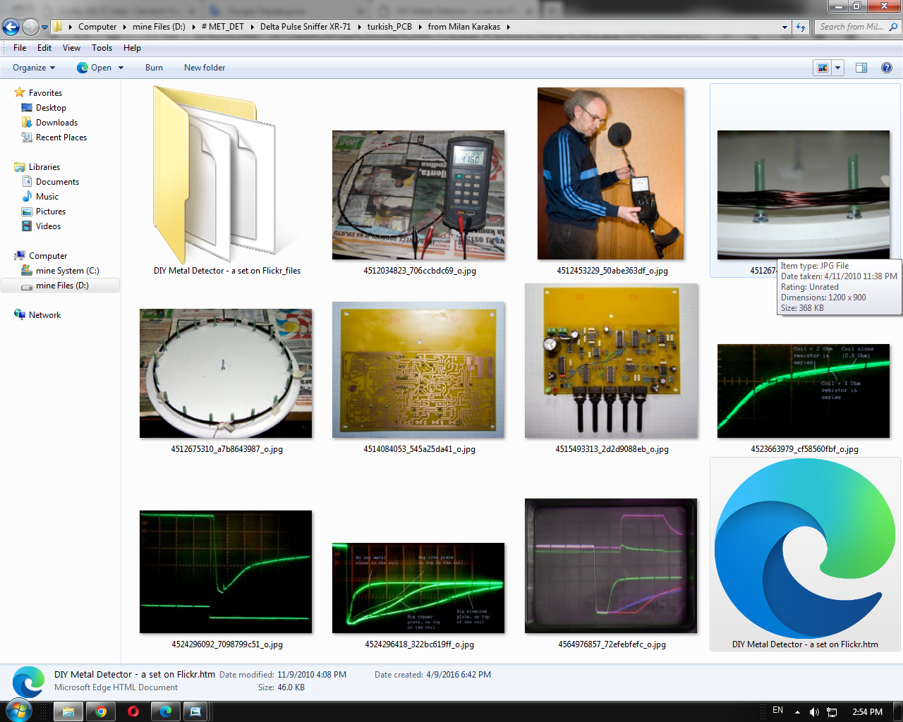

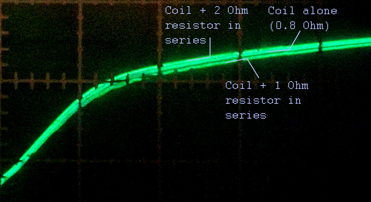

                      Milan Karakas did. i did hope his site is still working, but not. i did not keep all images.
                      • #56
                        • #57

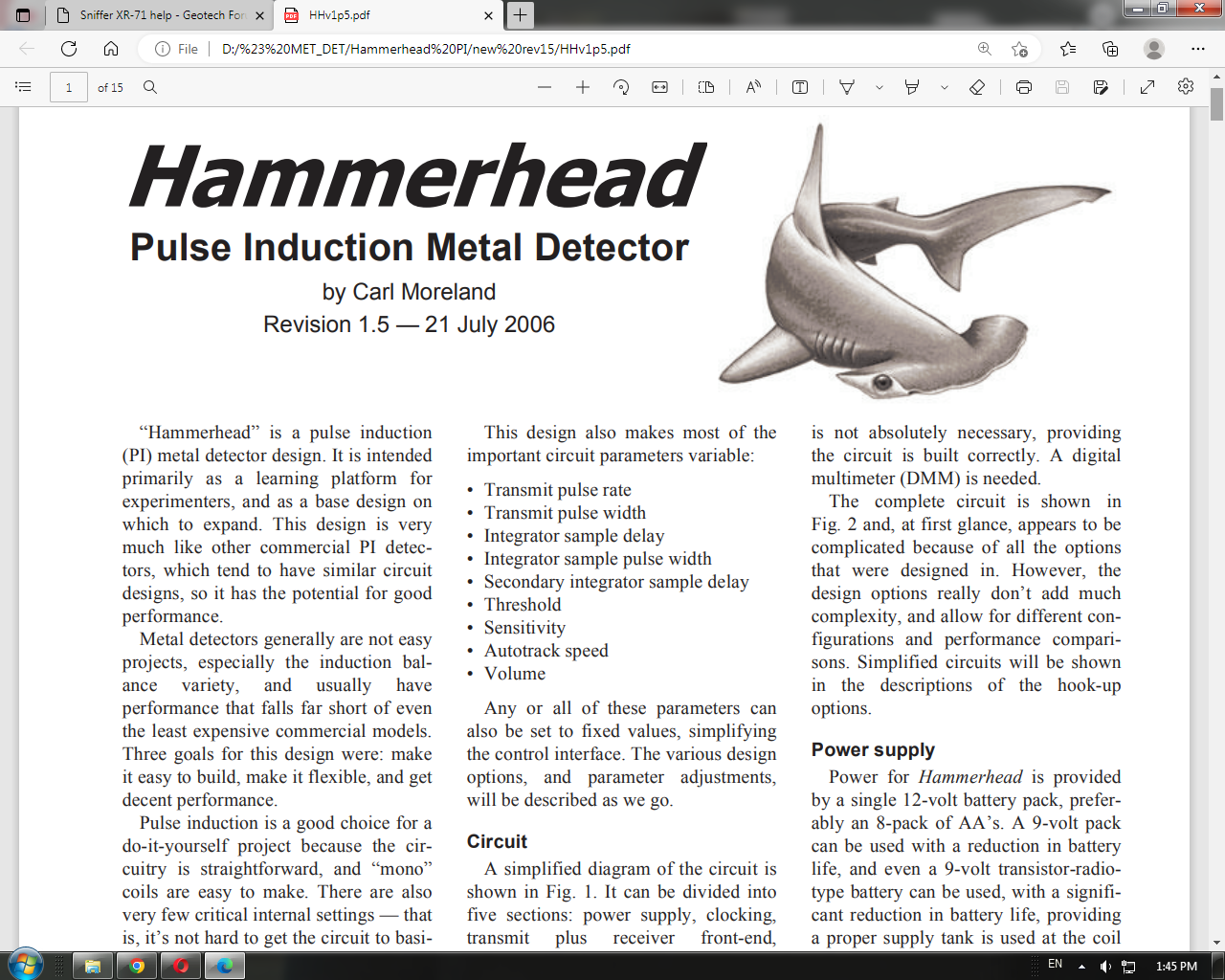

                              no so sharp need to look the signals in DP. if you got a problem no one signal pic does not help you. be cause there not signal form is the cause of your trouble, but luck of technics and general unknowledge of electronics base. no practic? solder radio kits, solder any electronics kits from aliexpress.
                              DO ALL PCB AND GET STANDART SOUND REACTION ON METALLIC.
                              if you so need the theory of Pulse Induction, theoretic material, you can open ITMD in anytime and read the book. also I had recomended you read the article HAMMERHEAD PULSE INDUCTION METAL DETECTOR PROJECT, author CARL MORELAND.
                              best manual on all PI projects you seek around.
