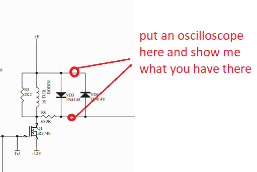

      Hello, good time. Sorry if my question is unrelated to our previous topic, but I have a question about the clamp circuit used in the Sniffer XR‑71 device. At first, the diodes used in that circuit were 1N4148, but the circuit did not reduce the output going into the preamp to ±1 V. I replaced the diodes with 1N5819 Schottky types to solve the problem, but it still had no effect on the operation. Could you please guide me? Thank you.
      • #63
        Please post a question only once, and in an appropriate thread.
        In the case of the XR71, the diodes should clamp the signal to +E (+12V) so the signal at the input to the opamp should be limited to 12V +/- 1V, or 11V-13V.

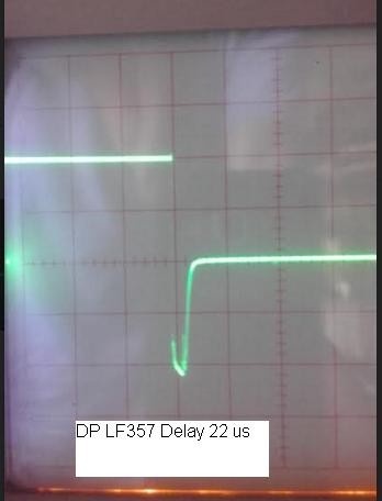

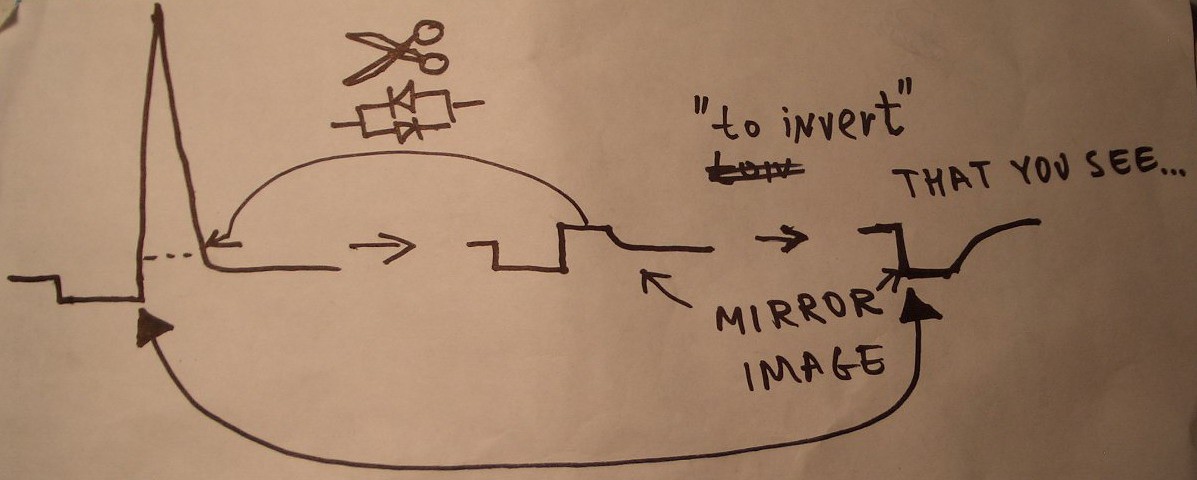

            change the diodes back. no such suggestion to change 1N4148s on Shottky. not exist. you have to see 'classical' view on preamp output. Click image for larger version  Name:	CIMG4444.jpg Views:	0 Size:	86.2 KB ID:	445476 Click image for larger version  Name:	DP LF357.jpg Views:	0 Size:	19.4 KB ID:	445477

                green trace is the output of the LF365 at pin 6, and the yellow trace is the input of the LF357 at pin 2.
                I still don’t understand what you mean by the ‘classical’ view.

                  “At the input of my op‑amp I don’t have anything like that.
                  My positive voltage is lower than +12 V, but my negative voltage is much higher than −12 V, and sometimes it reaches close to −90 V or even mo
                  • #69
                    “These two images were taken separately, each with the same probe fixed on the point you mentioned, so that nothing changes between them.”

                      Originally posted by Jafar View Post
                      post #66
                      The diodes are dead , remove them and check them, the voltage over there should be 0.6Vpp, increase R6 to 1k.​
                      • #71
                        “I checked the diodes. Even when the diodes were 1N4148, the same voltage shown in the photos was present. Since this diode was made in China and not suitable for the coil’s instantaneous current, I suspected that this might be the reason the clamp circuit wasn’t working. So I replaced it with a Schottky 1N5819 to see if anything would change, but nothing happened. I tested the diodes and they are all OK.”
