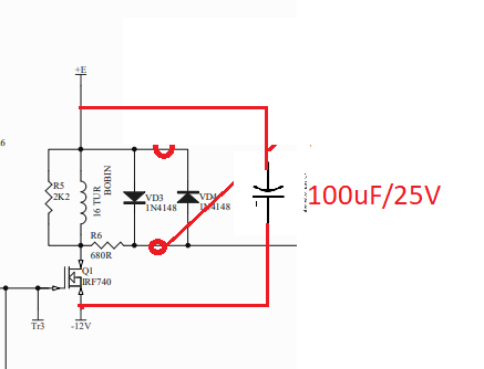

    The diodes are dead , remove them and check them, the voltage over there should be 0.6Vpp, increase R6 to 1k.​
    “I increased R6 to 1 kΩ, but the peak‑to‑peak voltage didn’t change and remained the same as before. I even reduced the resistor to 500 Ω, but still nothing changed. I lowered it further to 330 Ω, yet again no change occurred.”
    • #77
      if diodes are ok ( not burned out ) then there is no needs to change resistors, your problem is in this area, add a capacitor as on the drawing, check DC voltage on both sides of the diodes ( betwin ground and diodes ), with coil and withouth coil.

      • #78
        “Is the capacitor shown in the picture not sufficient?
        Should I add the capacitor you mentioned?”
        • #79
          Should be enough, DC voltages on diodes ?

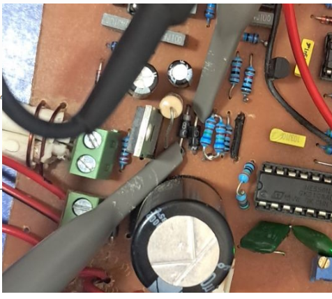

              Take another photo of this area on both sides of the PCB

                  After putting the snifferxr71 project aside for a while, I’ve started working on it again.
                  My clamp circuit is now working correctly — the mistake I had before was improper use of the oscilloscope, because I wasn’t connecting the scope’s ground to the circuit ground.
                  Now the problem I’m facing is with the preamp (LF357).
                  Everything looks good up to the preamp input, but the op‑amp does not produce a proper output, and the waveform is nothing like the preamp signal shown in the Hammerhead project or in the pulse detector example from Carl’s book.
                  The device frequency is 108 Hz.
                  One modification has been made in the project:
                  I disconnected pin 1 of T2: BC546, because it was causing interference with IC D2a (4538. I did this based on Carl’s advice.
                  I’d appreciate any guidance on what might be causing the LF357 output issue.
