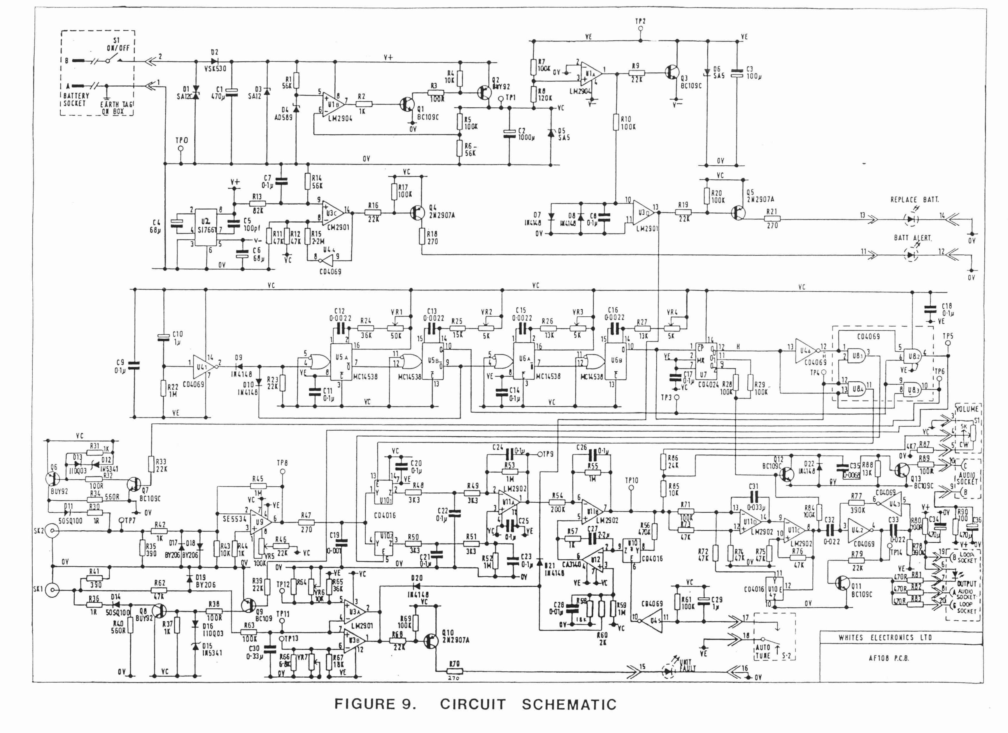

      I found something in one of Eric's posts, but I don't know if that would help with the cancellation of EFE.

          It's basically a BiPolar transmitter. If you demodulate the signal alternating between +pulse and -pulse the earths field is eliminated. See the Bipolar circuit in ITMD3 you could use the the same differential pre-amp and sample timings.
          Two other examples of this Tx are the Whites mine detector and a prototype called the Manta.
          https://www.geotech1.com/forums/foru...metal-detector

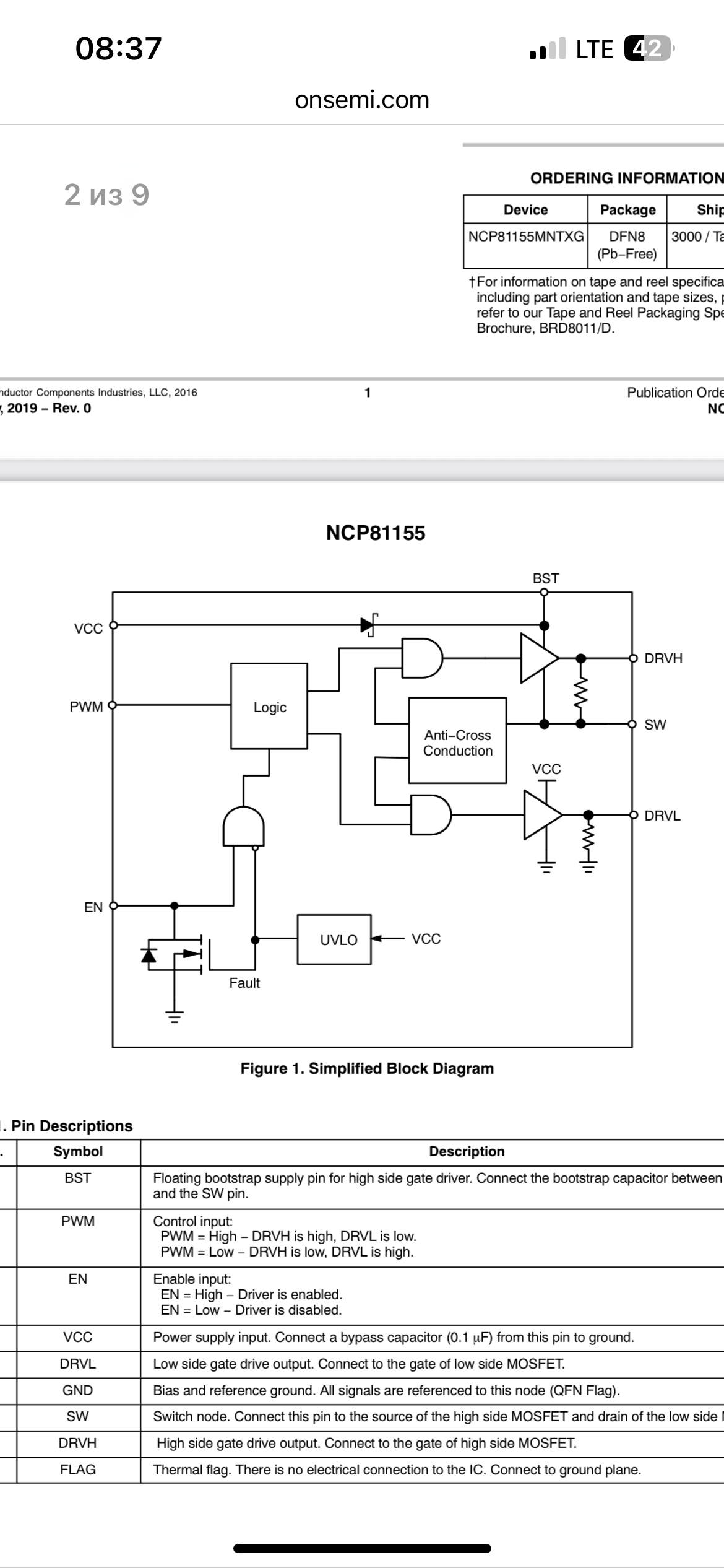

                    Are you looking for such a driver?

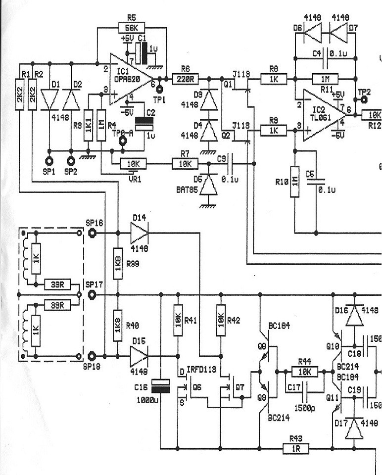

                      This schematic shows that a split coil is driven at the same time with the same pulse, and is then combined into a single receive signal. It won't do what you want.
                      To do what you want requires generating an independent TX pulse for a second driver. That means modifying the PIC code, which means you will need to replicate the existing PIC code. That's not too hard because it mostly just generates timing pulses, and there are a few unused pins available. Then, the second TX coil output will need to drive the (+) side of the preamp (via a clamp) which, fortunately, has a convenient resistor (R13) that can be removed. Finally, you will need to add new timing pulses for the sampling switches to grab the samples for the new negative TX pulse.
                      None of this is impossible and is quite doable. You will need to make a small daughterboard for the new components and write new firmware. Also fortunately, the coil connector has 5 pins so assigning one to the new TX phase isn't hard, but it might be hard to maintain compatibility with stock coils.

                          You are very kind, but what I need is something completely different. I have Carl's ITMD3 book; I bought it when Carl released it, and I have also successfully built the Bipolar PI detector. I want to improve my TDI detector. I want to obtain bipolar pulses from unipolar pulses, since the TDI only generates one monopolar pulse, and from this pulse, I want to generate another pulse to control two IRF740s. I appreciate everyone who tried to help me.
                            Hello Eduardo.
                            You can't make two impulses out of one impulse.
                            Karl has already written on this topic.
