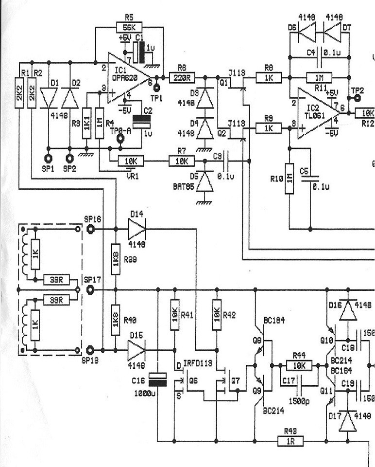

    This schematic shows that a split coil is driven at the same time with the same pulse, and is then combined into a single receive signal. It won't do what you want.
    To do what you want requires generating an independent TX pulse for a second driver. That means modifying the PIC code, which means you will need to replicate the existing PIC code. That's not too hard because it mostly just generates timing pulses, and there are a few unused pins available. Then, the second TX coil output will need to drive the (+) side of the preamp (via a clamp) which, fortunately, has a convenient resistor (R13) that can be removed. Finally, you will need to add new timing pulses for the sampling switches to grab the samples for the new negative TX pulse.
    None of this is impossible and is quite doable. You will need to make a small daughterboard for the new components and write new firmware. Also fortunately, the coil connector has 5 pins so assigning one to the new TX phase isn't hard, but it might be hard to maintain compatibility with stock coils.

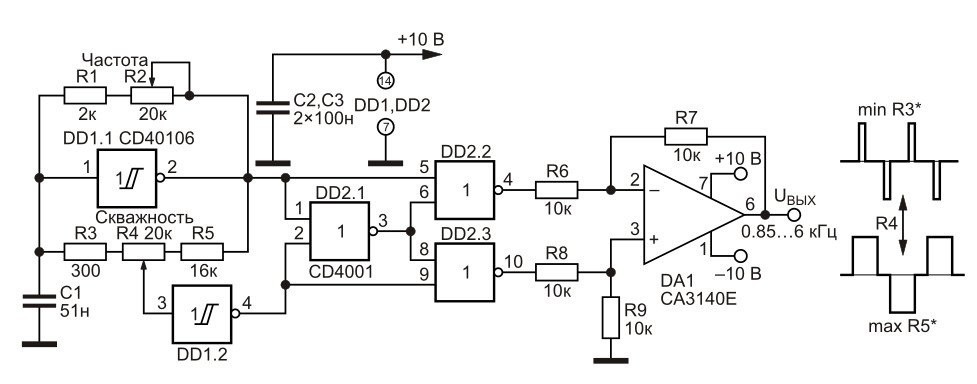

      Hi eduardo1979,
      are you looking for something like this circuit?

      Hi Geomax. After looking more closely at your diagram, it seems to be quite close to what I was looking for. Perhaps Carl can clarify things a bit more.

                  Hi, GeoMax, have you tested this circuit on any pulse detector? If so, what is the difference with this pulse, which one is better in terms of depth or better ground effect with it, what was the benefit?
                    Hi Algan,
                    no, I have not tested this. I got it from a Russian Detector Forum page. Which one I can not remember. But it was quite a long time ago.

                        Regardless of what scheme you come up with to run a second TX drive, you still need to modify the firmware to drive the alternate phase of the sampling switches. Since this is required, the overwhelmingly easiest TX solution is to just add a second TX pulse to the micro. Then you will need a small add-on PCB with around 14 components.
                        A few years ago I started playing with a proportional timing scheme for the TDI-SL, so I wrote all-new firmware for the micro. I started out making it exactly replicate the factory operation, then modified it for my purposes. I think I would be willing to release the factory version which would give you an easy starting point for adding bipolar operation.

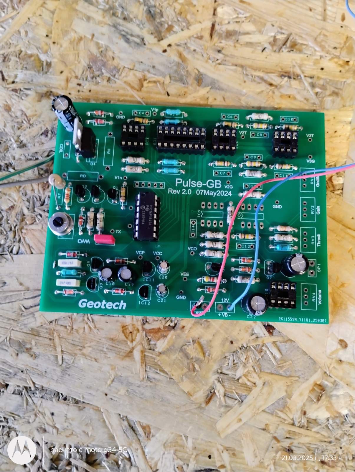

                                Hello Carl
                                This peak PIC16F684 Is it possible to try it on this board?
                                With these source code files.
