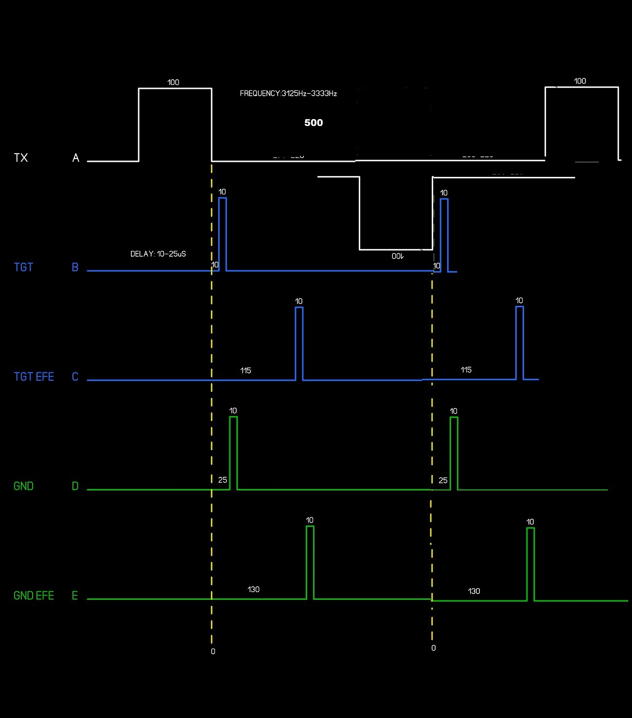

        Thanks Eduardo, but for the bipolar, is that how the samples should be? Click image for larger version
Name:	PULSES TDI bipo;ar.jpg
        • #49
          Hi Algan. I don't know. I don't have much experience with bipolar detectors, except for Carl's Bipolar PI. I suppose the other four samples also need to be modified, but I can't say for sure. In the end, I'll stick with unipolar designs because I don't really understand bipolar ones. In the future, I'll build the AF108 circuit, but the original one, not with a microcontroller.

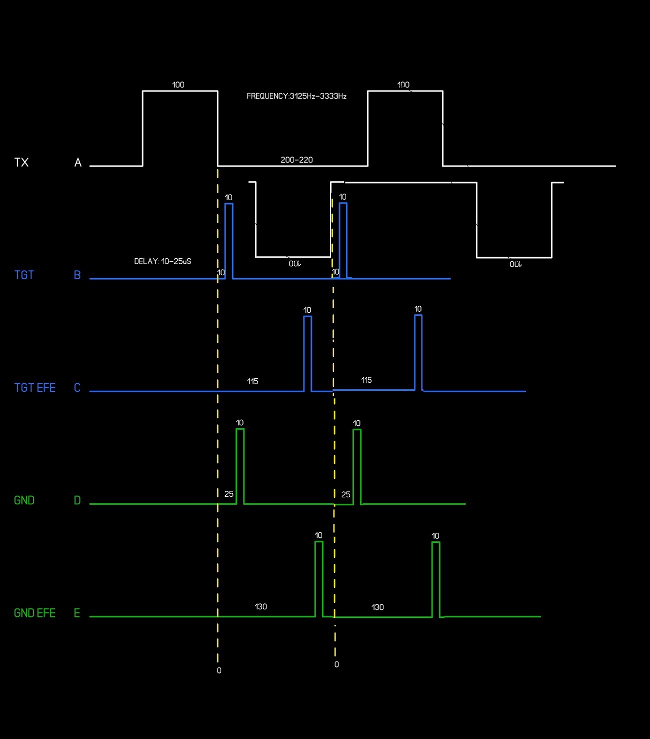

            I think this is more correct and I'm learning too, but let Carl say if this option will work. Click image for larger version
            • #51
              If you intend to use the TX driver as in post #1, then both TX pulses need to be positive.
              • #52
                Thanks, Carl, it would be interesting to try it post #1 and see how it would affect depth and discrimination.

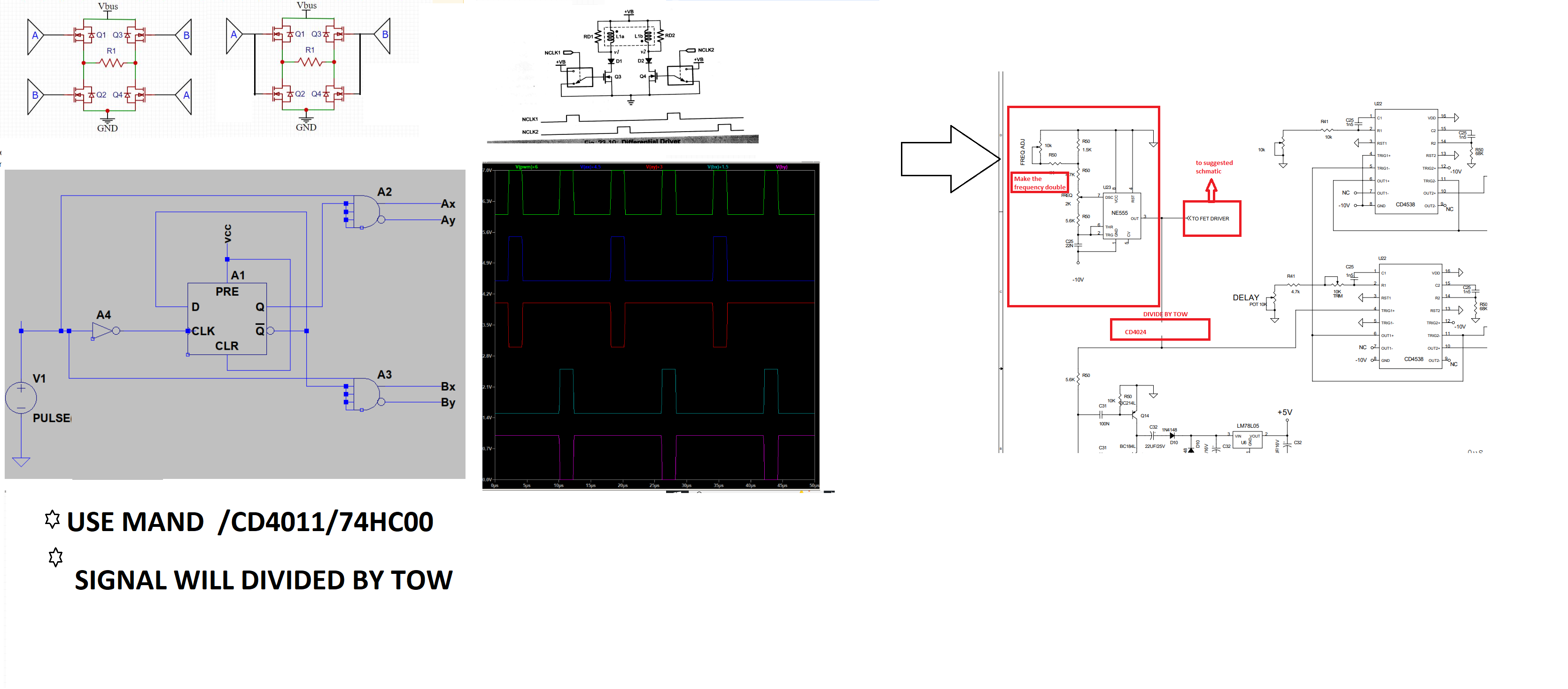

                  hello Eduardo , may be this can help think of it also you can run the h bridge if you want , if some body can do spic its better , regards to all

                            • #59
                              Hi, Boilcoil, I think Carl would not mind if you changed the code. He gave it to help us, but it is not yet ready to serve what he wanted. Eduardo, to test it on TDI, the code must be changed and there can be two versions, which I have given as an example with pictures. In the first picture, as Carl said, both pulses must be positive, and in the second picture it will also be completely different and one pulse will be negative.
