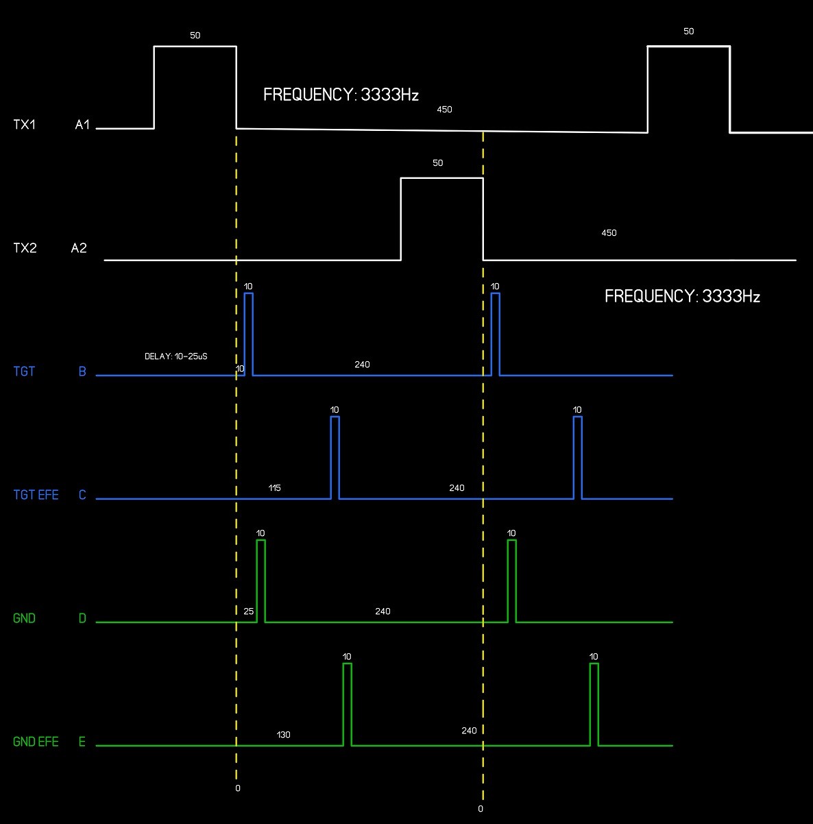

    Hi Algan.
    I've attached a timing diagram that I think we need. I'm not entirely sure if it will work or not. I'd appreciate the experts' opinion.​
    • #62
      Originally posted by eduardo1979 View Post
      Hi Algan.
      Hello Eduardo
      At this frequency of 100 microseconds, pumping cannot work.
      Or will it consume 400/500 milliamps of current?
      You watch Carl's video again.
      It's written in this code.
      • #63
        Hello, Eduardo, my colleague Pechkata correctly wrote that the consumption will be very high this way, but this version of my first circuit, look carefully at how I drew it, the samples and they overlap with the second pulse, that's why Carl wrote that both should be positive, it is better to make the second circuit there is no overlap of the sample with the pulse, I will see if I can correct the code and I need to reduce the width to 50 microseconds, done this way it will work, and it will also be possible to make one pulse low in the second version or like Carl's bipolar, this variant will even work there too

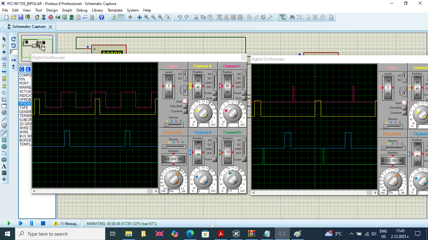

          I think you don't need anything more, just use what Karl posted. You already have a schematic, a board and the necessary microprocessor -just do it.
          I ported the code to a PIC16F1705 microprocessor, because I have a simulation model for it and at first glance - everything is fine.
          Click image for larger version  Name:	Bipolar PI.png Views:	0 Size:	224.4 KB ID:	443168

              Hi Eduardo, this is what I need too, this will help you do the TDI test. One of the pulses could be negative, both could be positive, there is no way to predict how it will work but, only a real test would give an answer. Click image for larger version  Name:	фсздвьи.jpg Views:	0 Size:	89.7 KB ID:	443171
              • #67

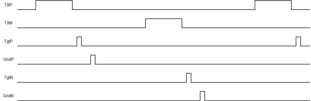

                This is what the timing should look like:
                With bipolar pulsing you no longer need the EFE samples. So now Tgt & Gnd can be called TgtP & GndP, and TgtEfe/GndEfe can be called TgtN/GndN.
