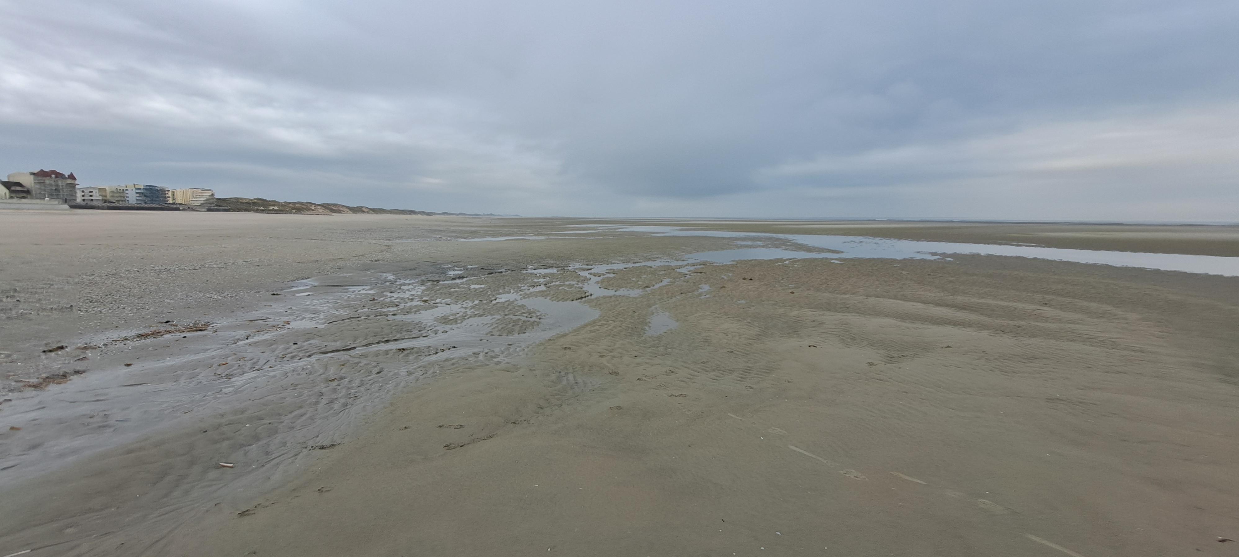

                      Very interesting video, because it shows a real field limitation that many people do not fully understand until they experience it themselves.
                      Here, on some beaches along the Atlantic coast, especially in areas near Bordeaux and in the Landes region, we encounter black sands that are extremely rich in iron-bearing compounds. From our experience, once that concentration becomes high enough, no VLF or multifrequency detector sees anything anymore. I do not mean a small loss of depth or slightly unstable target IDs. I mean complete loss of useful detection, because the ground response itself becomes overwhelming compared to the target response.
                      To give a very concrete example, a 20-gram 18k gold signet ring placed directly on top of this kind of sand may not be detected at all. So we are no longer talking about reduced performance. We are talking about conditions where even a large gold target on the surface can effectively disappear for this type of technology.
                      It becomes even worse when that sand is saturated with seawater. In that case, you are combining two very difficult factors at the same time: a very strong ferruginous mineral component, and very high salt conductivity. Even when the tide has gone out and the sand is only damp, or nearly dry, VLF and multifrequency detectors are already in serious trouble on this kind of ground. When the sand is fully soaked with seawater, the problem becomes even more severe.
                      In those conditions, only PI detectors with a true ground balance remain genuinely usable. This is not really about brand loyalty or personal preference. It is mainly a matter of signal physics and of whether the detector is capable of handling a ground response that becomes much larger than the response from the target itself.
                      What is also interesting is that this phenomenon is not necessarily volcanic in origin, even though visually it can look very similar to the iron-rich black sands found on volcanic beaches. In the Landes coastal area, the geological explanation is different. The document I looked at describes clayey-peaty layers and paleosols exposed by marine erosion at the base of the dunes. Water emerging from those levels can be rich in dissolved ferrous iron, and once it reaches the surface it oxidizes, producing rusty flows, iridescent films, and visible ferruginous deposits.
                      The mechanism behind it is especially interesting. At depth, organic matter in the peaty layers can promote the reduction of ferric iron into ferrous iron, and this process can be strongly enhanced by bacteria using anaerobic respiration. Then, when that iron-rich water reaches the surface, the ferrous iron oxidizes into insoluble ferric compounds. According to the document, this oxidation is not only abiotic: it is greatly accelerated by iron-oxidizing chemolithotrophic bacteria. In other words, part of what you see on those beaches is linked to a natural sedimentary and microbiological process, not to volcanism.
                      That is also why these areas are often misunderstood. People see dark deposits, rusty outflows, rainbow-like surface films, and naturally assume pollution or some volcanic origin. But in this case, the document describes a natural coastal process associated with ancient peaty soils exposed between dune and beach, especially in areas such as Grayan-et-l’Hôpital, Vensac, and Vendays-Montalivet.
                      So, going back to the ring test, what we see in that video is entirely consistent with what we observe here. Once the ferruginous mineralization reaches a certain level, a VLF or multifrequency detector can simply stop detecting the target altogether, even if the target is lying right on the surface. And when seawater is added to the equation, the situation gets even worse.
                      In those conditions, PI is not a luxury. It is simply the appropriate technology.
