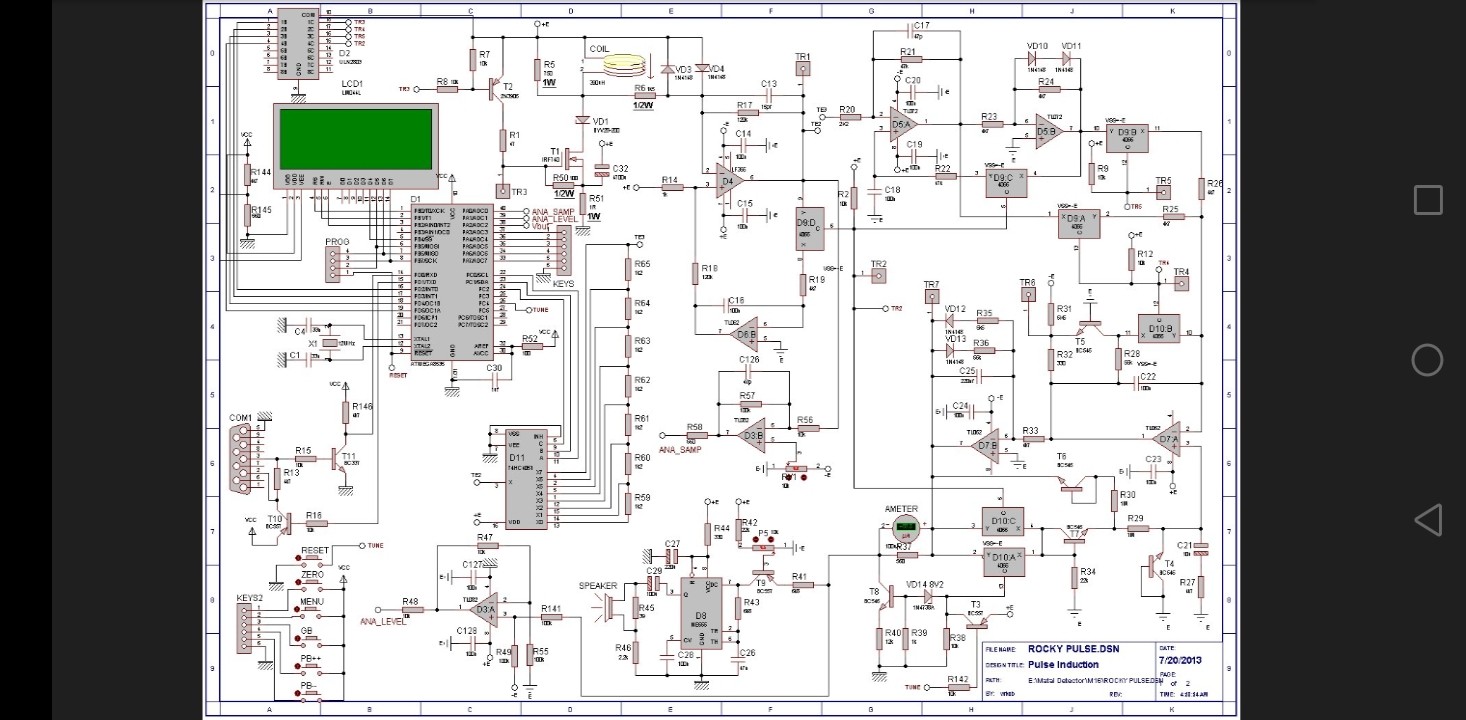

                  So far, as I understood; you would like something like this:

                      oh oh oh. just remind you chineses are selling SANDBANKS based oldest detector and get good money, this schematic with just one sample while DP uses
                      two - second is ground balance.
                      MAIN AXIOME. you can not build something if do not have full documentation. you can not build ML GPX5000 because you have not even pics of the pcb.
