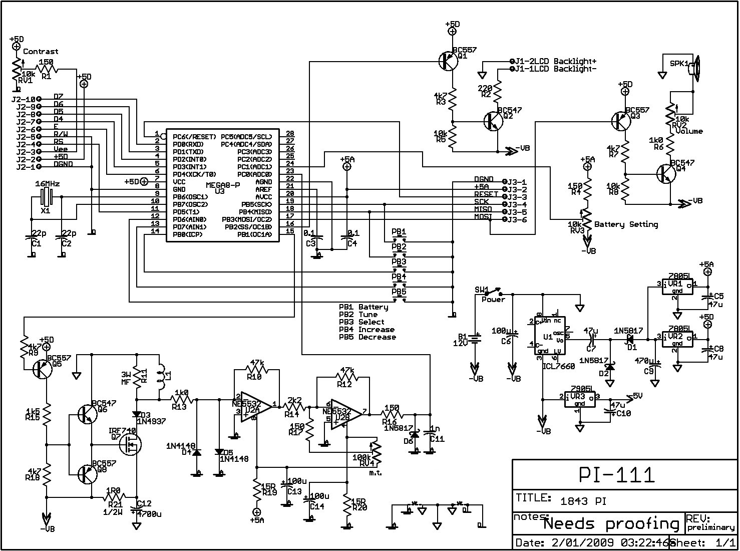

      Work in progress.
      • #63
        Schematic fits on 8-1/2 X 11. Eagle's schematics are normally butt-ugly. I modify 99.9% of all the symbols I use, and I don't like junction dots
        cluttering up a drawing. I think it looks better that way.
        Time to go work some more on "Elderadoo" PCB (argh).
        No Junction Dots ? This Schematic is very hard to read.
        Drawing Schematics is not Art, its strictly technical.
        There are Standards for this. Better use them.

          I suppose you have never heard of the standard where no connections are made where wires cross. Remember that no connections are made where wires cross and you don't have to worry "did he forget and leave a connection dot out". Dots are superflous when all connections are at "T" intersections rather than crosses.
          Sorry this standard does not meet with your approval, but I did not invent it. It makes perfect sense to me.
            I won´t throw any standart in your face , but i hate the no-dots schematics.
            at every intersection one must check if it is a T or not, of course no big deal but adds difficulty.
            On the other hand dot don´t bother me .
            Just my personal idea, nothing else

              Originally posted by Fred View Post
              <snip>... no big deal but adds difficulty.<snip>
              What's hard? Just follow a wire until it ends. Sure, it takes getting used to but it's not difficult. I know I'm in the minority here and I won't waste any more time swimming upstream. If this were someone's commercial project and they wanted dots I would say "No Way Dude" (just kidding). I would say "fine (jerk)". (I'm such a kidder.)
                In reality there can be a problem with schematics that don't have tie-dots.
                I've seen the situation more than once where two right-angled tracks are touching at the corners. To the naked eye this looks like a crossover point.
                It is always safest to use tie-dots, and never to use 4-way crossovers.

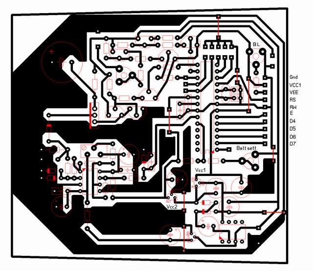

                            Even if share code here, i am total ignorant in programming Atmels, so that code would mean nothing to me anyway. Hex file could mean something, only if i manage to somehow build a programmer and programm that uPc. Of course meaning .hex was accurate, not some nasty joke (which will not suprise me at all). Last but not least; i must have a some good interest in making that device, which i dont have at all. I made over 50 PI's so far and i had it enough for this lifetime. I made those just to sell and earn some money. Personally i dont like to work with PI's at all. My favorites are VLF IB's and nothing else. So...conclusion; i dont give a sheet about this project.... True. Yet at the very start i just wanted to contribute here and help man drawing him a pcb, cose he asked for it so many times. I do have some spare time and why not doing that? I like to play with Sprint Layout and exercise drawing various pcb's. That's how man improving skills.
                            So...aside previous argues...here is my draw. If it suits demands here - fine, if not - fine again. I probably should not take a part in this topic, and i will not continue in future, for sure. Yet, once i started something usually i must finish. That's me.
                            Bye!
