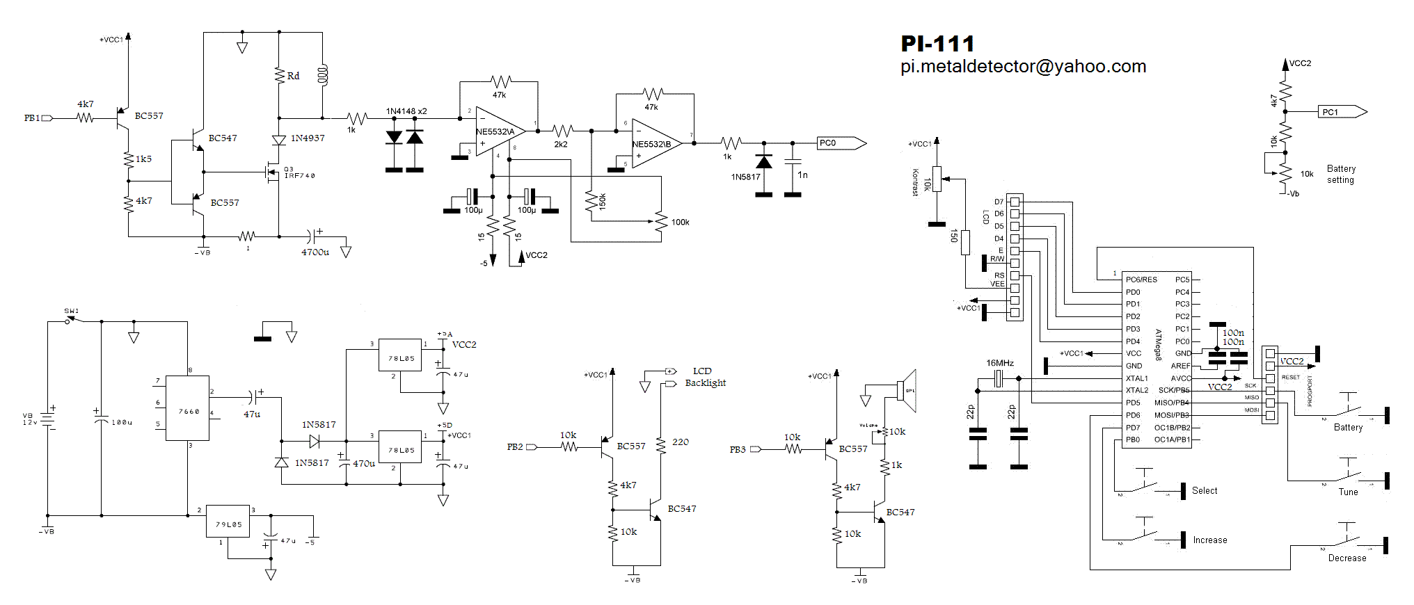

            • #51
              Yes you are right. But i respected your schematic!? I dont have any other schematic here!?!?!
              I also feel very,very sorry for your case...pitty!
              • #52
                Where of my schematic has two opamps opposite in gain configuration? Please show it.
                Update your PCB with respect to my second schematicHERE. There's only a dual opamp(TL072), and nothing else.
                1843
                • #53
                  Final schematic
                  Here's the final schematic.
                  Best regards,
                  1843

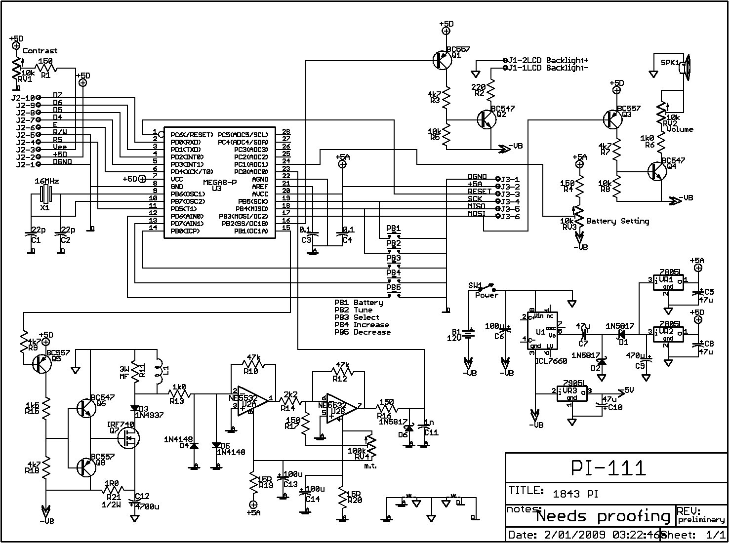

                            You don't want help designing a board, you want someone to design the board for you. It would probably help if you gave a list of preferred footprints or lead spacings you desire. We can probably guess that your opamp would be a dip-8, but what about your crystal? Capacitors lead spacings (note the plural)? Would 100 mil be OK for your ribbon cable, or 50mil, or what?
                            Are those TO-220 regulators, or TO-92? What is the trimpot(s) footprint?
                            This would be simple to do in Cadsoft Eagle, and would probably even fit the freeware version's 3-1/2" X 4-1/4" allowance.
                            What would someone get in return for turning out a PCB pattern to your satisfaction?

                              • #60
                                Eagle schematic
                                Schematic fits on 8-1/2 X 11. Eagle's schematics are normally butt-ugly. I modify 99.9% of all the symbols I use, and I don't like junction dots
                                cluttering up a drawing. I think it looks better that way.
