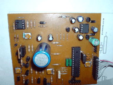

    • Hi all,
      I tested the PI. Because of 7660 DC converter, there's a lot of noise at the output of preamp.
      The 2 satge preamp really isn't working good...(because of high consumption) so I changed it to the original...like Barracuda.
ID:	322066Click image for larger version
Name:	Changed Pre PCB.gif
      Now I'm working on the DC converter to get a smooth current from it.
      Best regards,
      1843

          Then, you are free to use all the Carl's suggestions... and the Qiaozhi's PCB is ready to build... Syncing the 7660 is quite easy. So do what you like.
          • HEX
            I found a way for reducing the noise of 7660. I don't know which circuit you want to build... But I have my own including these changes:
Name:	PI-111 Changes.gif
            The my circuit is working very very stable and sensitive.
            And here's the HEX file.
            PI-111.hex.txt
            Best regards,
            1843

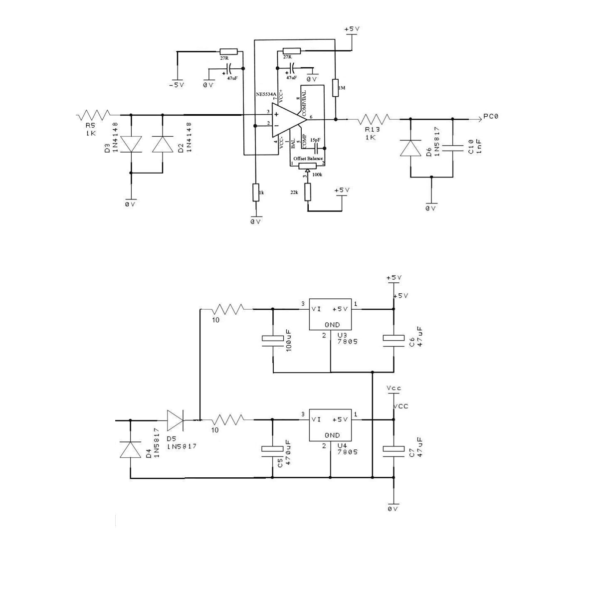

                    • Hi all,
                      the reason for the bad performance of the two stage amplifier version is as follows:
                      The first stage is an inverting amplifier with its input resistance of 1k. This is too low for such tiny signals. The non-inverting version with NE5534 has roughly 100k input resistance (=input resistance of op-amp).
                      Another issue is the DC/DC converter. It will produce more ripple noises, when there is more current draw. As I mentioned, the DC/DC converter must be synchronized to the cycle period to have always same and repetitive ripple noises (correlation to cycle period).
                      A discrete DC/DC converter should perhaps be considered to have lower ripple noises. But there is no other way: it must be synchronized.
                      Aziz

                        Hi Aziz,
                        Do you think if the DC converter be synced, It can provide enough current for all the parts?
                        I tested it when Carl suggested, but the ATmega was restarting all the time.(because of voltage drop).
                        Also the working frequency of 7660 gets half if it is synced.
                        Best regards,
                        1843
                        • Hi 1843,
                          Hi Aziz,
                          Best regards,
                          1843
                          the 7660 is specified only for low current draws. Synch'ing this would not help in this case. A discrete DC/DC converter is capable to deliver more current. Look to my proposal http://www.geotech1.com/forums/showp...&postcount=454 (post #454) for a discrete solution. It will deliver much more current. The higher the current source, the lower the ripple noises and voltage drops.
                          A simple high current DC/DC converter could be made with mosfet driver IC's (series TC426, containing two drivers). These chips can be configured for different DC/DC converters or paralleled for more current draw. See the data sheet for more info: http://ece-www.colorado.edu/~ecen451...p2/tc426_8.pdf
                          I personally wouldn't supply the micro on the DC/DC converter side. But it would require much design changes on your schematics. So another DC/DC converter could help here. The clock for the DC/DC converter must be sourced from the Timer/PWM output of the micro. A very simple synchronisation could be made, when on every cycle start (after the TX-on time), the PWM is reprogrammed again. This will compensate the uneven timings to the cycle period. A clock frequency of 10-50 kHz should be enough.
                          Aziz
                          • One way is to use a P-MOSFET for driving the coil, and a synced 7660 to provide the negative rail.
                            Like the PD3200. What's your idea?
                            1843
                            • Hi 1843,
                              1843
                              P-MOSFET's have a much lower avalanche breakdown voltage. We need as high flyback voltages as possible, to "kick the target stronger" and get more target signals.
                              Aziz
                              • But the diode in series with the MOSFET compensate it. Doesn't it?
                                1843
