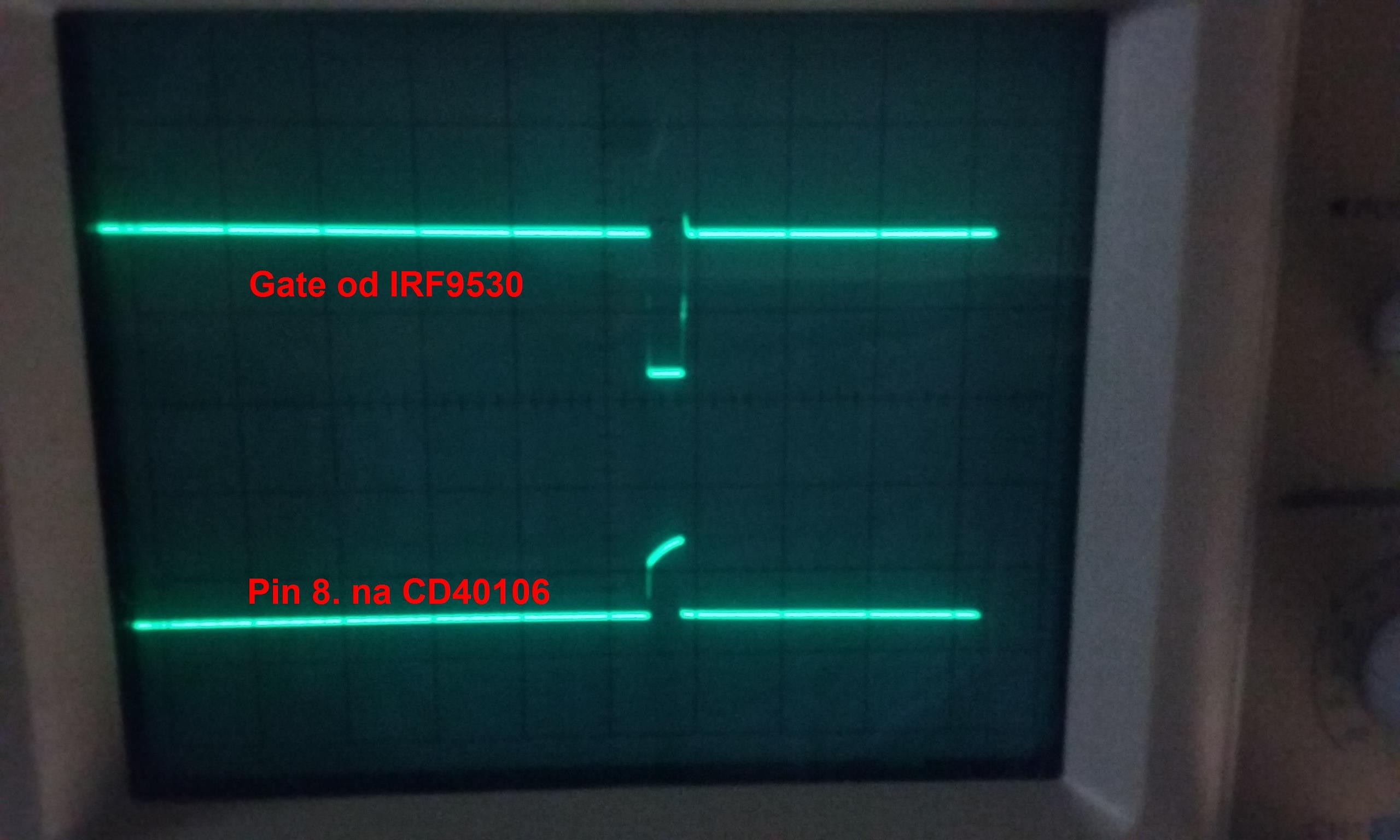

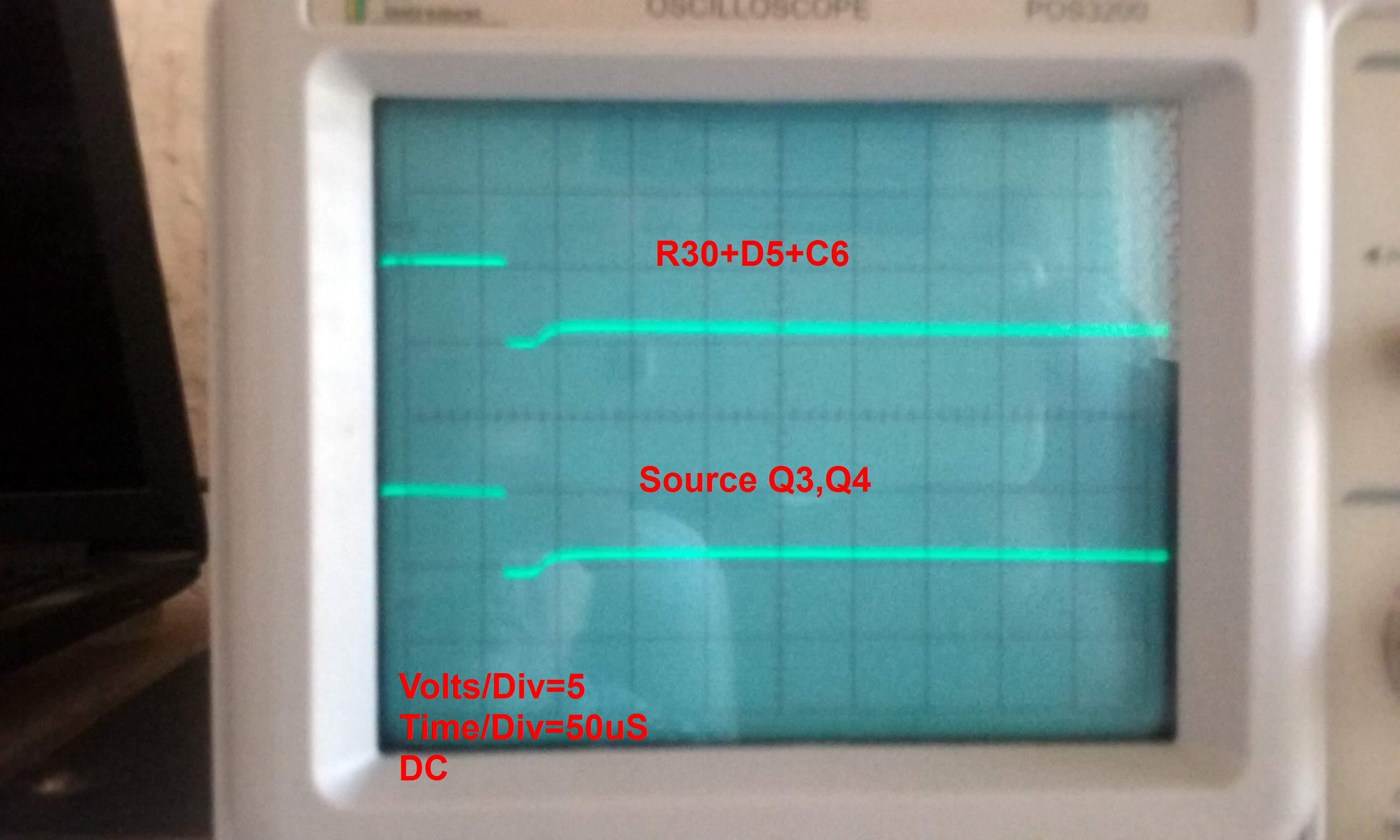

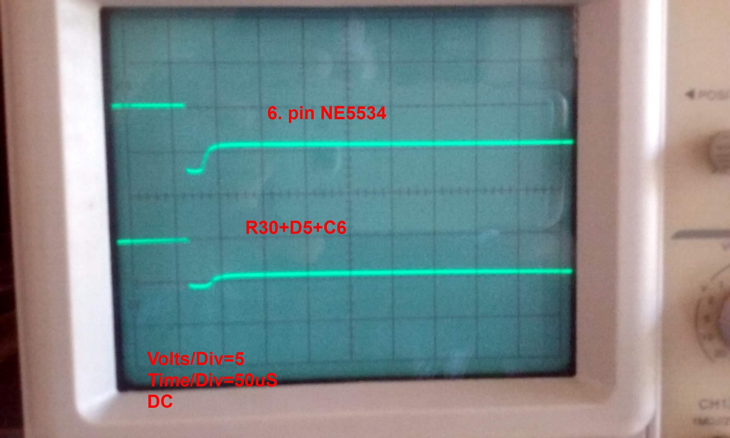

          That pcb was scrapped, in the meantime I experimented with some things and I no longer have the pcb in its original form.
          I have oscillograms, I can see from the date on the files that it was 2020.
          It might be useful.
          The first approach of the small pliers to the coil is at ~50cm and that's when changes occur.
          The coil is 17-18cm in diameter, 0.38mH, about 2 ohms.
          I initially made the coil for the FelezJoo PI and since then it has served me for various experiments in the workshop.

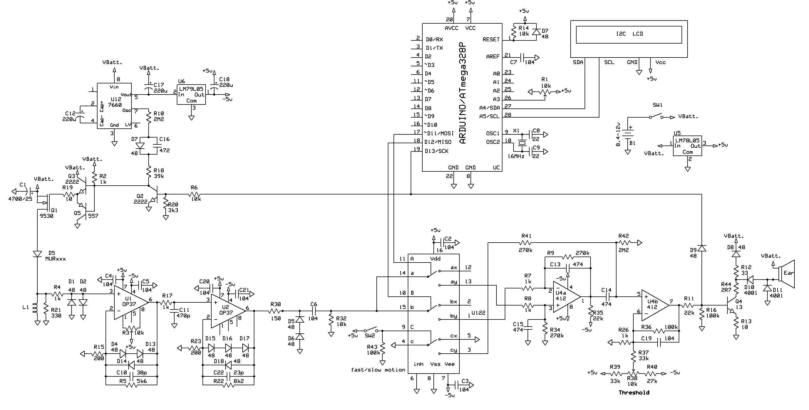

                Click image for larger version  Name:	AtmBarra_2xOP37.jpg Views:	0 Size:	410.1 KB ID:	420348​
                  A small note: I wrote the power supply 8.4-12v on the schematic, you should pay attention!
                  If a 7660 is used then the power supply should not exceed 10v.
                  In case of power supply of 12v and more; 1054 is the choice.
                  The 7660 will overheat and burn out.
                    And of course, something that I must mention without fail; Davor made a very significant contribution to the work on this version.
                    Without his help I would not have managed easily.

                      How is that N type Fet symbol in the TX circuit working out for you ?
                      • #41
                        Oh yeah... I don't pay attention to those things... my fault! You noticed well!
                        FQP3P50
                        IRF9530
                        IRF9640​
                        tested all 3 btw...

                          for now I replaced , Q2, Q3, Q5 by single logic gate MOSFET BSS138.
