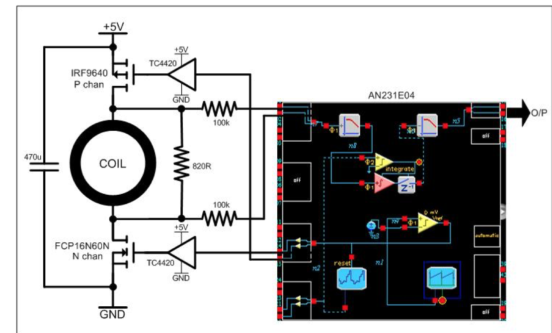

    The first thing I would change here is the TX.
    I would replace the existing one with bipolar using H-bridge.
    This will contribute to canceling the influence of the soil mineralization, and the EFE sample is then unnecessary (it can be used for something else).

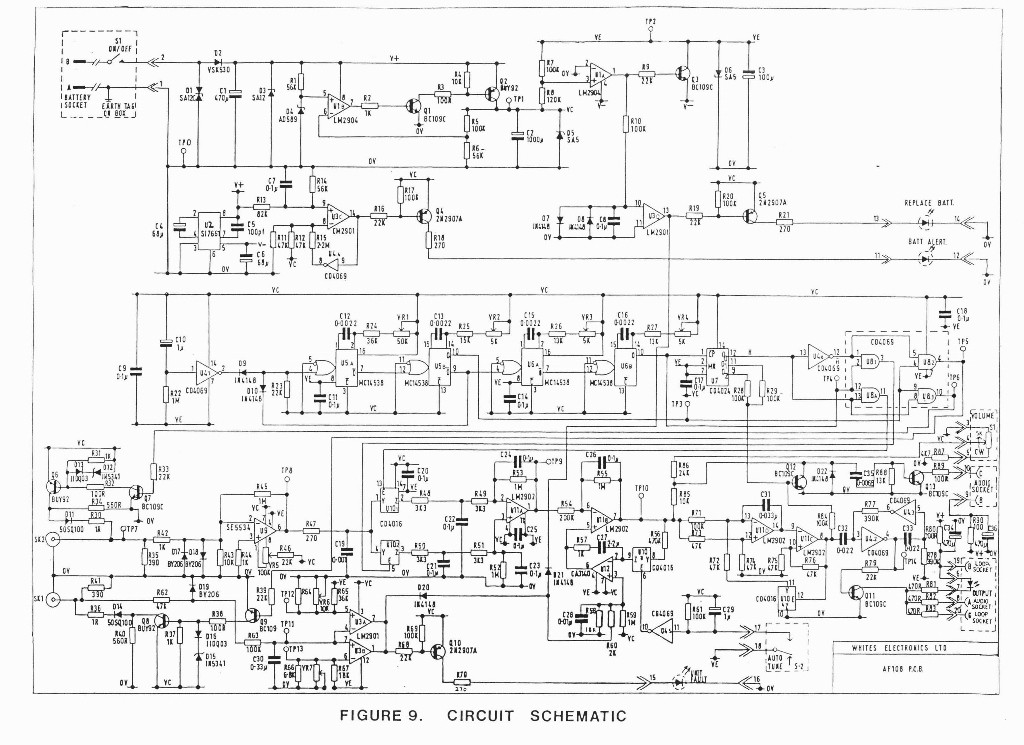

    I've been looking at the White's AF108 solution, I always go back to it because I like it. (It is not an H-Bridge, but it is a bipolar TX, more simply solved.)

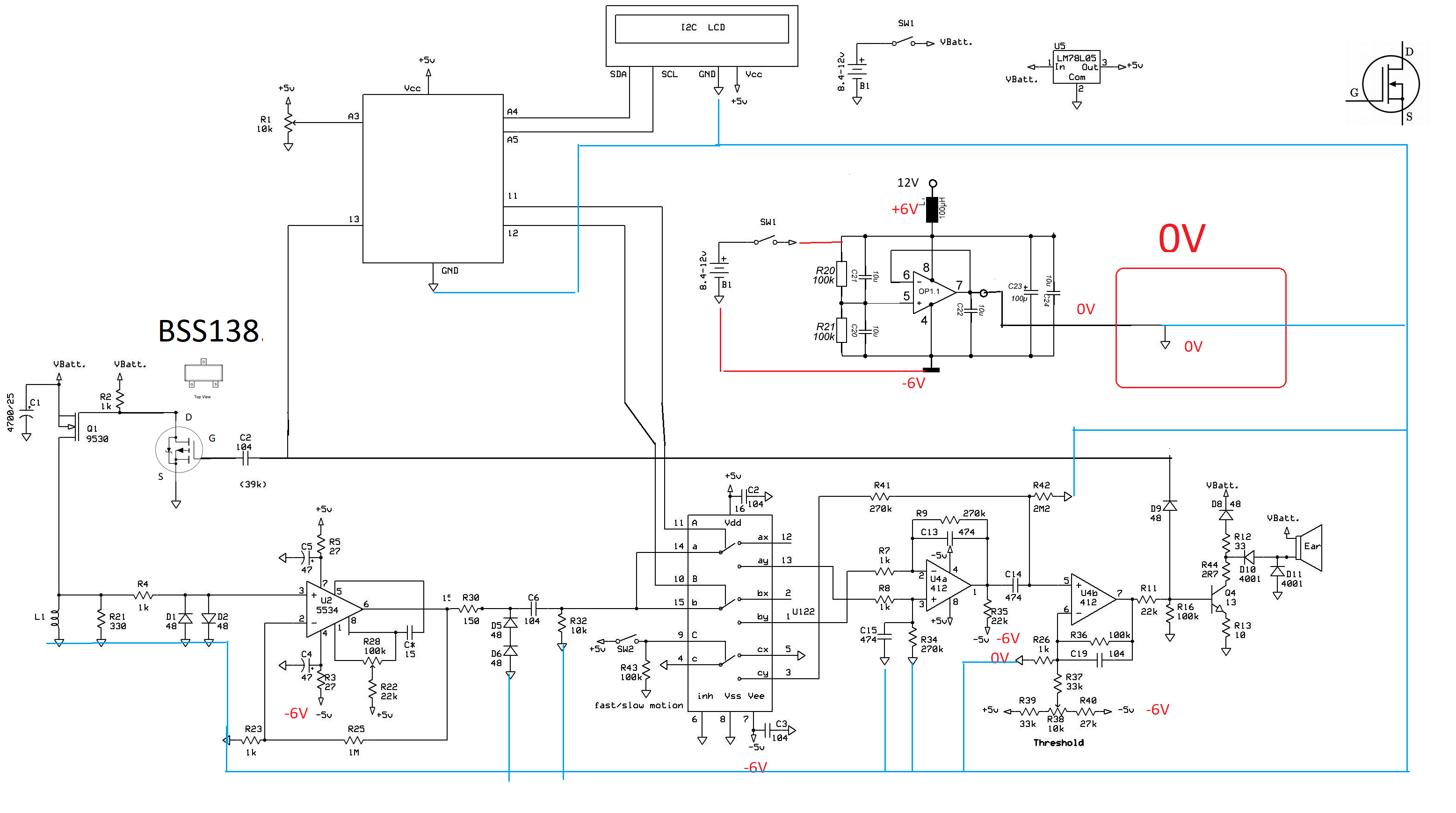

    • #47
      Only the truè insiders can spot and correct the intentional errors you plant in your schematics. They're made for the elite, the peasants is left with a dead board and scratching their heads. Devious!
      If you think I made a deliberate mistake with the mosfet polarity symbol... you couldn't be further from the truth.
      This is not the first time. I think Moodz already pointed it out once on one of my earlier schematics.
      It's the ExpressSch software (from the ExpressPCB package) that I've been using for years to draw schematics.
      I stubbornly did not want to switch to one of the newer versions, for years I used the old version, one of the first.
      And I got into the habit of using some components incorrectly.
      In the previous post I was joking with Moodz, of course it is a serious mistake and who is off topic; he may have a problem because of that.
      But Barracuda is too well known and mentioned topic, there are many topics on the forum dedicated to that project, even the birds on the branch
      already know that P-channel mosfet is used in TX.
      The one who did not already know this and is not able to notice such a mistake by himself (there is a mosfet mark next to the symbol);
      he is not immediately ready to work with this kind of detector. Although it seems simple, it is far from easy to make.
      But I certainly accept the blame.
      Later I started using a new version of the software in which I have better done component symbols.
      And in the meantime, I myself made a lot of custom symbols for use in that software.
      That schematic still dates from before, it was not made yesterday. The forum is full of them.
      It is recommended to do the original Barracuda first and the best pcb for that is the one offered by ApBerg.
      No, really I'm not that "cunning" and I don't set "traps" in my schematics.
      All my mistakes are unintentional and accidental. And the reason for that is my laziness and inertia.
      The schematic I presented here is purely "academic". Only one step towards the final version.

            I've been looking at the White's AF108 solution, = do you have a schematic ?

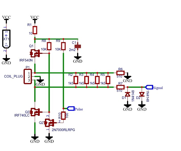

            • #51
              I would replace the existing one with bipolar using H-bridge.= maybe like this ?
              • #52
                How is this bipolar? Both MOSFETs need to be open at the same time, no inversion of current the coil.
                    • #55
                      @Carl-NC​
                      Too many components there, I think circuit from post 51 will do the same job (probably better )

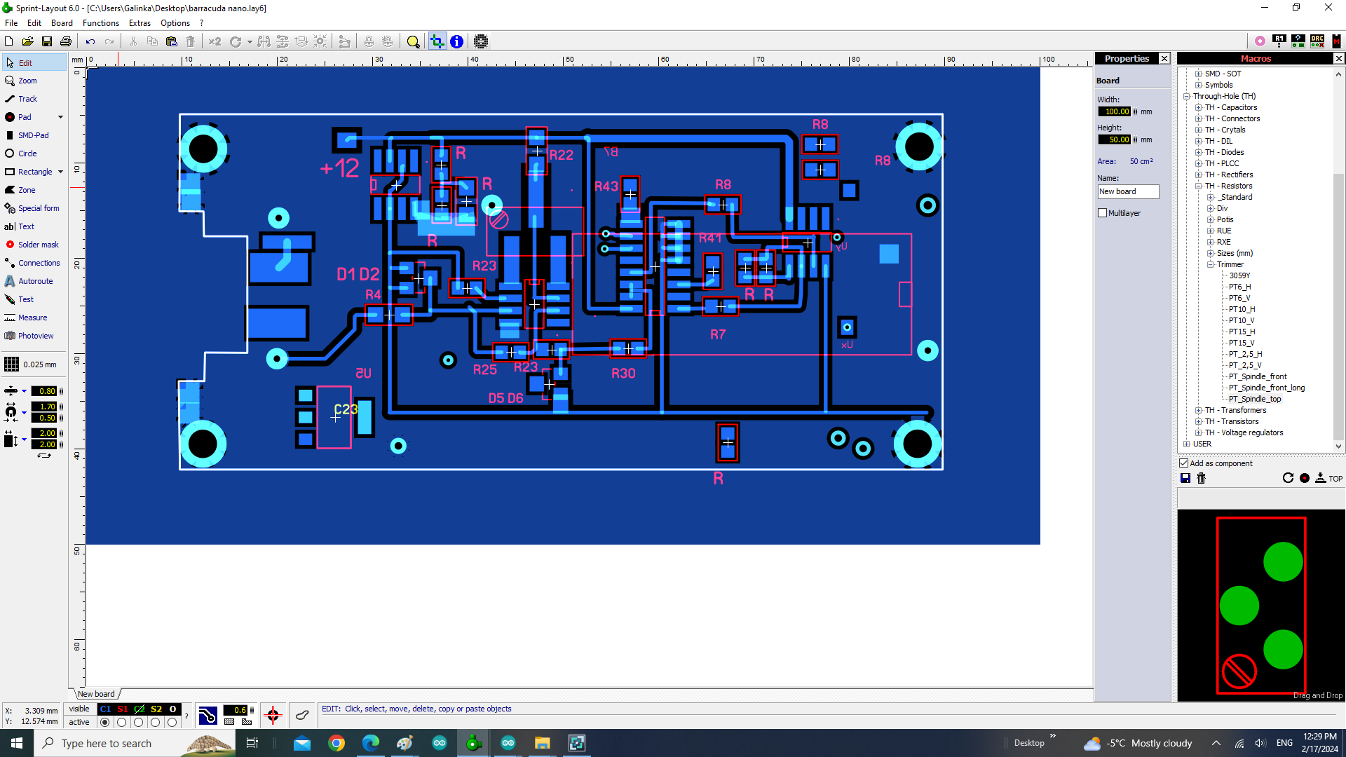

                            • #59
                              Almost done, PCB 80x40, and modified circuit.
ID:	420426 Click image for larger version
