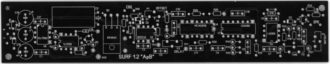

        Hi eessoo
        There is enough information about each**** you must**** read before you start.
        1-Surf PI. pcb in page 11.
        2-BARACUDA .pcb in page 2.
        best time
        j.

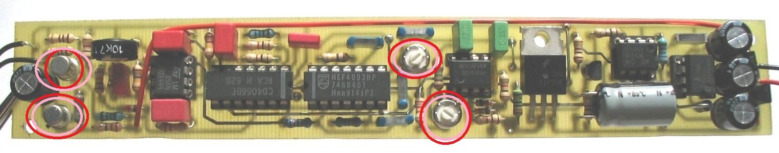

            what are these components (marked on the pic)?
              PCB
                This board is labled.

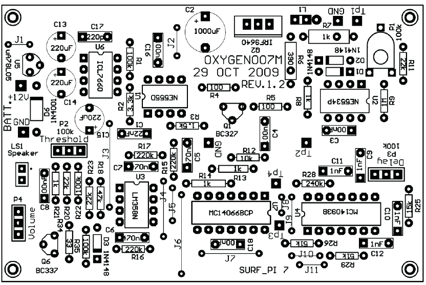

                  Re
                  Hi eessoo
                  An good choice FOR 1-Surf PI.
                  I advise you to do pcb in page 11 it is working from the first experiment.
                  The same Parts list except for the Q2: TIP32C =IRF9640

                            Hi eessoo
                            There is enough information about Whites Surf PI schematic**** you must**** read before you start.
                            -use any GerbView program.
                            best time
                            j.
                              where are the ( CD4066,TLC555 )?
                              are u sure they are the same components?
