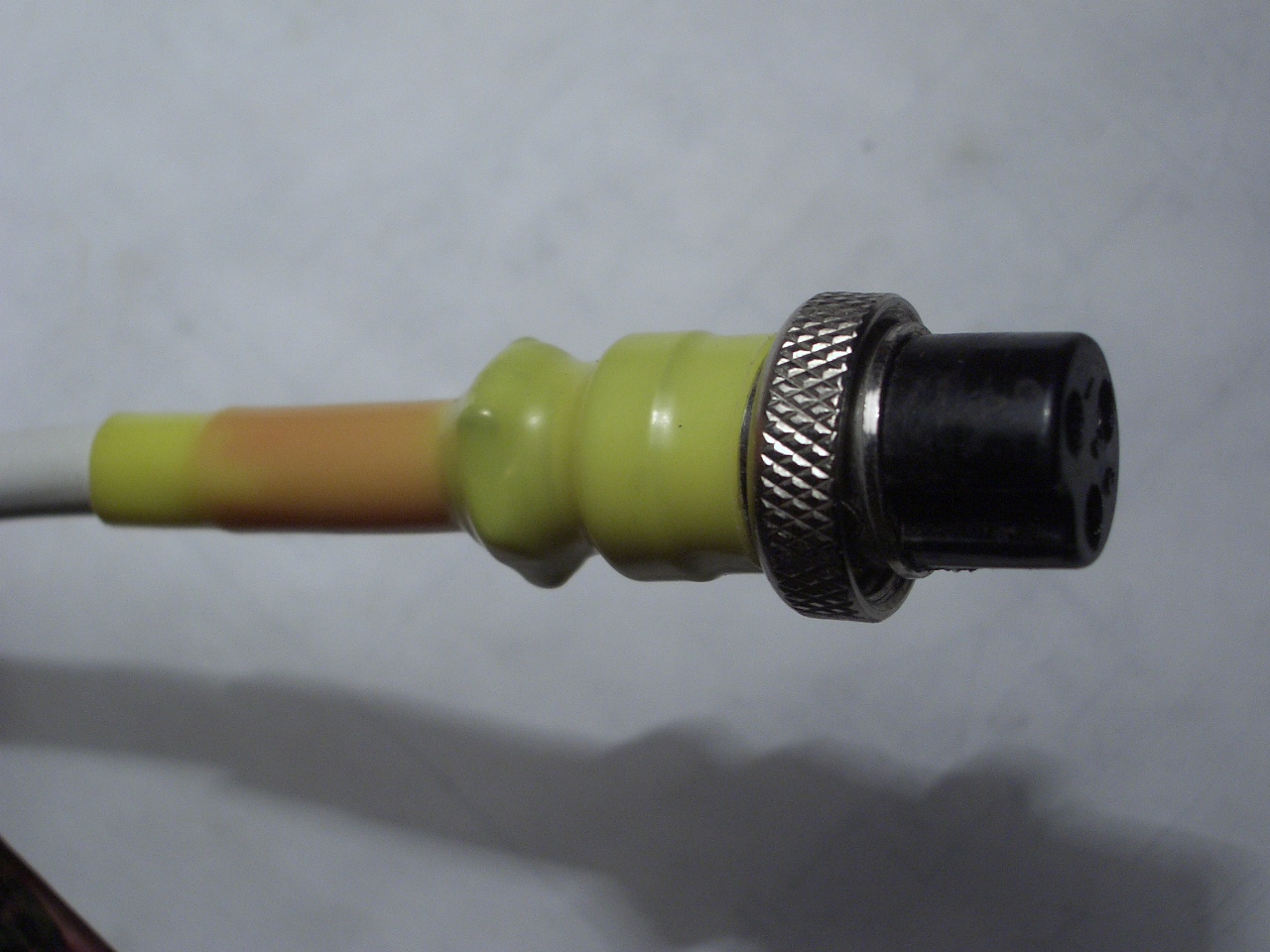

              i have a question
              what type of coil connector should i use??!
              tell me everything about it because i can't find it

                  thanks
                  what about the cable it self? anything special about it?
