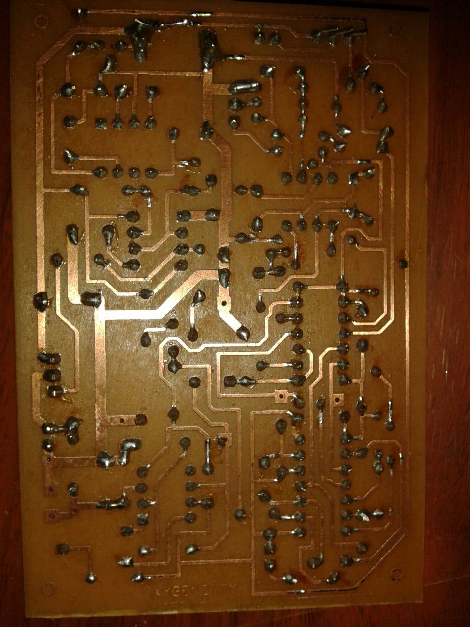

    i used alcohol and tooth brush to cleaned it
    should i remove the ICs and clean under them?
    Nooo, not if they're soldered. But I would pop the ICs out of sockets and clean there.
    I read somewhere else where you said your flux is "non-conductive". For that, you do not need to be as thorough in removing as you would if you were using the older style rosin flux. But you should still try to clean it away.
    • #62

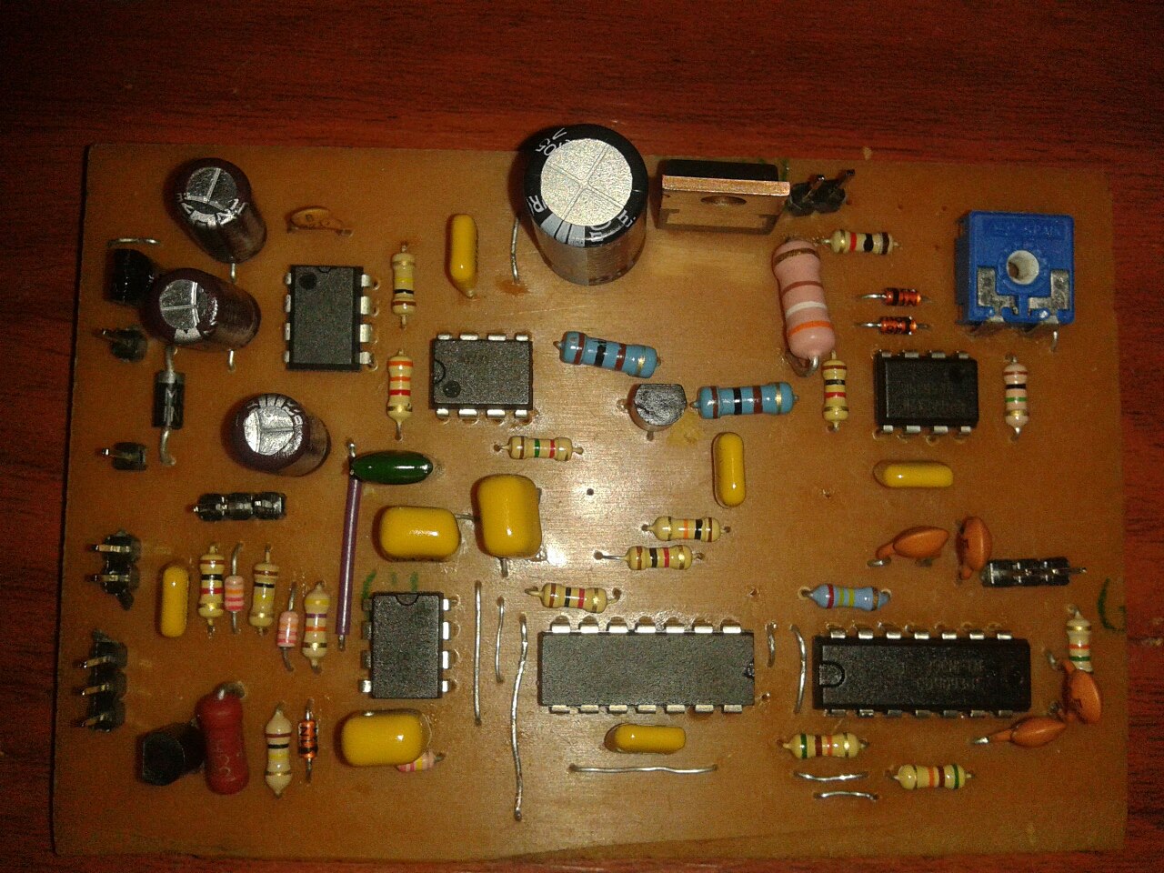

      GUys it works but with very low sensitivity
      and it keeps beeebing but when i move the metal near it stops beebing ( is that normal?)
      • #63
        Stop.
        Unless you have compressed air to blow the old alcohol or water away you should let your PCB dry for several hours or even overnight before powering it up.
        After that, make sure you still have -5V.

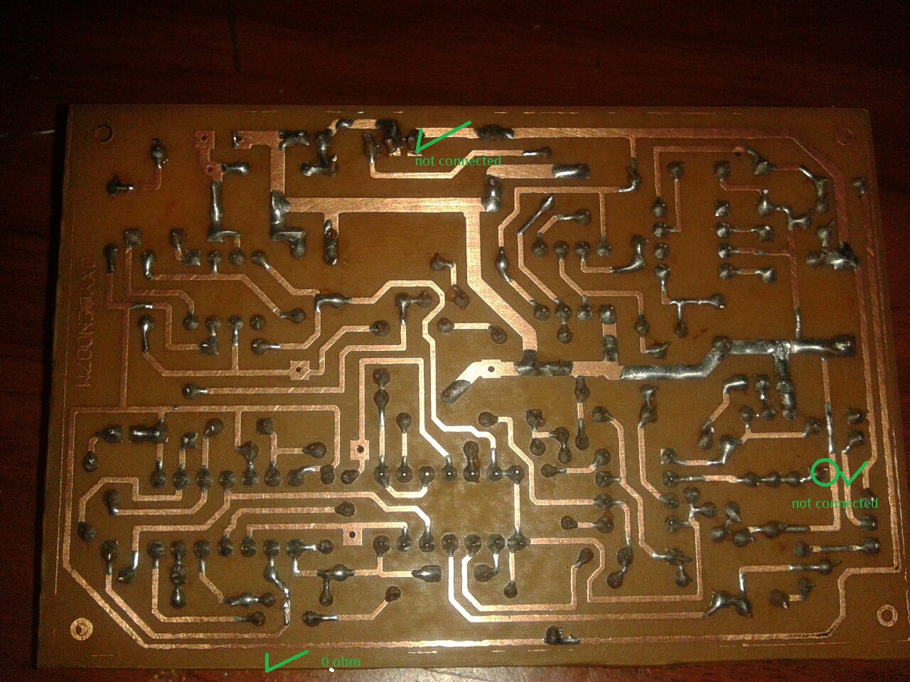

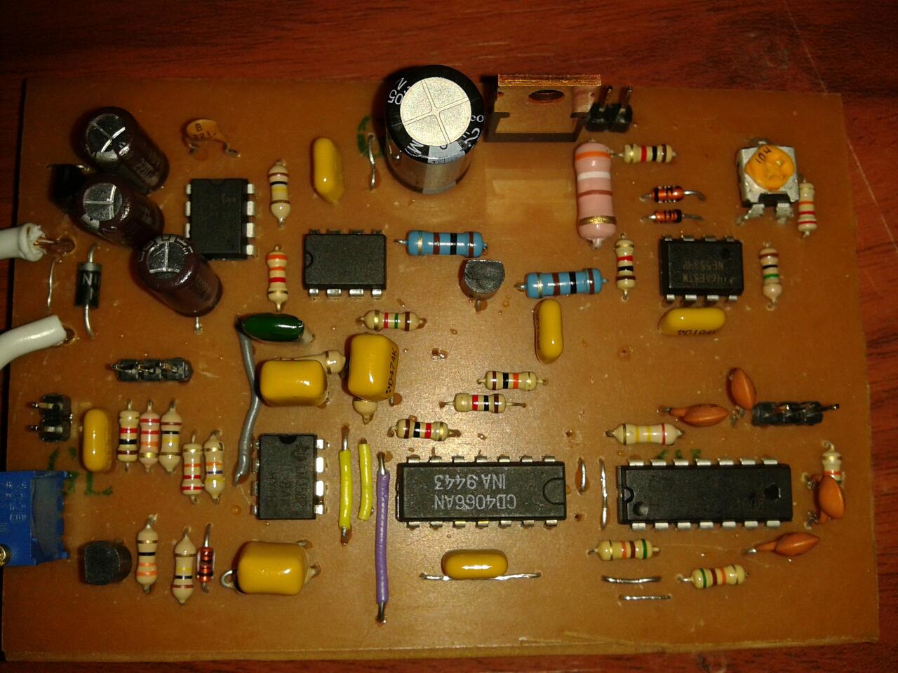

                                Guys i need your help again
                                what is wrong with board?!! ( it doesn't make any sound )
                                is there a difference between PH4148 and 1n4148?
                                and i used 1n4007 not in4001
