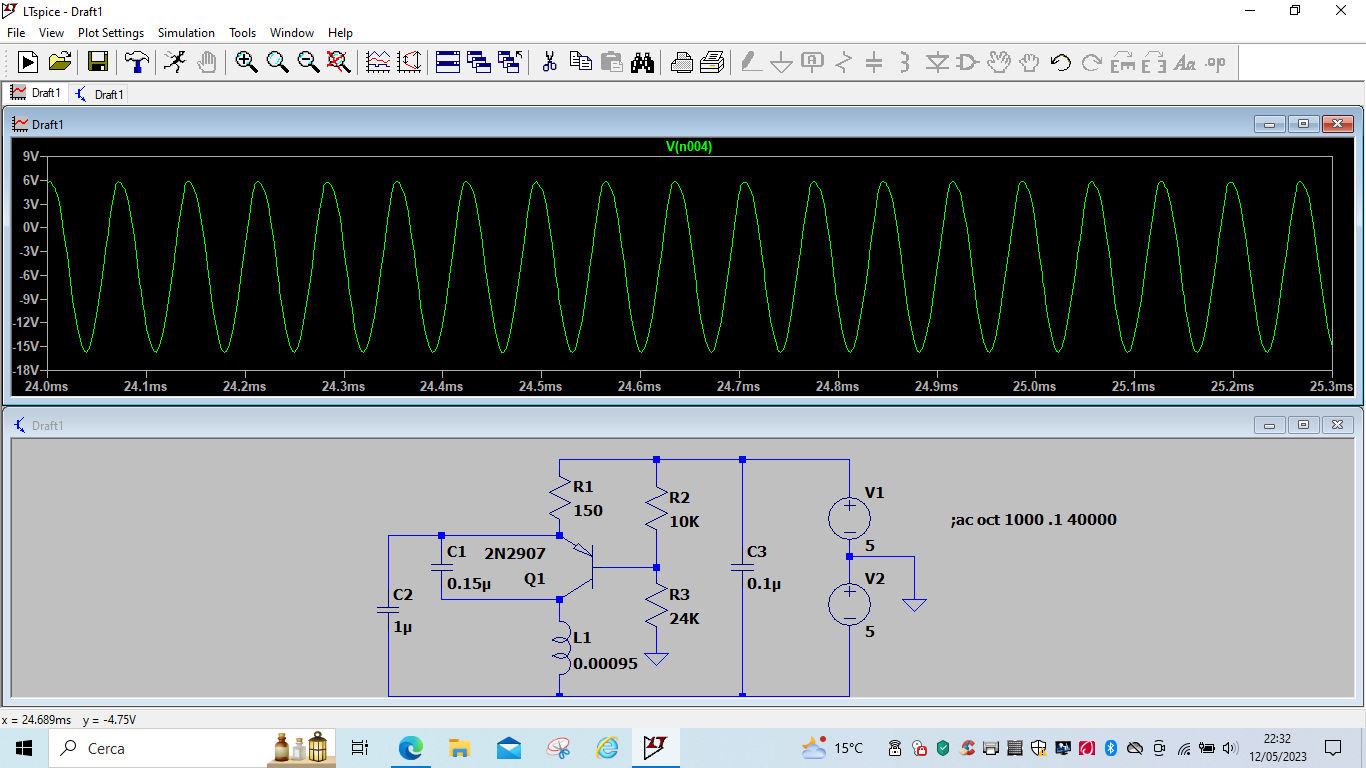

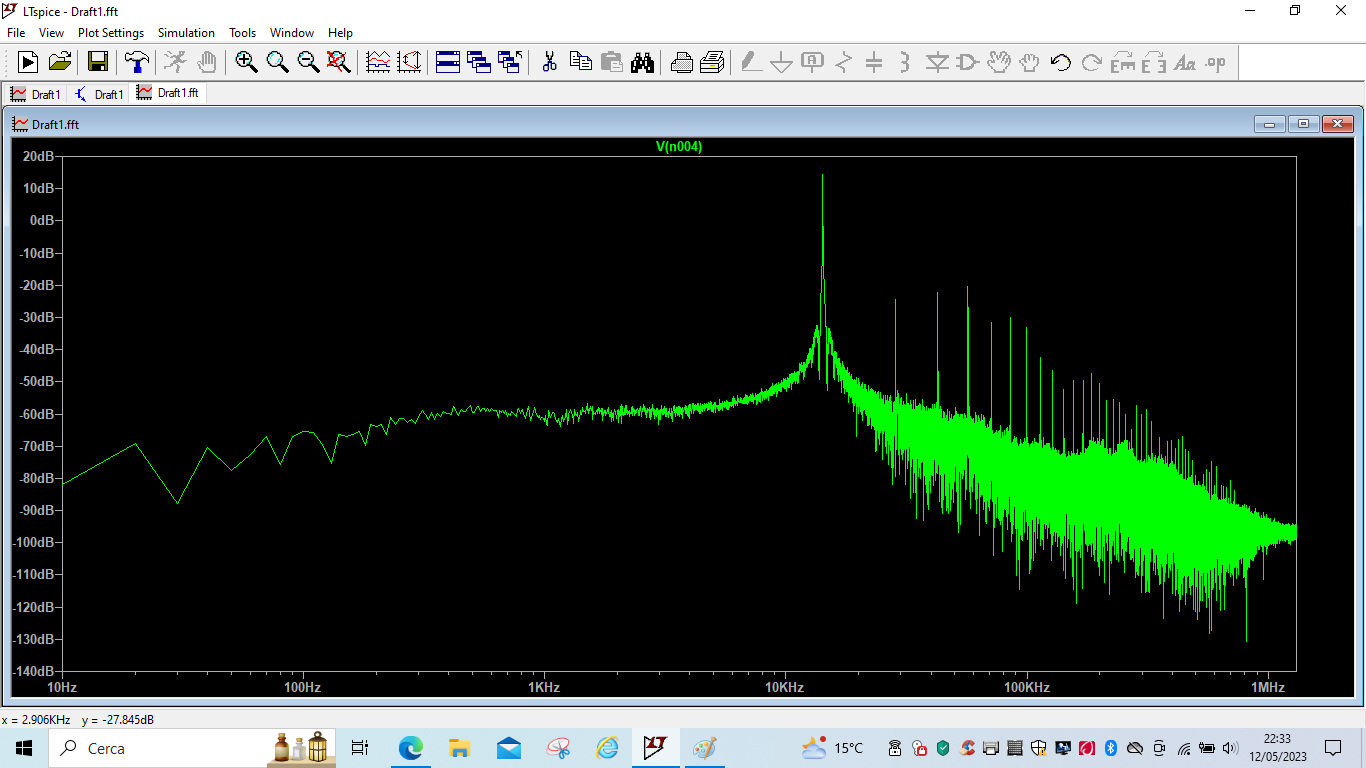

            • Originally posted by sled View Post
              I just run a simulation on the Cibola transmitter in LTSpice, it turns out it will oscillate at ~13.4kHz (resonance at ~13.6kHz) instead of the ~14.5kHz as the original Tesoro. I'm not sure if this is the way it should be.
              [ATTACH]36304[/ATTACH]
              [ATTACH]36305[/ATTACH]
              [ATTACH]36307[/ATTACH]
              Hi SLED,
              I don't have access to russian site, I can only read the thread.
              There is written:
              3,3 ΜF. -13,87 kHz.
              2,2 ΜF. -14,02 kHz.
              1 MKF. -14,55 kHz.​
              Therefore try to change 3,3uF with 1uF.
              Please, can you update the simulation? Thanks in advance.

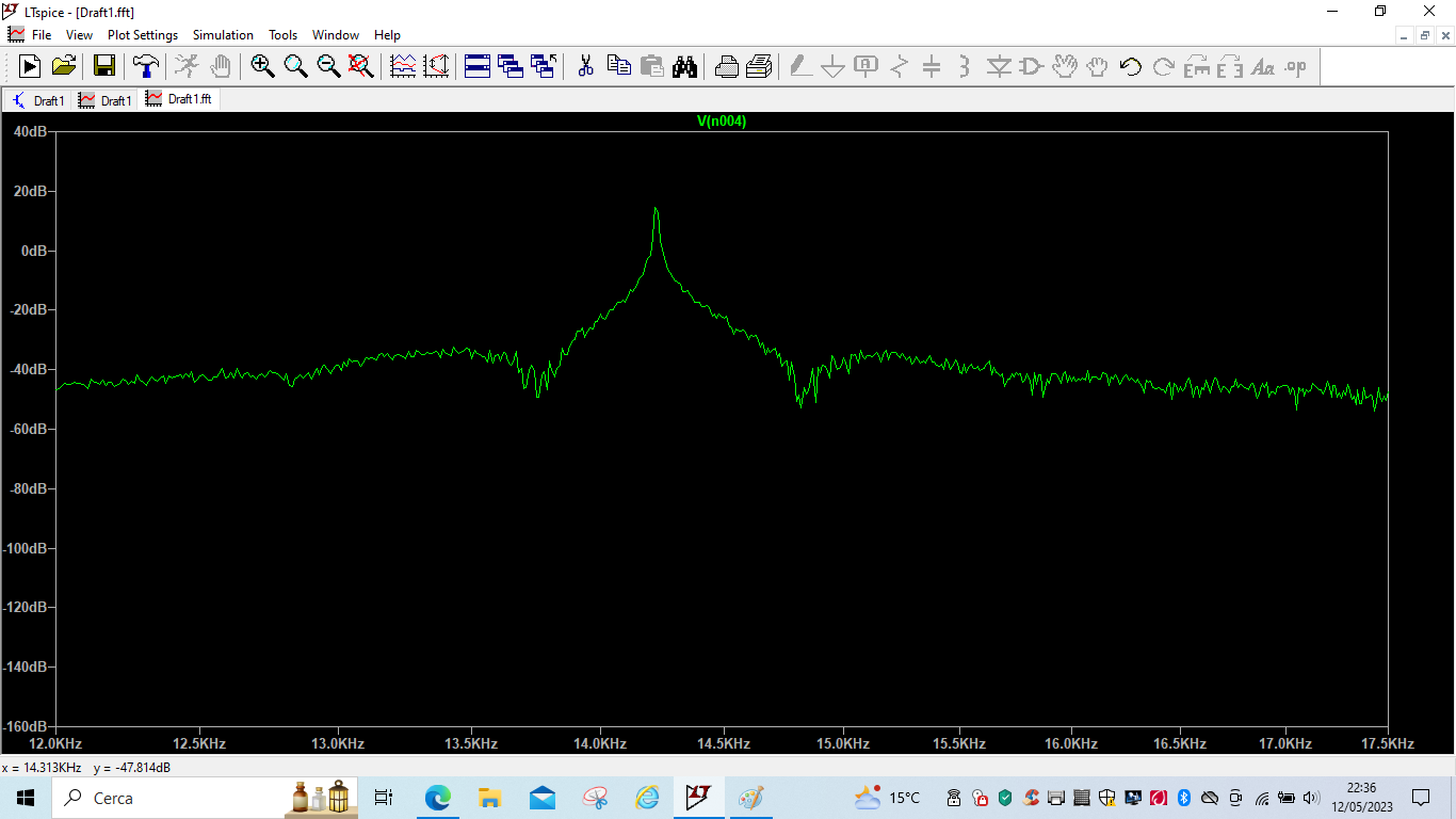

              • Hi!
                Running the simulator I obtain these results:

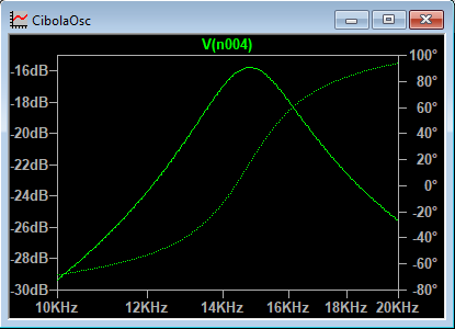

                • Click image for larger version  Name:	image.png Views:	0 Size:	14.1 KB ID:	412426
                  AC Analysis​

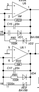

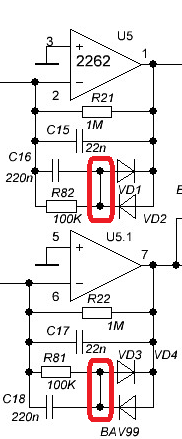

                  • Hi everyone!
                    I'm buying all the materials to make Cibola and I'm redoing the PCB.
                    However, I have doubts.
                    How exactly should the BAV99s be connected?
                    As
                    or this other way?
                    Furthermore, in all the diagrams seen, pin 5 of the 4053 (U12) is free. I think it should be connected to ground instead. I am wrong?
                    Please, can anyone help me?​
                    • This one is correct:
                      Click image for larger version  Name:	Img2_BAV99.png Views:	0 Size:	36.6 KB ID:	418517
                      Originally posted by Maurizio2 View Post
                      ​Furthermore, in all the diagrams seen, pin 5 of the 4053 (U12) is free. I think it should be connected to ground instead. I am wrong?
                      Pin 5 should be left disconnected.

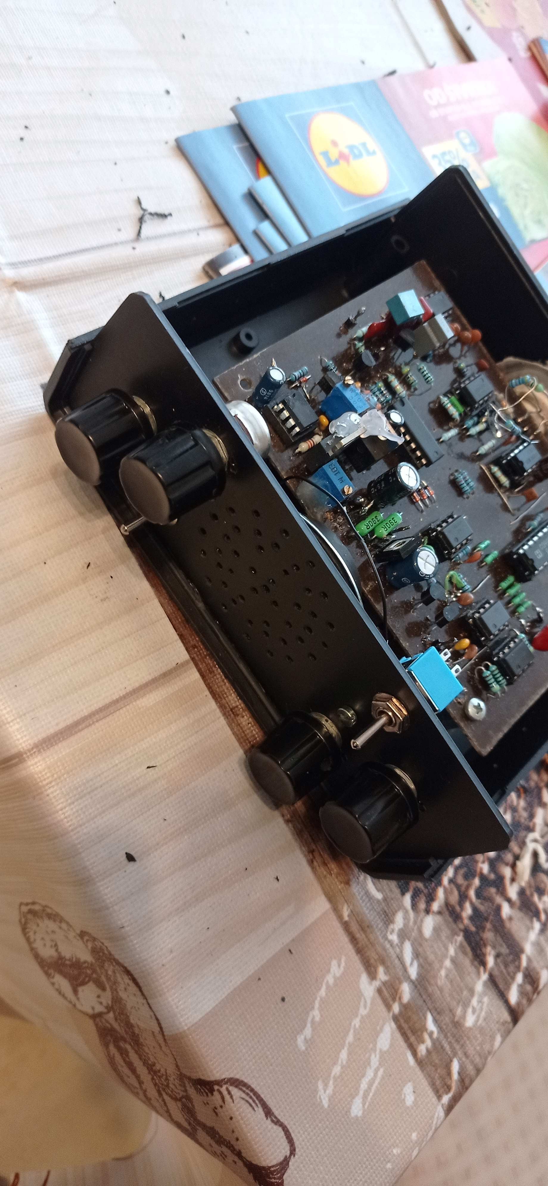

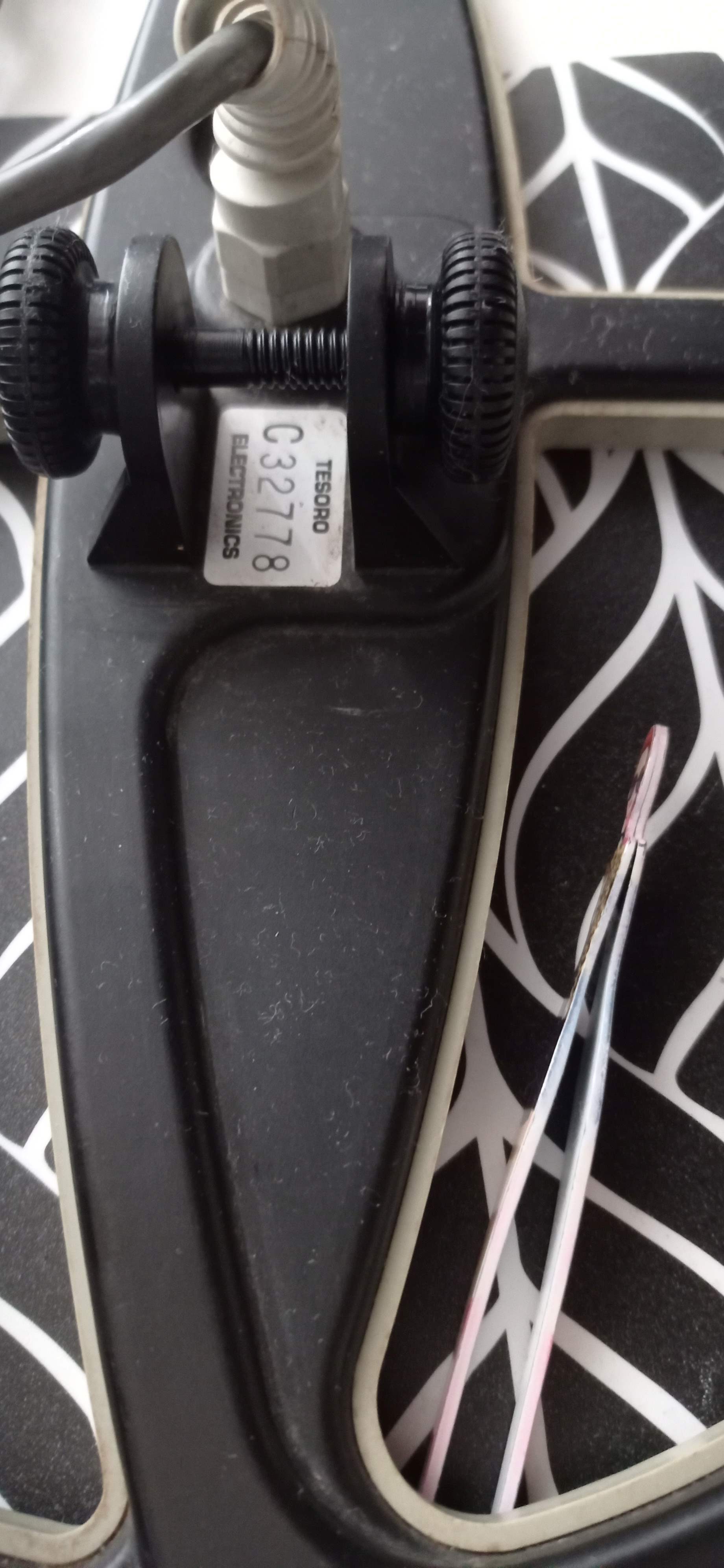

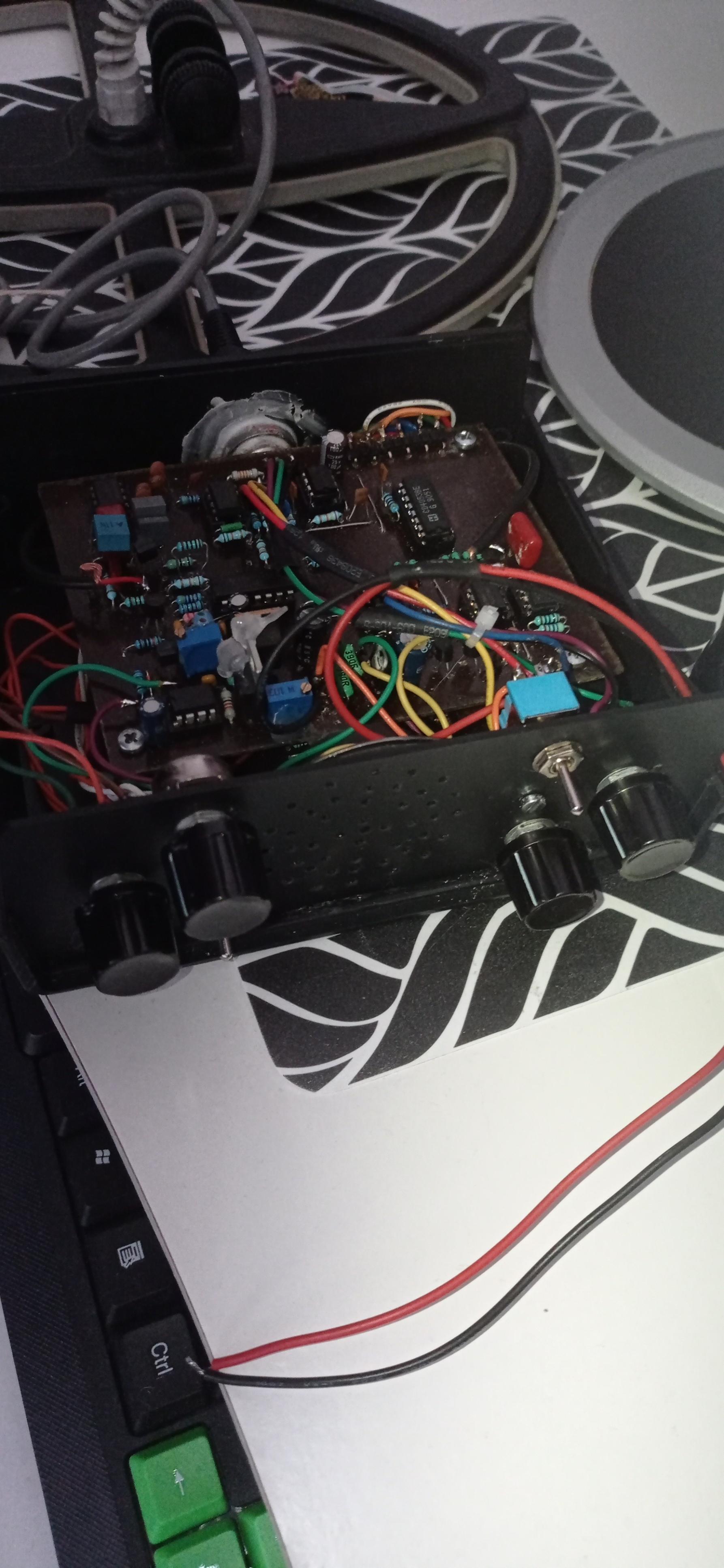

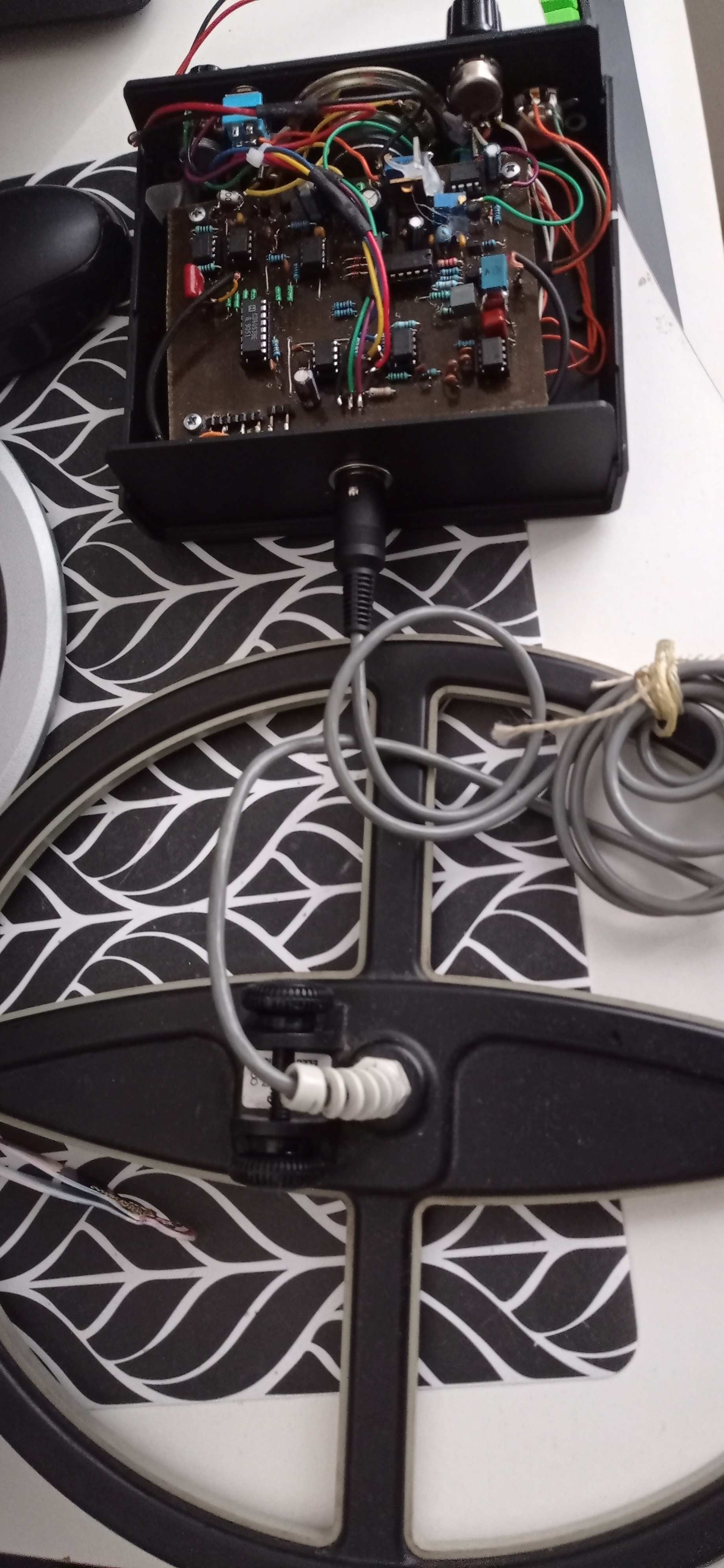

                        • my Tesoro Cibola detector
                          • Can you record short video demonstration and post final checked and accurate schematic?
                            • Hi, I also made a demonstration video of my test-
                              Code:
                              https://youtu.be/nqTAUujWWkw
                              user Evgen65 from
                              Code:
                              http://md4u.ru
                              forum gave me the materials for building the detector​
                              • No one has been doing such aerial *tests* for a long time. It is necessary to demonstrate the operation of the device in the ground. And not in artificial holes, but as it really is. You take the device and start walking around the field with it. Then we will see how good or bad he is...
