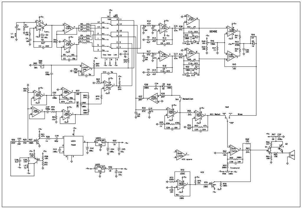

    Anyway, this schematic is full of mistakes, same as "Tejon" schematic.
    Will not work anyway.
    Good luck!

      Tejon is complete mess. Many pins swapped. Phase detectors&sync. demodulators are huge mess up.
      Many components values are wrong.
      It is pointless to name each mistake because there are many.
      Cibola too.
      Ok, for example; just analyze U6 and U6.1 at it and there is no need me to explain.
      U3 also.
      I don't suspect good intentions of the one who tried to trace it out; but it is not possible to trace it out and be 100% sure until all the components being removed from pcb.
      Because there are too many vias and traces hidden under the ic's and many of them can't be simply checked using ohm meter.
      I will not talk about details here because Tejon and Cibola are not discontinued models yet,
      those are still actual on market and i think it is simply against ethic to disclose their schematics here in public.
      But, simply; trust me, those schematics are not good and if you made them - they will not work.
      I don't want to act too smart here, just want to spare our friends here from wasting time and money on something which will not work.
      Cheers!

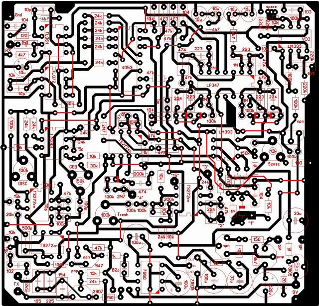

          hugo, wait the wind of change from east. I see these people they open Tejon and Cibola. really I fully desoldered King Cobra, all components were measured by my hands. this is why there is not mistake in my schematic althought Lahr's schematic has its a bunch. Ivconic is right - do not waste your time on very crude project. Christopher Kolumbus did try to discovery India, but open America. because he had not good detailed maps. that is the good example.

              hi Hugo, if the components are glued they easy get out desoldering. hot does its deal. I do not see difficulty. there is only maybe ceramic capacitors, you have to measure everyone, because they are often not marked.
              take all files you see in the forum - fixed diagrams, LAY of SMD, LAY of through hole board etc.

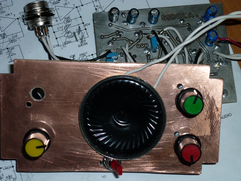

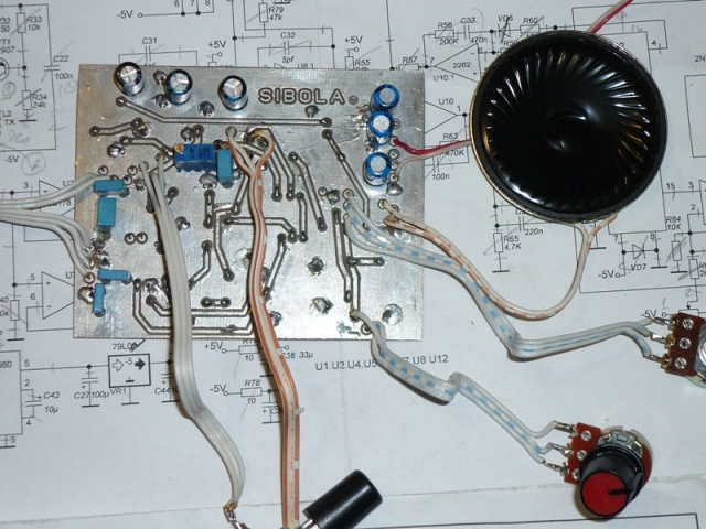

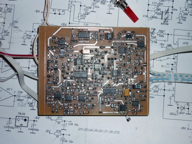

                  Fresh (and good) news from Russia :
                  Looks working fine.
                  Hugo

                    Not only looks working. The scheme really works.
                    The amplitude Tx = 25 V pp, pleasant sound.
                    Regards, GSL

                      Hi GSL,
                      Thank you for your work !
                      Have you fully test the board ? All-Metal, Disc ?
                      What is the detection range ?
                      Best regards,
                      Hugo
                      • #41
                        I have not fully tested the board, GB has not been adjusted. Modes All Metal-discrimination work. It is too early to talk about sensitivity, but there is good sensitivity to gold and silver coins.
                        Best regards,
                        GSL

                              GB adjusted - the device is well cut off the iron and ferrite.Click image for larger version

                                With additional infos that i got recently; i made corrections in Cibola schematic and finally made it.
                                There are many differences between "original" one and the one i made.
                                The one i made now is working indeed decent.
                                So far i tested it ONLY in DISC mode and therefore i can't claim anything relating to All Metal mode and Nonmotion.
                                I get decent air distances for various items.
                                GEB is working just nice; rejects all minerals, ferrite etc...
                                Disc is working excellent!
                                Treshold is working, Sense is working... seems everything is on it's place.
                                I couldn't obtain some of "original" ic's so i made series of checks and tests and established most proper ic's for present conditions that i have now.
                                Funny thing, but TL061 is performing very well at RX front end!?
                                Much better than a pile of other types that i tested!
                                I intentioanlly wanted to avoid second 4053 and instead i will use ordinary mechanical switches, by now i only made wire jumpers so to settle it only in Disc mode.
                                Also i intentionally wanted to avoid use of CD4024 and instead i used simple VCO taken from White's Classic schematic.
                                Without additional buffering; 7660 will not synchronize directly via resistive coupling so i used most simple method: capacitive coupling!
                                What to say? This thing is working and it is working indeed very decent!
                                I have original Tesoro coil (for Tejon, Cibola and Vaquero) and all the checks i did with it.
                                Cheers!
