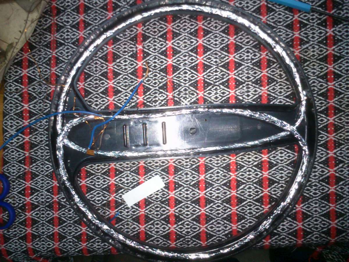

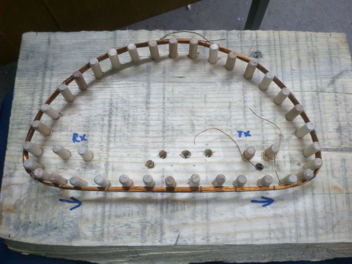

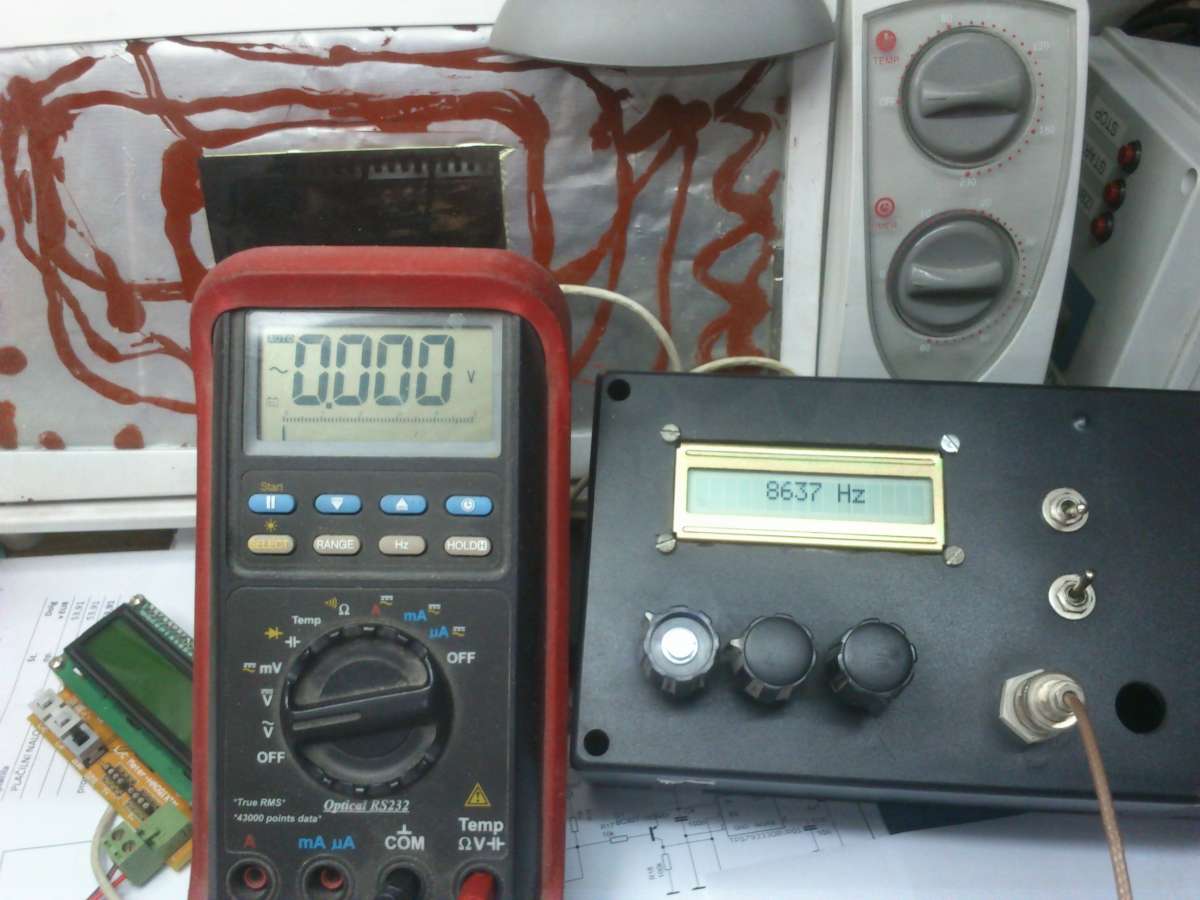

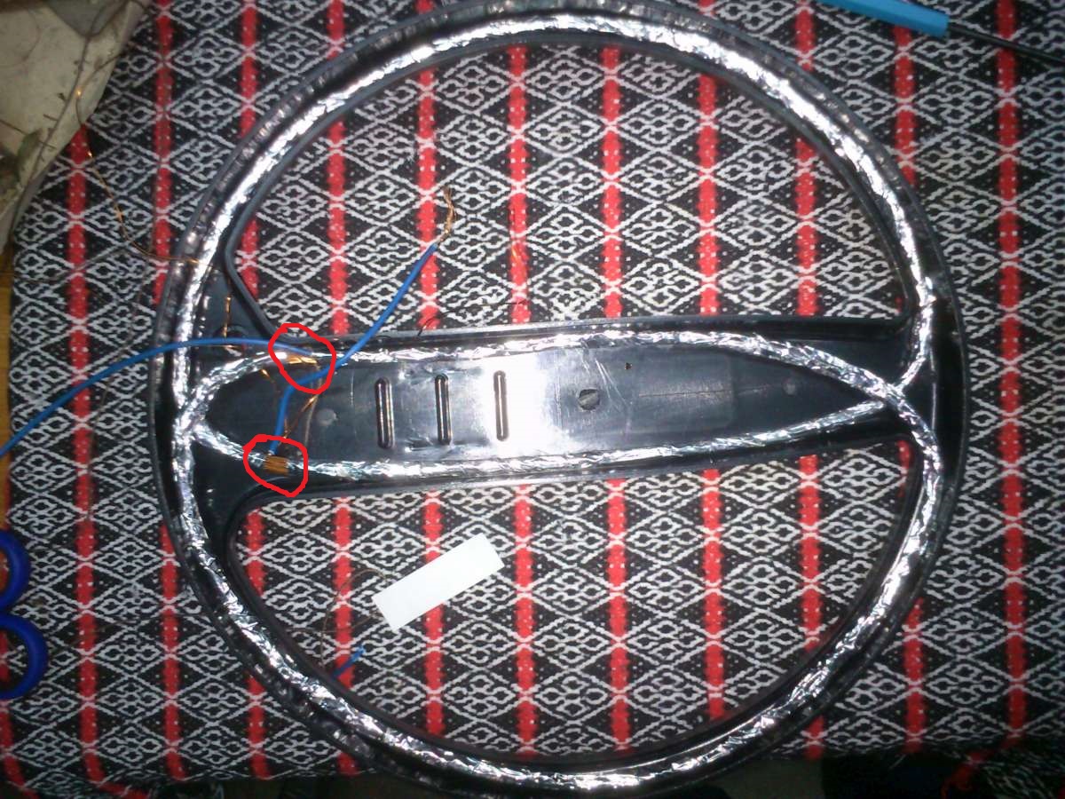

            • Today I made my first coil. Hope it is everything OK. I use sinus wave generator at 8.5kHz for nulling. At final I got 0.000VAC
              Just before I put over epoxy glue I ask you it is OK like I do this?

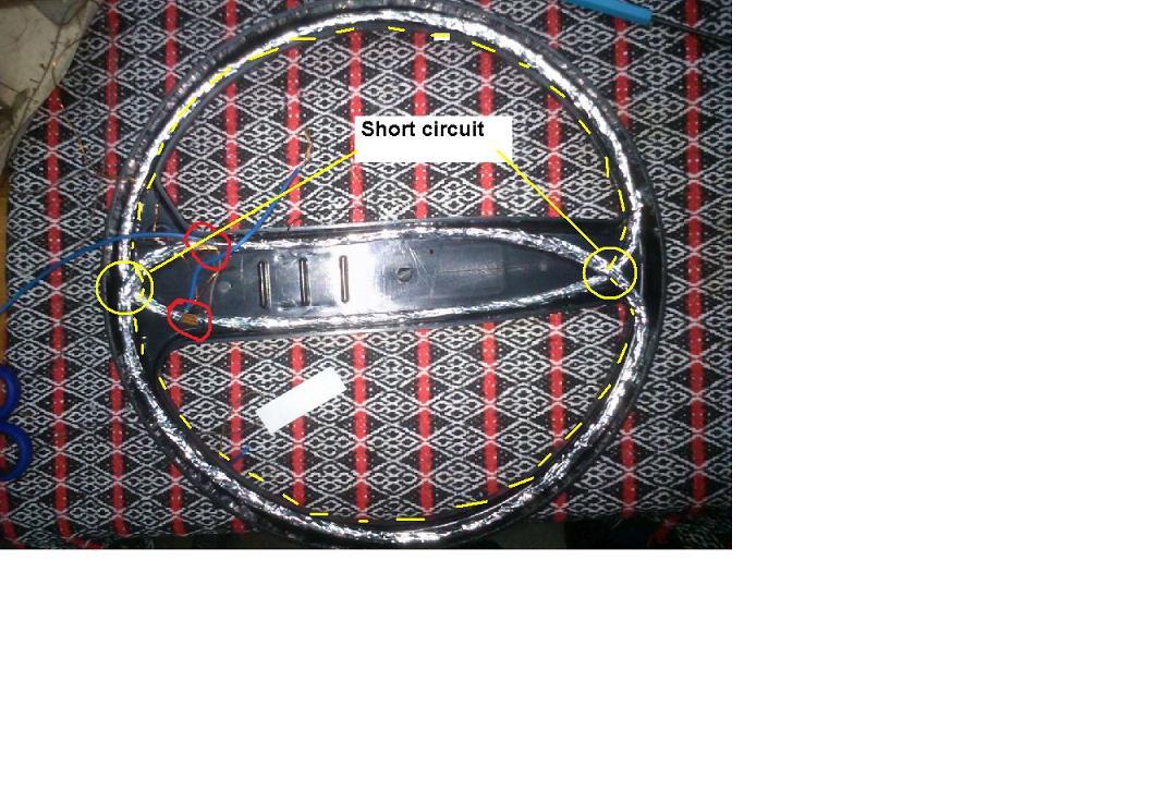

              • Good work Simon, congratulations.
                Seems except coils shielding. Shielding should be made with small gap and not in closed circle.
                Like this:
                Additionally, author last suggestion was to best tune coil at 8kHz.

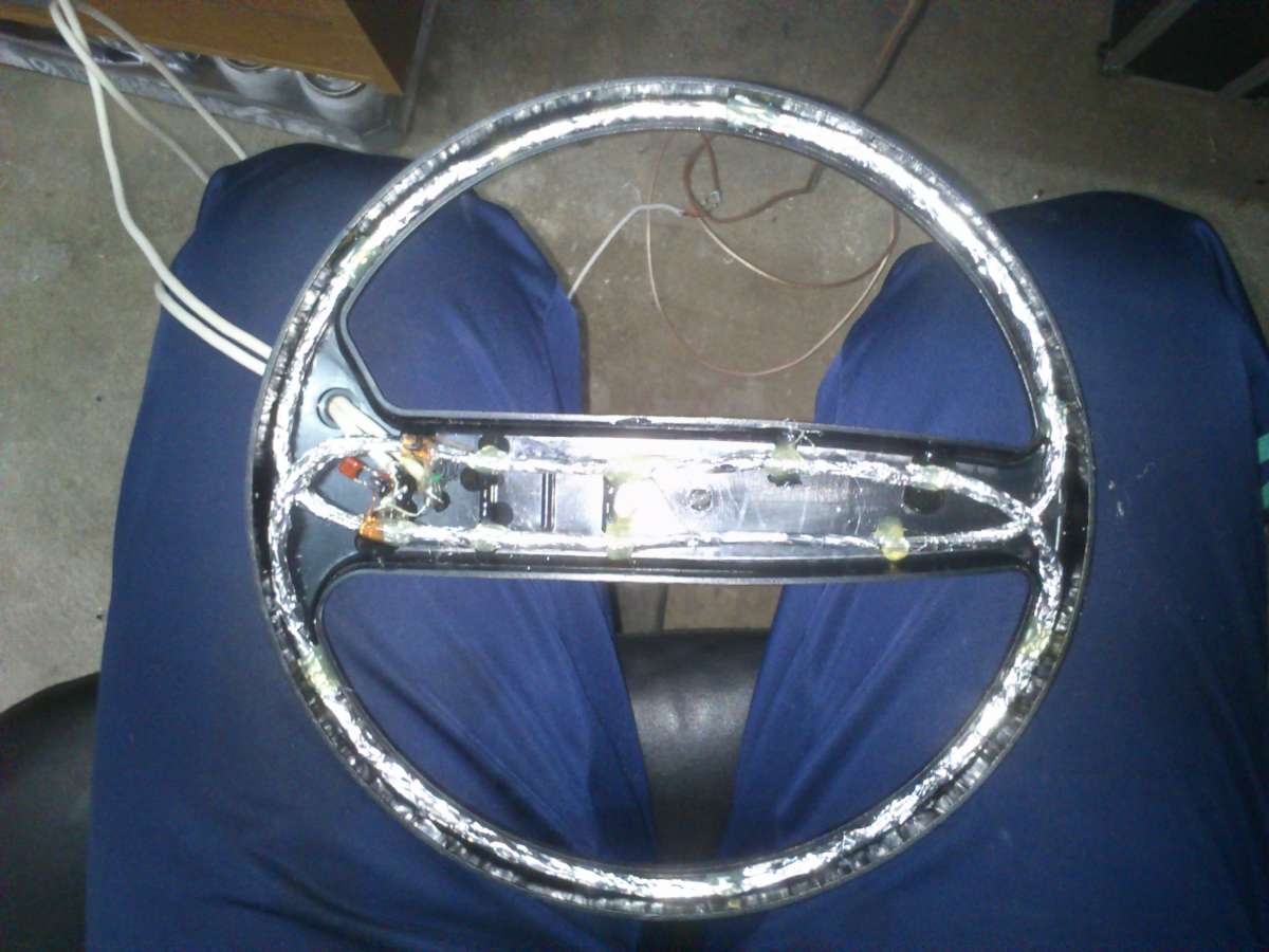

                • Thanks!
                  Yes, I coil shell do have gap. Only photos are low quality (phone..)

                  At author page I read, that tune must me done obout 8.5kHz (8-9kHz). OK this is not problem to change.

                  • Well done!
                    Probably authors frequency recommendation changes with last version of software code, but 8.5kHz should be OK too.

                        • I do as you show. I disconnect grounded, but nothing better.
                          Same valute of error
                          • Who is the DC resistance of Tx coil??? Maybe you have a short with the foil.
