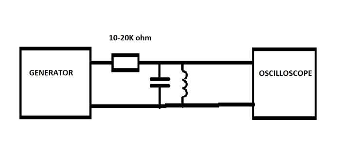

About 240 mv , When Im adjusting the coils, if you just breathe it will change drastically. I built a LC meter(ABO) designed by AndrewK2, and it has a frequency generator built in, I wonder if I can use it with a scope to determine coil resonance.
Set the frequency of the "ABO" generator to find the maximum amplitude on the oscilloscope.
