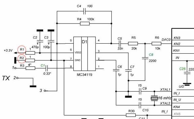

                • Hi,
                  may I ask what the purpose is of R1 and R2 in the schematic (red circles) ?
                  If I want to use a different TX frequency, do I need to adjust the RC input filter R6, C8 ?
                  • Happy New Year!
                    Red circles do not matter. The frequency for each coil is given by C1.
                    • The last schematic of "KPOT2" shows C1=220nf,can you explain reasons,thank you for reply.
                      • Comment
                        • C1 value is related WHAT type coil you use. you have to learn what is CURRENT RESONANCE and what is VOLTAGE RESONANCE.
                          then you ll get answer.
                          if you use VOLTAGE resonance coil you put C1 with MAX value you can.
                          if you use CURRENT resonance coil then you have to SURE TUNE C1 value. that is why C1 is written with (*)
                          ie it means in russian schematics 'tune its value' in concrete this case 'tune it on the resonance'.
                          • Latest Mole2 schematic
                            Now I am confused! Ive noticed on the latest schematic a change of C1 to 220 nf, C0 changed to 10nf, and C18 in D2 amplifier changed to 22 pf? or nf? Are these changes related to the latest turbo3 firmware for use at 10 khz?
                            • Yes, it is setting the receive path frequency response at 10 kHz
