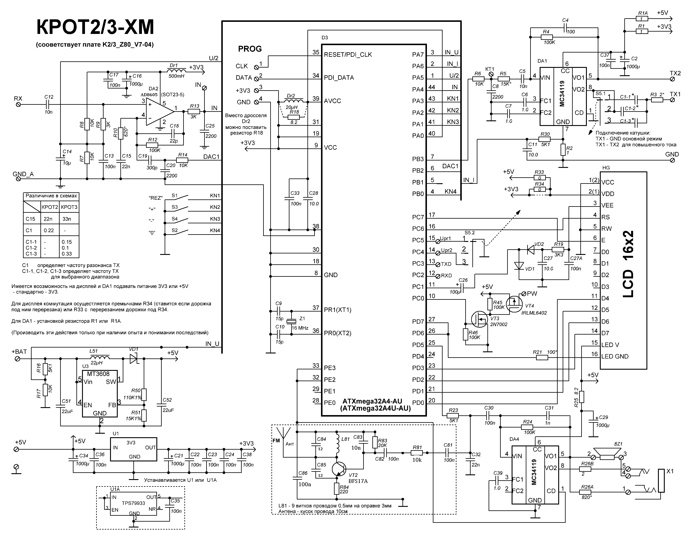

'KROT2-XM' (mole), new project Xmega32

      • this is the latest version. 1 frequency. If desired, add Upr 1 Upr 2 and 3 position selector capacitor .

              • K2-FAST-S4 from 11.07.2017 last free hex . Contact the author for a key . Raiting hex are paid.
                • thank you timekiller very much . you mean I have to ask him for a key even for free hex????????
                  • RAITING are called new paid hex versions for mole2xm . Old are free. One key works for all versions for one MD
                    Paid hex start in demo mode 2 hours.After entering the key this mode disappears
                    • so I don't have to use any key for free hexs tank you very very much brother timekiller
                      • I know the first version is free but until which version is it still free without restrictions?
                        • old until what version? regards--

                              • Hi, I don't understand why few do this project, of all the vlf projects that I have done, this has been the most stable, the deepest ... very stable even around appliances, electricity towers ... 35cm underground for a gold ring 5 grams - even very expensive commercial models cannot do this.
