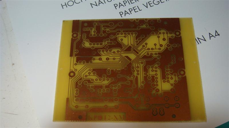

                  • #54
                    And the pcb for DIP version....
Name:	DSC03967 (Medium).JPG
                    • #55
                      Very nice work Geo, even with fine lines.
                      • #56
                        Thanks WM6.
                        At afternoon i made another one as spare .
                        But i can't see C23, C24 and zener D4 on both pcbs smd and dip version. Why????
                        Maybe smity knows....
                        • #57
                          C23, C24, are placed near sources of energy consumption, ... A Zener diode is a "foolproof" ... You do not have to put ....

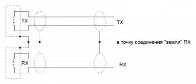

                            I will write at once, so you do not have a question. Transmitting coil is connected to pin 8 and the ground. Cable to use separate screens! This is very important!
                            • #59
                              Hi smity, I do not understand this.
                              Where cable screen neeed to be connected? At which point in schematic?
                              • #60
                                Screens TX and RX in the cable are separate. Connect the screen to the printed circuit board in the receiver.Click image for larger version
