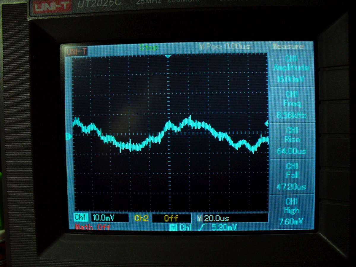

  • Put ch2 at 10 or 20mv and try again. You must read lower than 10mv at Rx coil. At my coil i read lower than 2 mv p-p.
    Good luck...

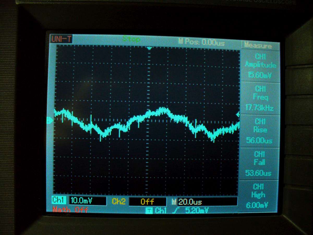

    • Hi Geo
      Huh, this is not so much easy
      I cannot come under 16mV PP or is something wrong with my coil or??? It is so, so delicate. Just move for 0.5mm and signal rise or fall for 10-20mV
      Is this normal????
      • You must read less than 10mv p-p. Fix a little the coil and try to make a better null. Fix at better null and then try to make it better by pressing a place of the coil that it is not so active at null (as at corner)

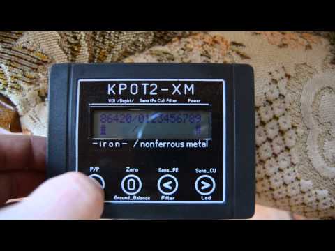

          • My first test
            • Congratulations, but you have n't showed at who distance it detects the coins
                Distance about 32cm.
                • Ropcsika Congratulations! you are the first who managed to do here. Or am I mistaken?
                  "Coil bl" mode the game is intended for emergency corrections information. Ideally A = 0, Ф=***. You have not filled in the coil so stavte А = 0! To do this, press the "+" and "-" buttons. You Gain = 1, unforgettable by decreasing the possibility of it! Good luck!

                    Ok ANDREW K2, i try this. Another in the video is, a=390..
