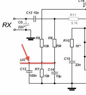

                    Yes on the website of Kpot2 it says "Voltage at PIN 1 and 44 of the microcontroller should be about 1.6V!". Also measure it between R7 and R8 (I've marked it in red on the schematic here: Click image for larger version
ID:	340005). Proportion is important, but 10k is a good value, if you have a handful of 10k resistors, pick two that match each other in value.

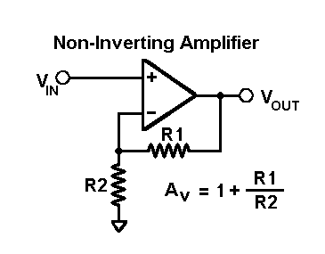

                    R10- this one don`t understand well. What should be proper gain?, You mean C18 of course
                    It's a non-inverting operational amplifier configuration, with frequency dependent feedback because of the capacitors C15 and C18.
                    See this as example:Click image for larger version
                    Av is the gain of the amplifier. In our case we have a complex impedance R1 = R12 || C18 and R2 = R10 + C15.

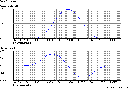

                    This is an active band-pass filter with gain. At the center-frequency of ~10kHz it has about ~40dB gain.
                    Here is the Bode-Plot: Click image for larger version
                    You can calculate this on your own using this web tool: http://sim.okawa-denshi.jp/en/opampkeisan.htm

                    R11 serves no purpose I think and can be removed, maybe it is there to minimize the input offset so that both inputs of the op-amp see the same impedance, but not sure!

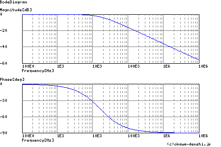

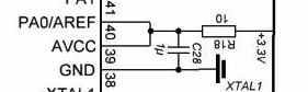

                    R18- I know that there is no "*" but Andrew wrotes about this resistors to few people,and with Kpot3 there is no R18 just a 33uH. But ok, I should measure noises at those pins (40,39,38 ) to get them less match value of R18.
                    Turn the schematic 90 degrees and look at it again, it's a simple RC lowpass filter see here: Click image for larger version
                    Again you can use the awesome tool here: http://sim.okawa-denshi.jp/en/CRlowkeisan.htm
                    It has a cut-off frequency of fc = 15915.4943092[Hz] with a -20dB slope since it's a first order filter: Click image for larger version
