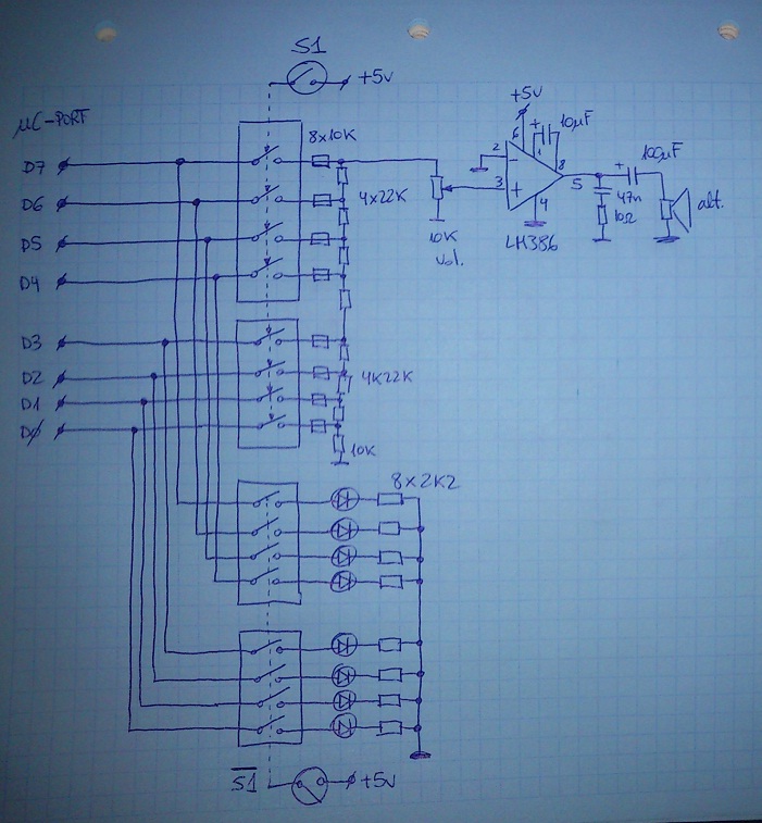

      How did you wire up the 2xBC556 ?
          __________________________________________________ _________
          It's easy.
          Based to base, emitter to emitter and collector to collector.
          I used this method for the construction of TX for 80-40 meters.
          With 4 x BD 135 got 14 W cheaply.
          It is better to use a higher power transistor instead of several in parallel.
          The small advantage is that if one is damaged and is not shorted, the system continues to operate.

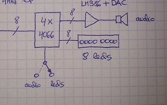

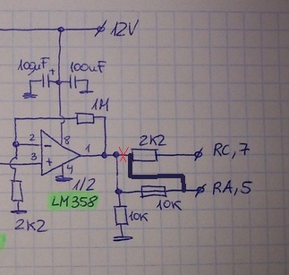

              Hi alber_gold
              would it be possible for you to please expand the circuit details in this part of the schematic ?
              thanks
                Hi alber_gold
                thanks

                This is what was missing to explain.
                Remember it is only TEST.
                Not worth mounting. Just to experiment.
                It is better to use the PWM output of the mic.
                With the DAC output frequency to the 386 is very low and sometimes annoying.
                In the other photo is a rectification. You have to connect either micro or he receives about 12 volts and does not like. :-)

                          You say that It is better to use the PWM output of the mic, does that function already work ?
                          or do you need to change the hex code ?
                            The PWM function does not work in the code attached. This code is a minimum and only to start the investigation. Sorry.
                            I comment in the thread that is better to use PWM and not use the weighted resistor DAC.
                            To use the PWM pin should be used RC2/CCP1. This for model 16F873.
                            That would connect the input pin 386.
                            If you set the PWM is confusing, you can catch the ADC value (only 8 bits for example) and create a function that delivers an output proportional to one pin of the PIC, for example pin RA, 0 (PORTA, 0).
                            It would be something like this:
