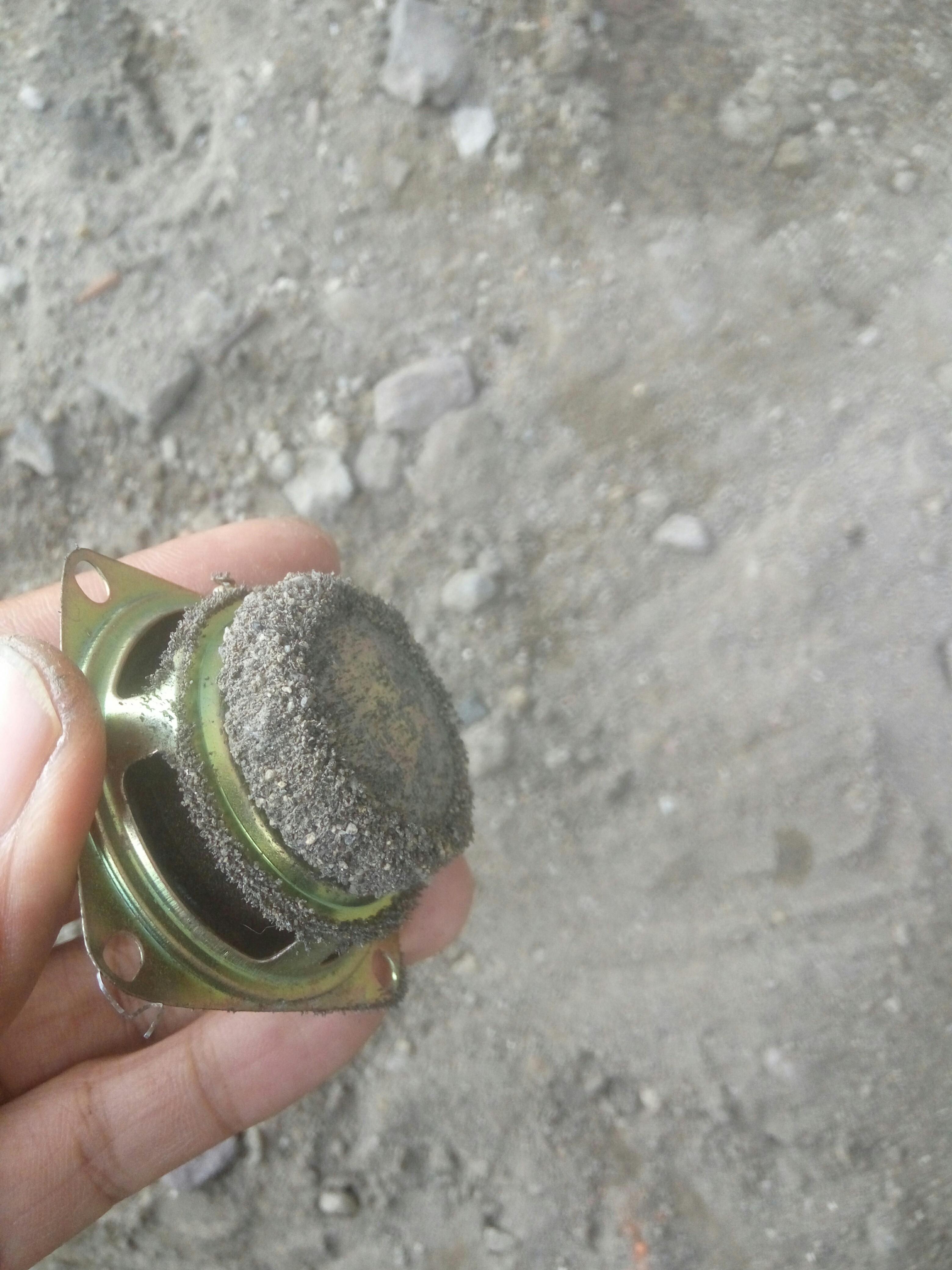

                  Yes, i use malysh FM2 ver 2 with 2mh coil, eddy17 says maybe i have high mineral soil, all iron sand will pickup by a magnet, all my detector always beep on first contact with the soil.

                    i can show that with magnet on any sand - thats normal. you do something wrong. shield
                    a space inside box, around the pcb. connect the shield to the ground. both points of shileding must be in one point -
                    from coil and from housing to the batts clemma.

                          I think the mistake is that looking on the street outside your house. Such places are usually highly contaminated metal waste accumulated there over the years - nails, beer caps and others.
                          Go somewhere outside the village there and try to see what will be the behavior of the detector

                            Let me try later on padi field... I think the result will be same, my front yard is lots of nail but not in every cm, every 20cm maybe, same result on tile floor.

                                Malysh 's principle is a measuring of freq deviation and certainly you get that if you put down the coil on ground.
