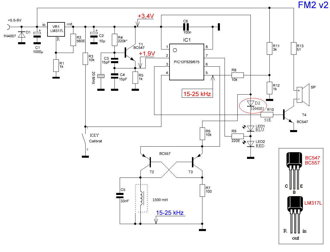

  • I have made two malysh pinpointer with both suggested chips, 629 and 675. With 675 the detector is not stable enough running, to use in the field, both LED's are blinking. But with 629 I realy like to use it on the beach and field. But malysh is not useable in ground with high mineralisation, like volcanic ground.Here is my digging tool while air test and with 629.*https://youtu.be/-Yhz2j0fwno

      • Originally posted by blobber View Post
        For not blink both LEDs enter diode (D2 1N4001) and everything will work OK.
Name:	__FM2 schema.PNG
        Gaby.

                • i have make this but not work maybe im not doing good on board or what ever
                  • what type of capacitors should i use for best stability? polyester, polypropylene, metal/paper, tantalum?
                    • I use mkt capacitor in tank circuit, also I tried different values for C2 from 15-33nF. Also my units was not running good with 20 Mhz quartz crystal. While experimenting, I changed to 16 Mhz, with better results for stability and startup.
                      Also Gaby's recomendation to add one diode, was helpful.
