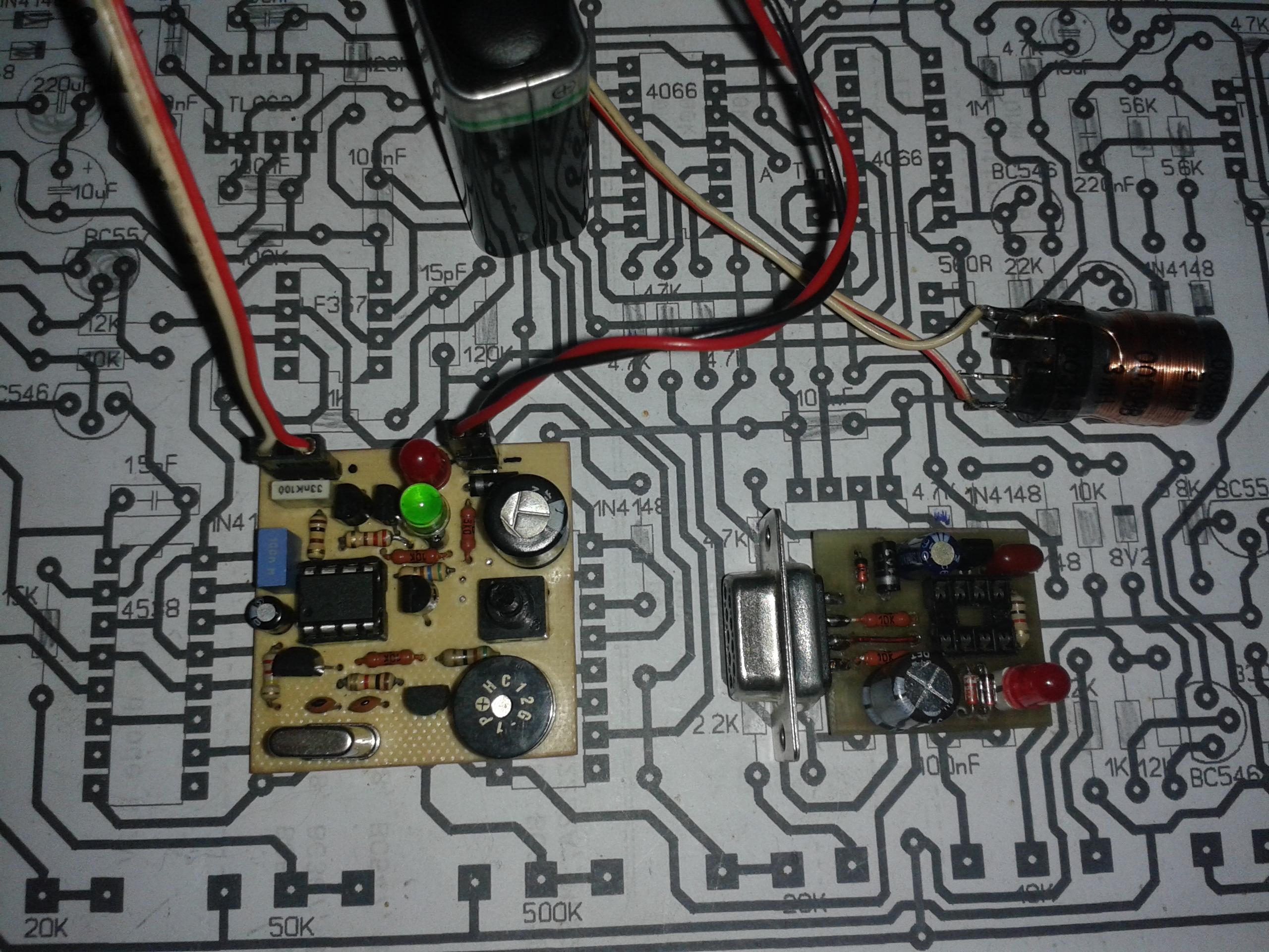

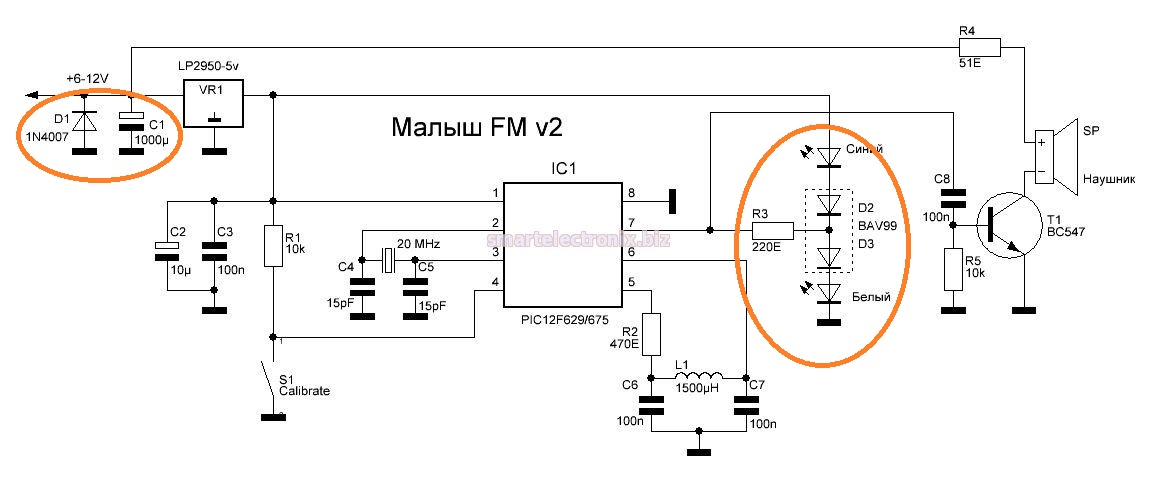

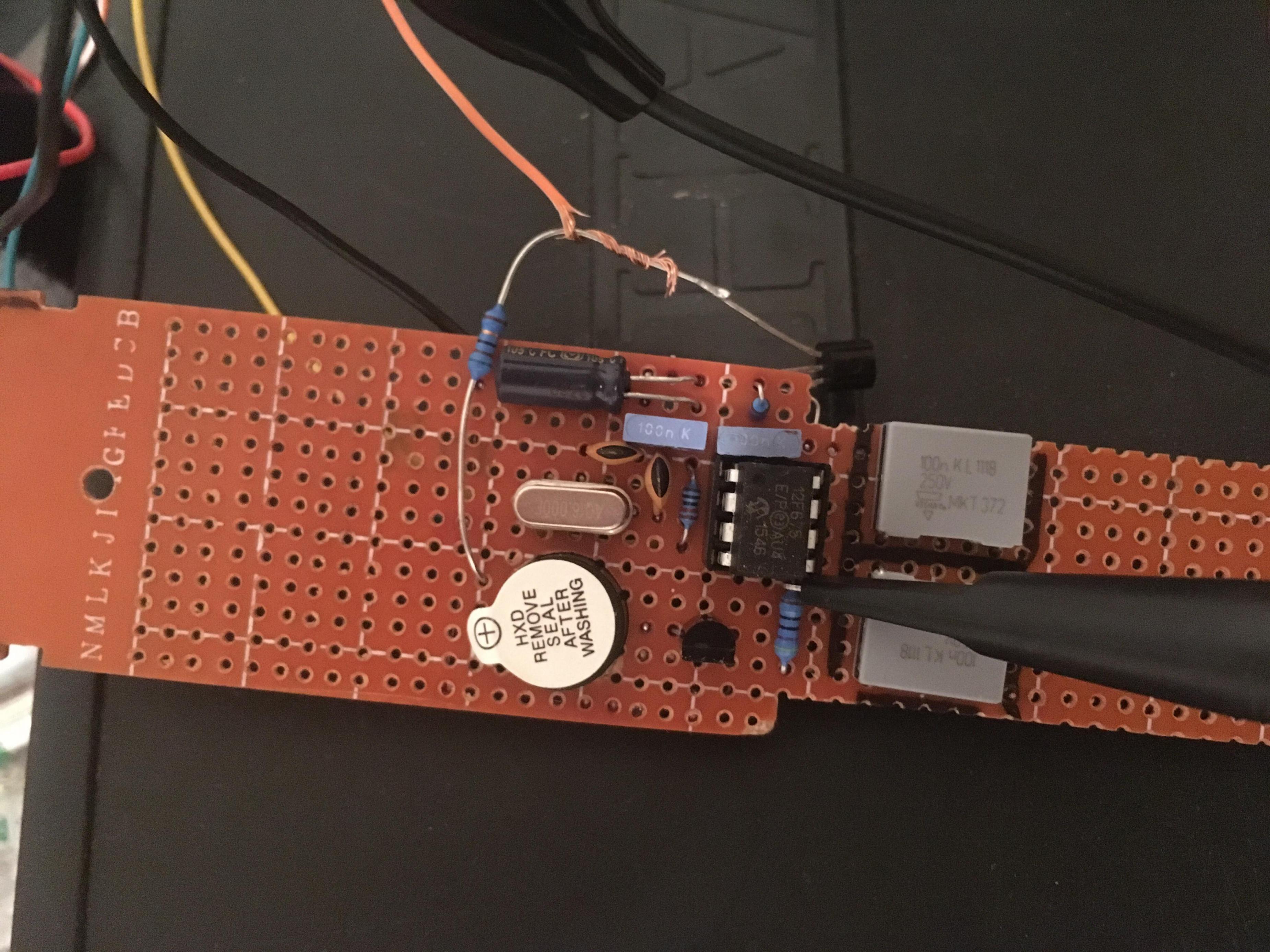

        • I finished malysh fm v2 like in schematic. i did not mount the led's and cap/diode from red circle. pic is 12F629. (i don't find hex for 12f675 fm V2 ) When i connect power it beeps once, when target is approached to the coil i can hear only one click and then nothing, no more click. After less than one minute it's making another beep, like autocalibration. Calibration buton works also. I think the PIC programmer is ok.
          I tried also 16Mhz/20Mhz quartz. Two types of coils (both 1400uh-1500uh) diam 5cm 0.3mm wire and 0.15mm (not shielded).

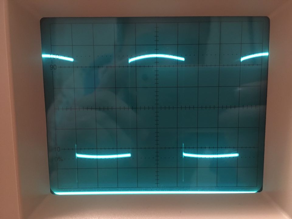

          At pin 5 i have this oscilation, my calculation is 19khz.

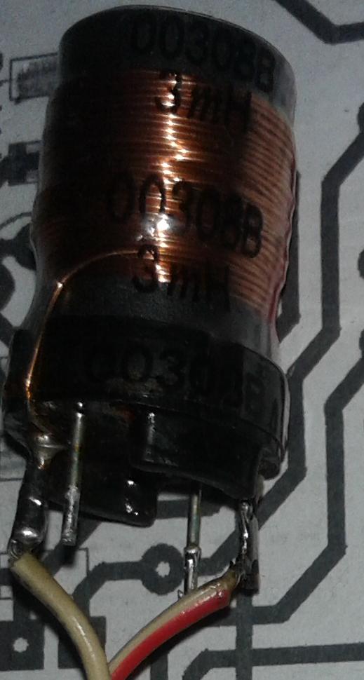

              Is it ferite core n the coil? I've heard that with ferite will act like a compass.
              • I used a ready made coil. He was on a ferrite core and we recovered from a old TV. It has a value of 3mH.

                • use AMS1117-3.3 instead LM317 (delete R1 and R2).
                  in package SOT-223
                  • Originally posted by gaby_sult View Post
                    [ATTACH]41706[/ATTACH]
                    The coil on the ferrite rod is very sensitive to the magnetic field of the earth

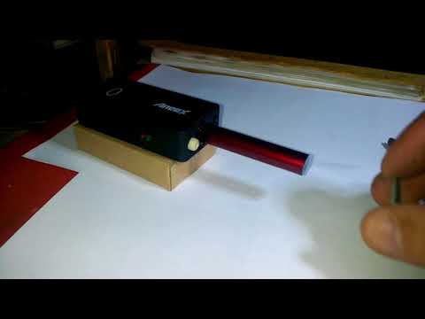

                          • and in use...
