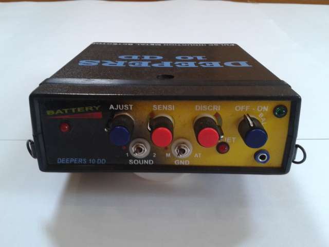

                  • Hi Maikel, could you please tell us about the DD coil?
                    Take care
                    • inductance, winding, and so on
                          • I don't have data for DD coils, the original is made from litz wire, You can make a DD for deepers, only keep the 2,5 ohms, inductance I think is not so critical. Use a compounded wire using 4 or more enameled copper things wires for simulate the litz wires twisted, the two coil must be identic and overlapped with D shape approximately.
