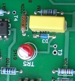

              • D3 BAT? is not BZX
                • Originally posted by daluka View Post
                  Resistor 0 ohm
                  [ATTACH]44296[/ATTACH]
                  D3 BAT? is not BZX
                  Thenk you daluka.

                    • KT315 KOMPLETUHA OK ?
                      Q1 7909A
                      Q2 2N3904
                      Q3 2N3906
                      Q4 L78L06A
                      Q5 IRF740A
                      Q6 J113
                      Q7 NTE457
                      Q8 BC549
                      Q9 NTE457
                      Q10 2N3906
                      Q16 LM336-2.5
                      measured
                      TR1 104 34k2
                      TR2 ?
                      TR3 ?
                      TR4 103 2k73
                      TR5 104 61k5
                      PTCR075 0.4 Ohm thermistor
                      Diodes 1N4148
                      D3 2 x BAT43 Schottky
