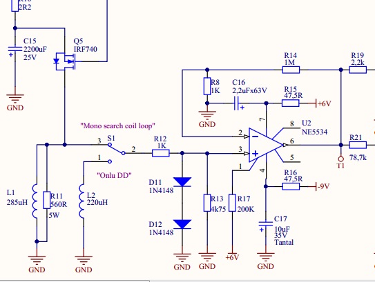

                  hi
                  how to connect tx and rx coil in deeper 10 to circuit?
                  i have make schematic for pcb .
                  if you have pcb it please give it to me
                  thanks my friend.
                  • See schematic
                    TX connect to GND and Drain Q5
                    RX connect to GND and R12
                    The pcb is in the topic

                    • Deepers 10dd good
                      has no problem but it does not sound
                      • you mike it salare12
                        • hh but i dont know how it works well wethout sound .
                          • Yes it works too weak sound
                            In rejet mode
                            • Can you tell us about search coil how . You made it.
                              other thing can i use 250pf instead 430pf
                              • Dont change cap values because it can affect the performance, use components values according to schematic, take in acount that is the factory design, use the coil that I put in other pages before 2,5 ohms network cable 8 wires. Read this thread from the begining and looking for all my post explaining this. That deepers is good belive me.
