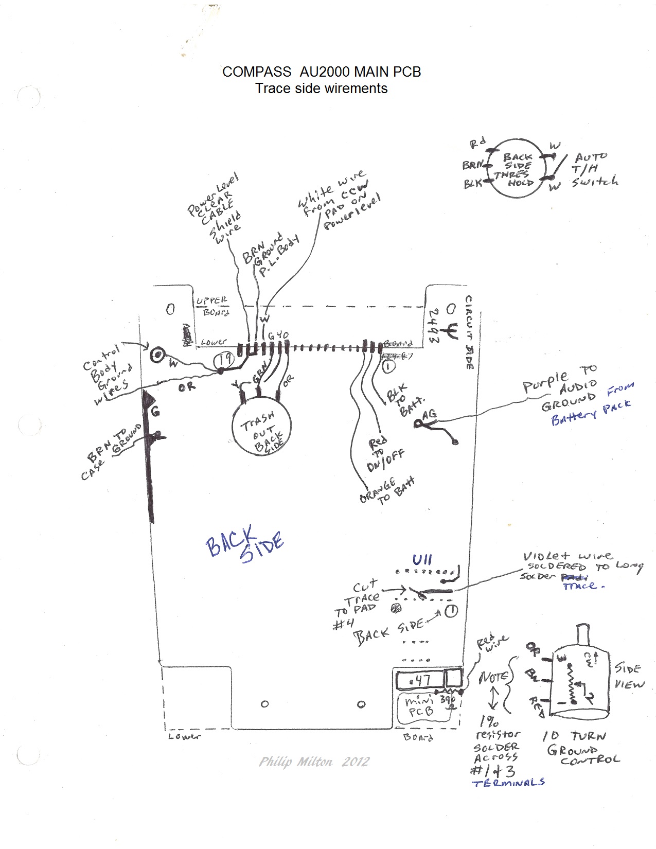

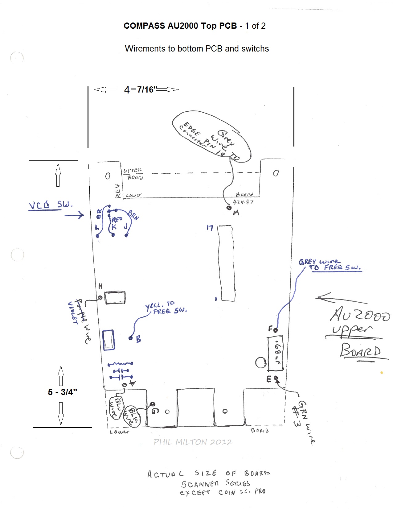

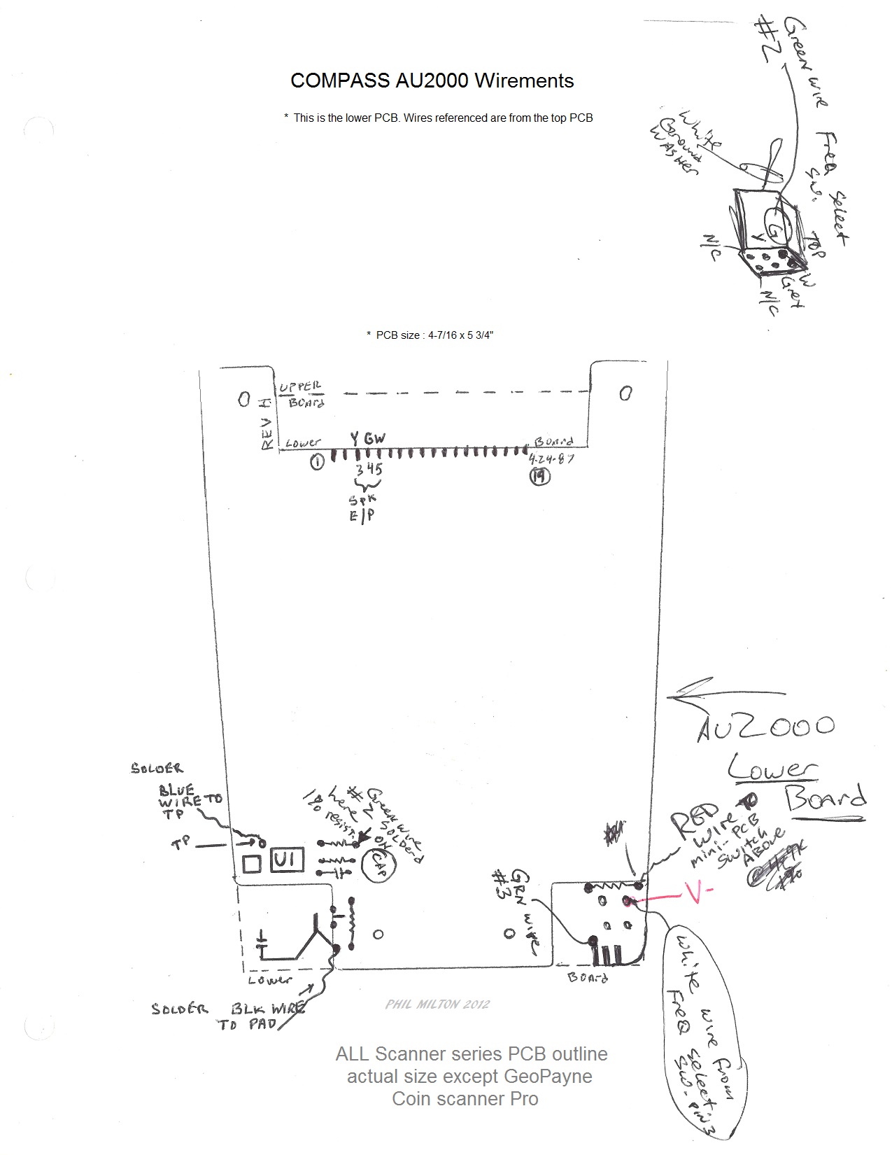

    I did use the Go Advanced and seemed to work so here are a few more pages on the Scanner to >AU2000 wirements. Thanks for the help buddy.
    The AU2000 model runs at either 14Kor 52K and also uses a nice wide range VCO instead of a standard beeper. It can be attached to the AU52. OR with the dual coil can be attached to any other Scanner model. Can also be attached to any Scanner with a standard coil if the freq switch is disabled and you just want a good VCO for the scanner.
    These wirement drawings go with the AU2000 pictures of the top board I posted a few days ago.

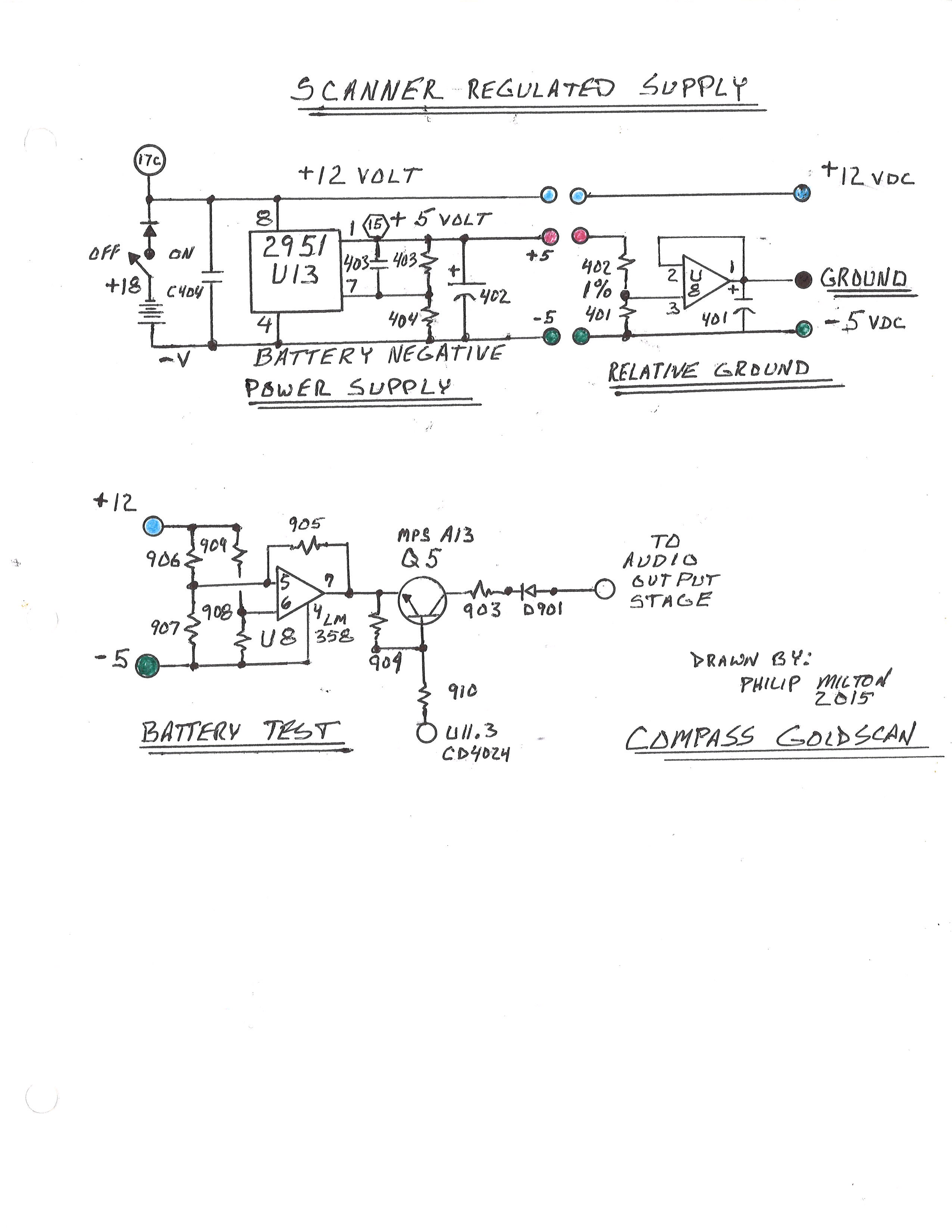

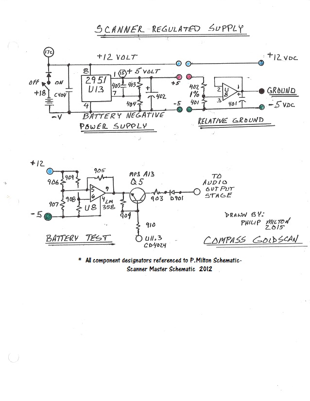

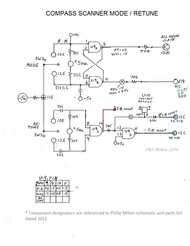

    • #47

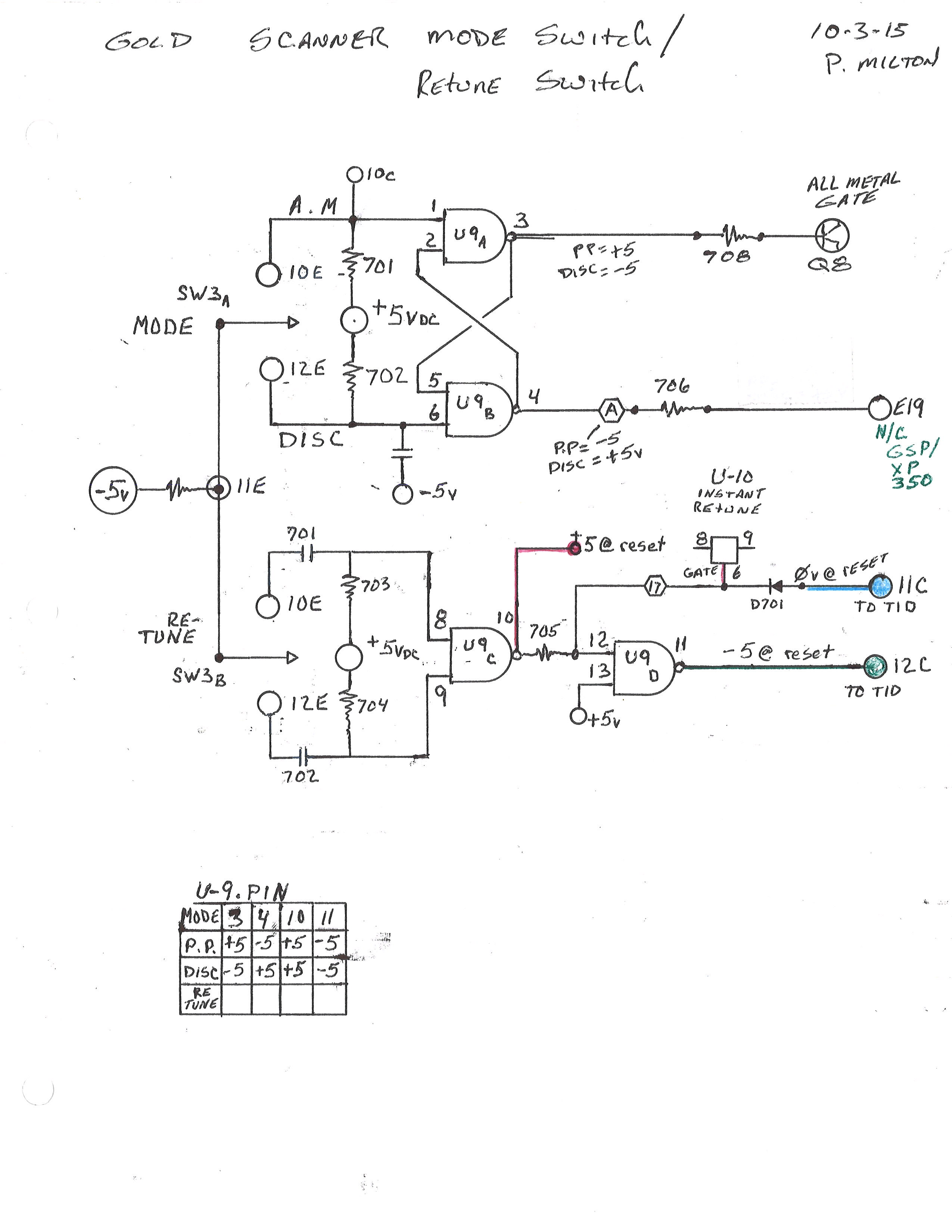

Name:	ScannerModeandRetune Switchs.jpg
      • #48

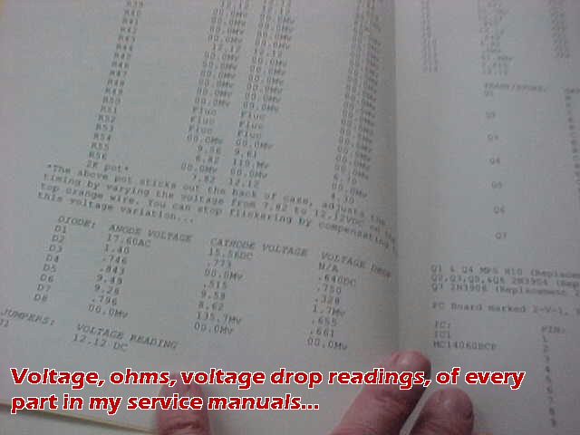

            Man TurtleBowl
            You bring back my memories when I used to reverse engineer things, making schematics of them, even doing voltage readings and ohm readings of each and every part in the schematic. Here is a photo of the pages that show the voltages and ohm readings, part by part... Great work! I admire such work.
            Melbeta
Name:	volt readings.JPG

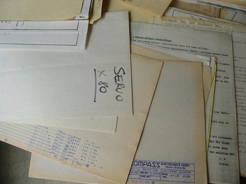

            • #51
              Turtlebowl
              As I said, I can see in the top photo of the original material, the acid in the documents is starting to attack the paper, and is diminishing the quality of the blueprint legibility and the black print on white paper in this photo. Give it enough time, and fade out will happen. I noticed that in the documents I bought from the Australian Compass Service Center down in Australia. If I had the papers and schematics, I would be scanning them into storage in both CD's and in Flash Drives. The larger schematics I would use special sofware to put them into large format sizes.
              Melbeta
              • #52
                TurtleBowl
                In this photo, the air, light, and acid is turning the paper brown as it infiltrates the pores of the paper. Right below, where the Ammonia put the blueprint text, the blue color is fading out. It will gradually fade until all you can see is put it on a light table and look into the image that was exposed into the paper by the blueprint machine. Then I have to pull that image up and out to make copies of it. I have a 300X vertical offset camera to photograph things far beyond what a digital camera will do.
                Melbeta
Name:	Discoloragion and Acid Damage.jpg

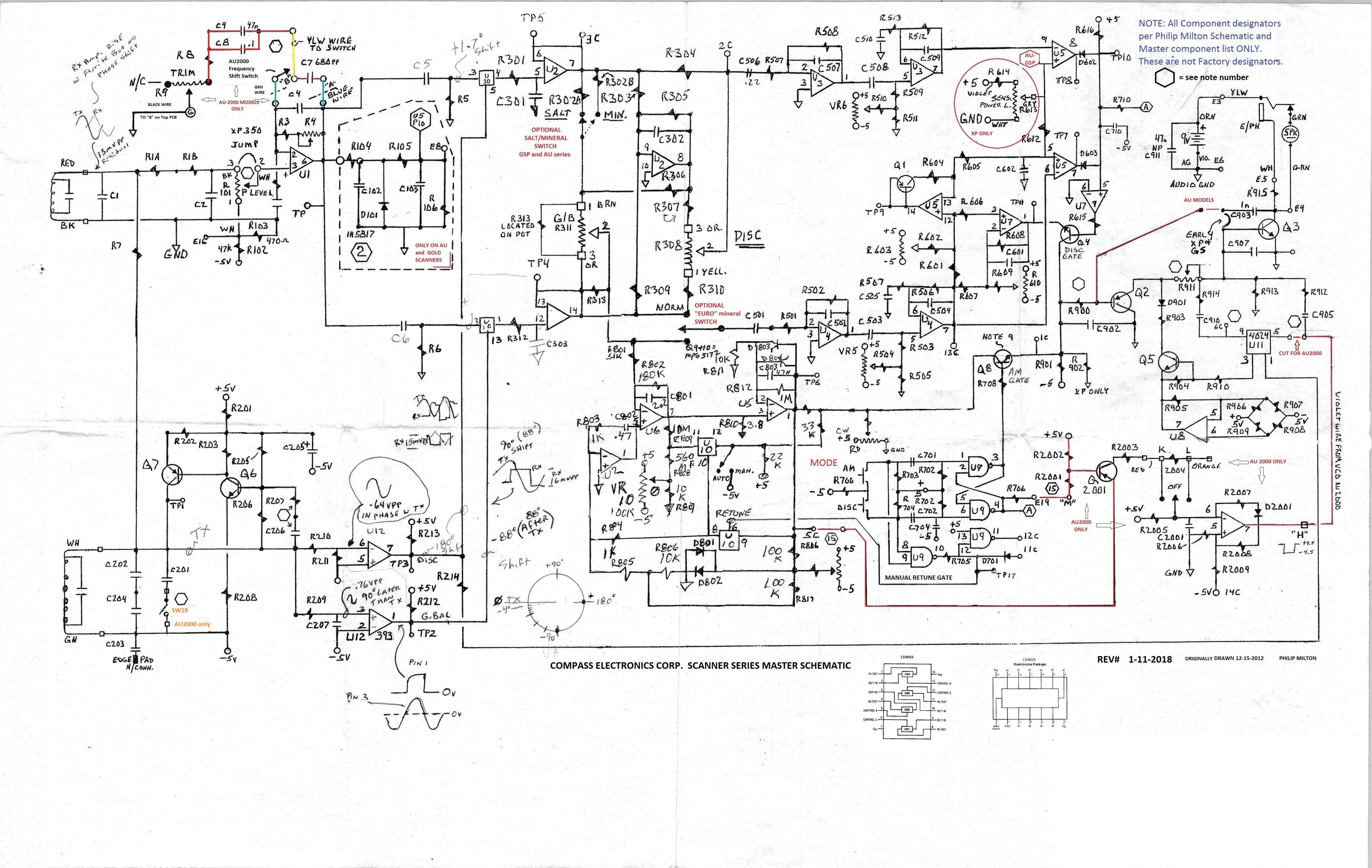

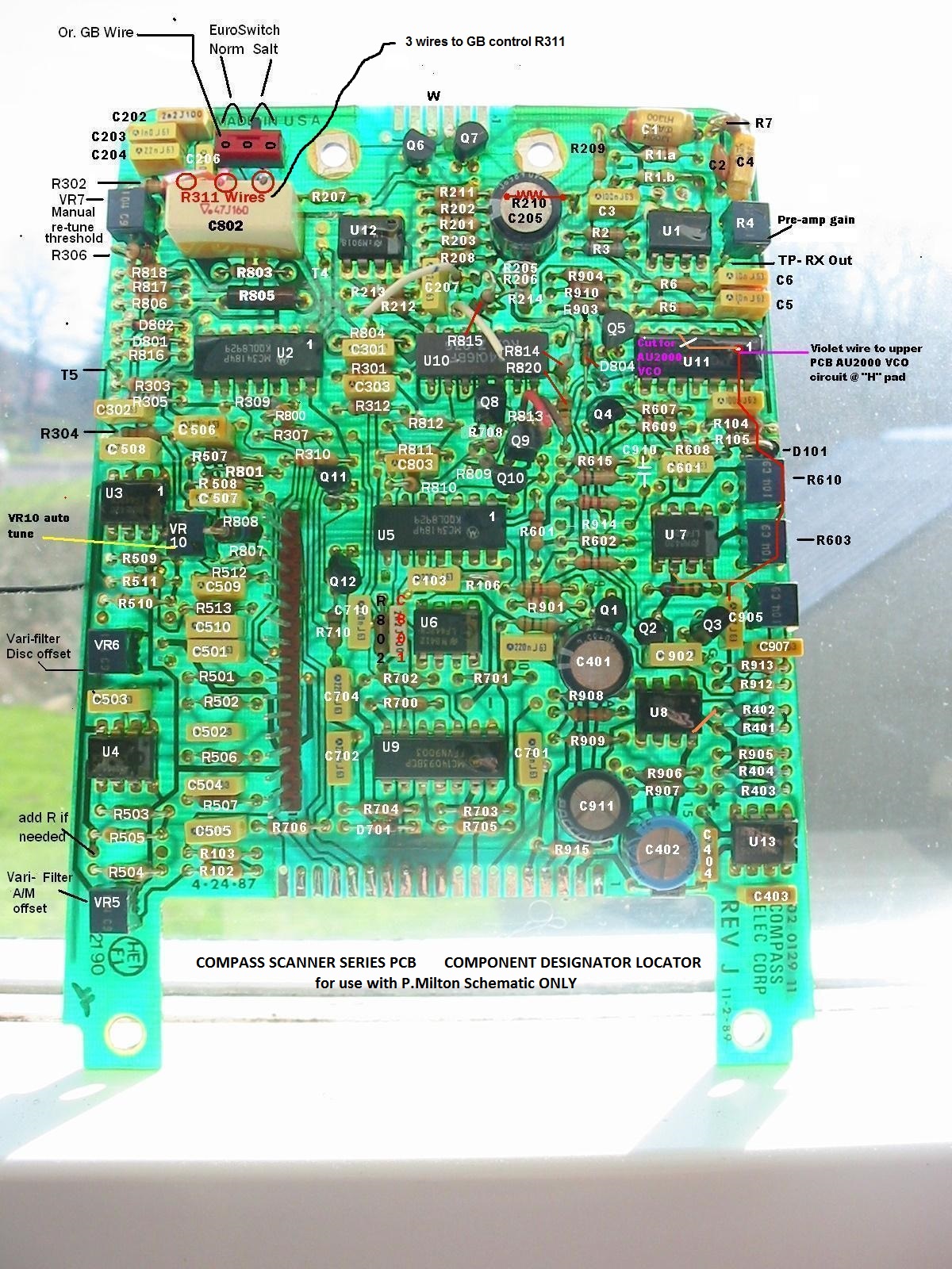

                  Hello fellas,
                  Here is a complete schematic Main Circuit all COMPASS AU, XP and Gold Scanner models. Power supply is on a separate sheet that I already posted along with Mode Switch Schematic.
                  Schematic History:
                  This was drawn and redrawn by myself over many years so I could include all models on one sheet and has been checked fairly well more than once. Having said that there still could be an error somewhere, and I am certain there are REV variations as listed in the component list to be posted soon. But this is a good sound general drawing for the most part covering PCB REV # J, H and K. - I welcome (ask for) corrections if you find them, please contribute.
                  David B. Original drawing posted here years ago covers PCB REV# C, model XP350 if I recall correctly and is slightly different than the one I am posting (schematic). His was based off an early REV C PCB.
                  David posted that drawing at the beginning of this thread to accommodate the TID (top PCB) schematic for the Scanners he so graciously traced and shared a few weeks ago. But mine is a much more detailed drawing covering ALL model specific features, including those after REV C.
                  My work, and schematic, is based partly off Davids original drawing he posted years ago on the XP350. Thank you David for that...That is why his IC Chip numbers and mine are the same. But that is where the similar reference numbers end so be aware when using our drawings side by side.
                  I am going to post a lot of stuff here on this machine so I am saying all this to avoid confusion between his component designators and drawings at the beginning of this thread and the data and drawings I will be submitting.

                  PLEASE Remember the component designators and values in my charts and component lists are all keyed to my Schematic and are different than the factory designators and those used in the David B drawing posted here.
                  Final note. David and I are friends and have worked on these Compass circuits together in the past. I asked him if he minded my contributing all this stuff. I was thinking it might look like I was hijacking his post, given the volumn of stuff I will be dumping here. He encouraged me to post all I have here in his thread and supports experimenting with these John Earle circuits. So enjoy and contribute here if you do anything with these. And Please post any additional info on these circuits you may have collected.
                  Best regards, Phil
                  • #54

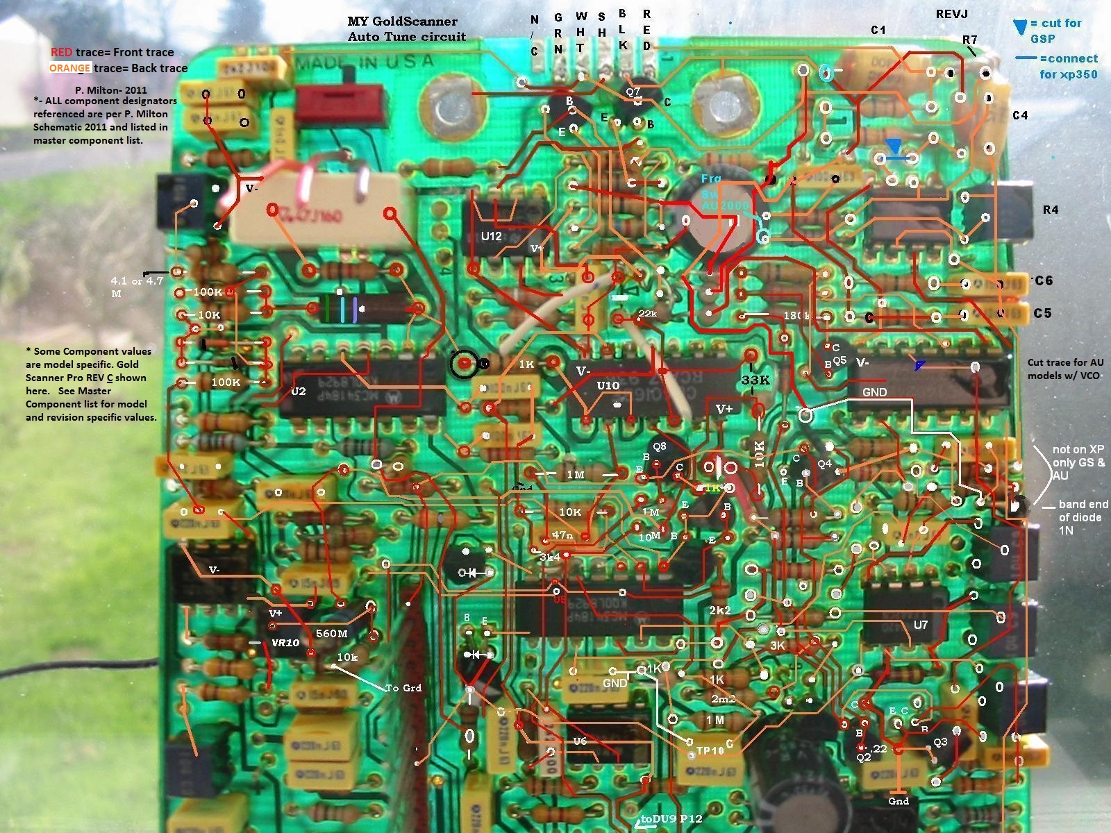

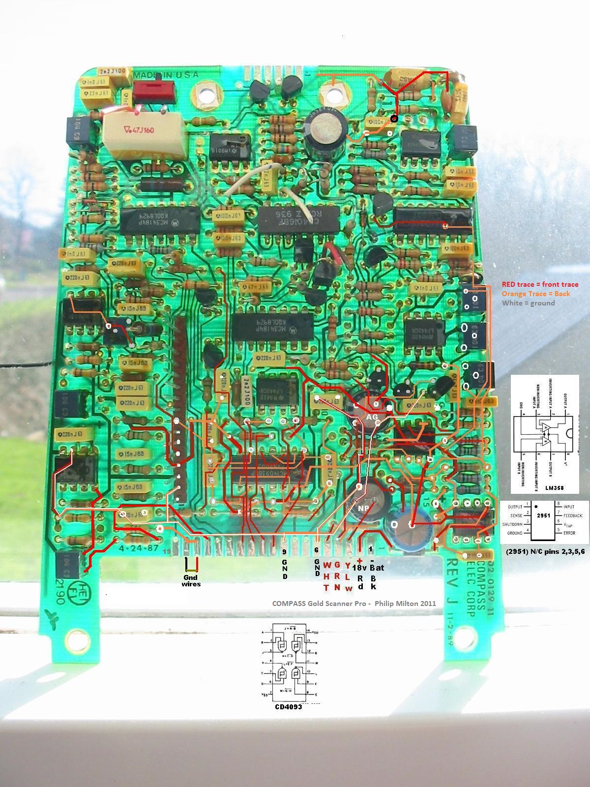

                    More stuff useful for tracing the signal/ trouble shoot. Red trace front, orange trace back side.
