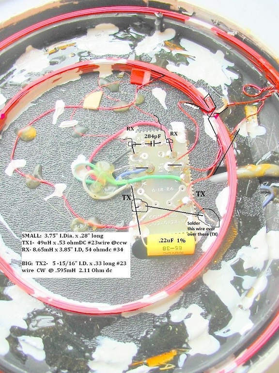

                      Ahhh! That is the little Compass board, they use in the coil, to null the coils. I did a read of a Coin Magnum coil yesterday, using a LCR unit, and the pins were so close together, it was difficult to read. But the Rx pins read 15.7 pF capacitance, no reading on the R or L side. I guess they had it set around Zero Volts? Is that right PHIL?
                      A friend wanted to know so he can build a smaller coil and I was surprised at the readings. Not sure if I read it corrrectly due to the low readings. My LCR unit I have not used since 1990s... Maybe it went belly up?

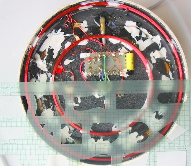

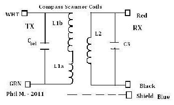

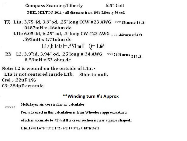

                                Here are some pictures and Coil specs on one of Compass's most sought after Scanner coils. $125-150 on the bay but very rare to find. A really hot little 6" Concentric for All Scanners and Liberty 13.77Khz.
