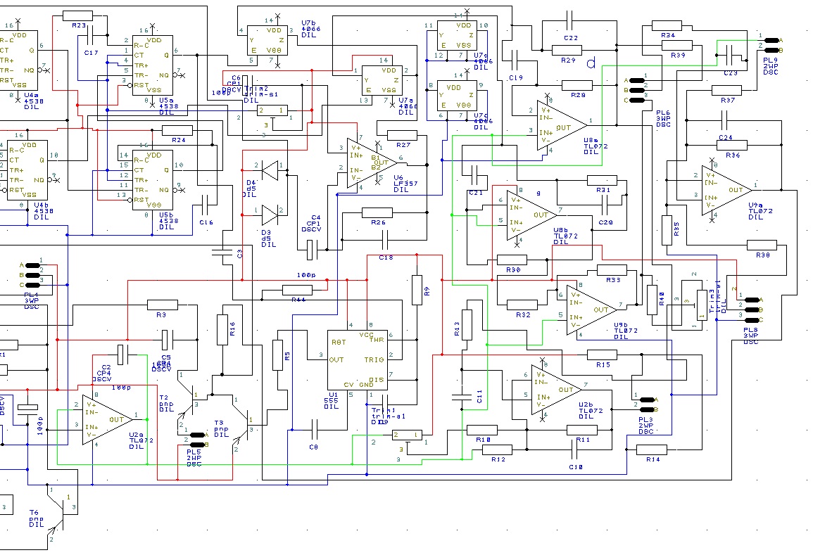

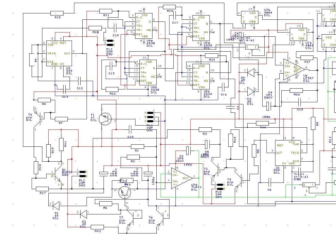

  • Scheme from the PCB Artist program.Click image for larger version
ID:	353881Click image for larger version
ID:	353882 There are no errors are. The signs number off details are different !!!

      • Which schematic can I now rely on, which is faultless ?
        • @ andi build the latest clone pi and have fun

          • https://www.geotech1.com/forums/atta...7&d=1556082873 schematic is o. k. Ground Ballanse and Discriminator simmular in Goldscan 5.Detector is tested in normall ground.
              Always hate to see such awkward way of drawing schematics.
              Purposely messed up to the level of being completely confusing.
              I was going to say the same, it looks as if someone drew it just so it would fit in a minimum size square.
              Thanks for the redraw.

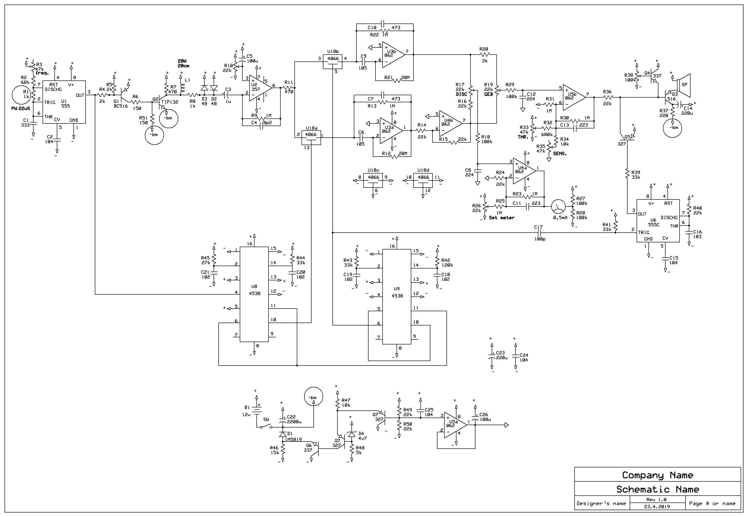

                • Originally posted by scs View Post
                  I noticed error a transistor VT9 is connected back. Please for excuse.[ATTACH]46087[/ATTACH]

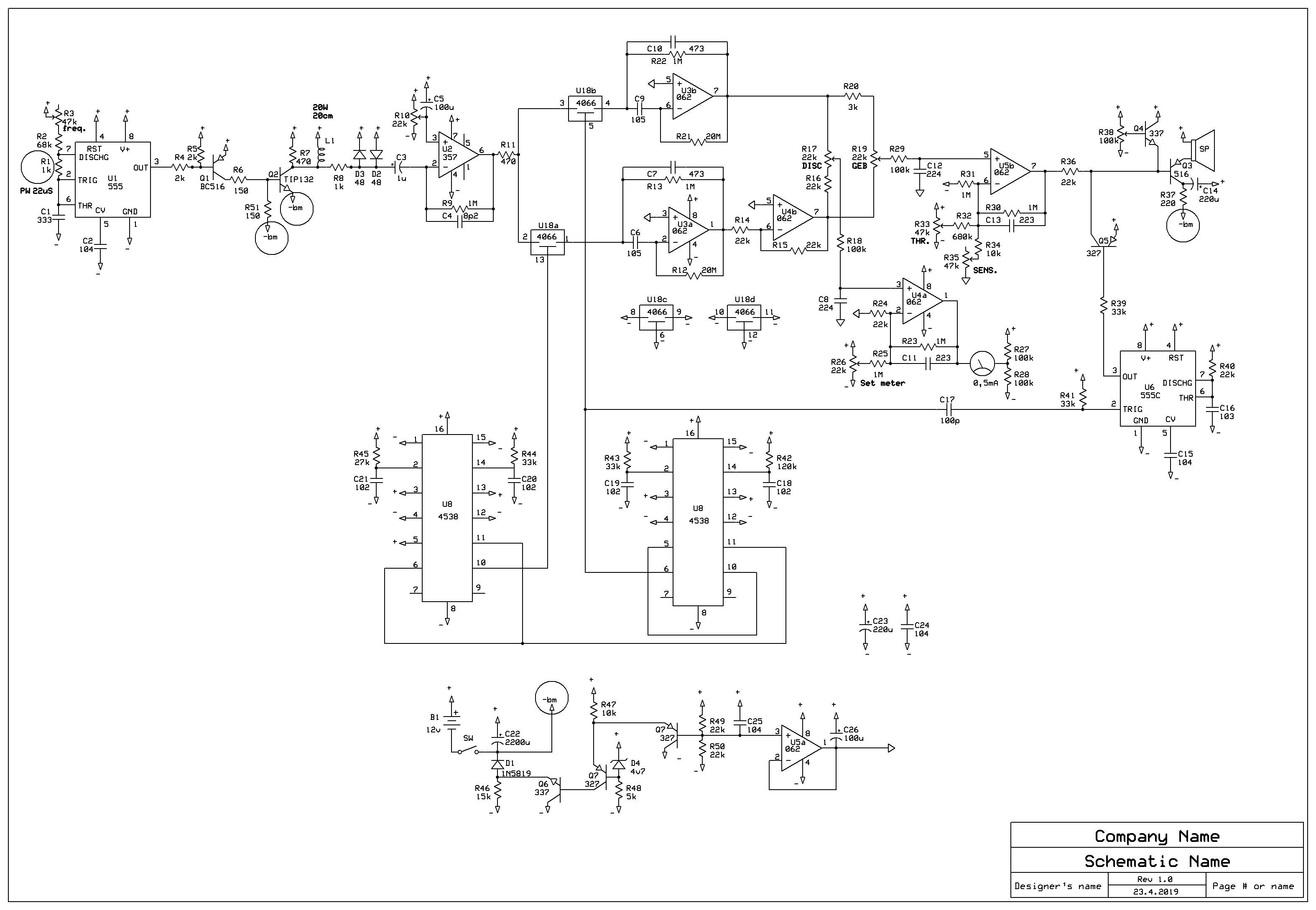

                  Correction updated... so far this should be the one, according to all available info:
                      [ATTACH]46112[/ATTACH]
                      Shouldn't pin4 U8 be connected to pin3 U1
                      Does it take an EF sample?

                        • Thank you, Carl and ivconic
                            Correct!
                            Update:
                            • R27=10k,R28=15k.
