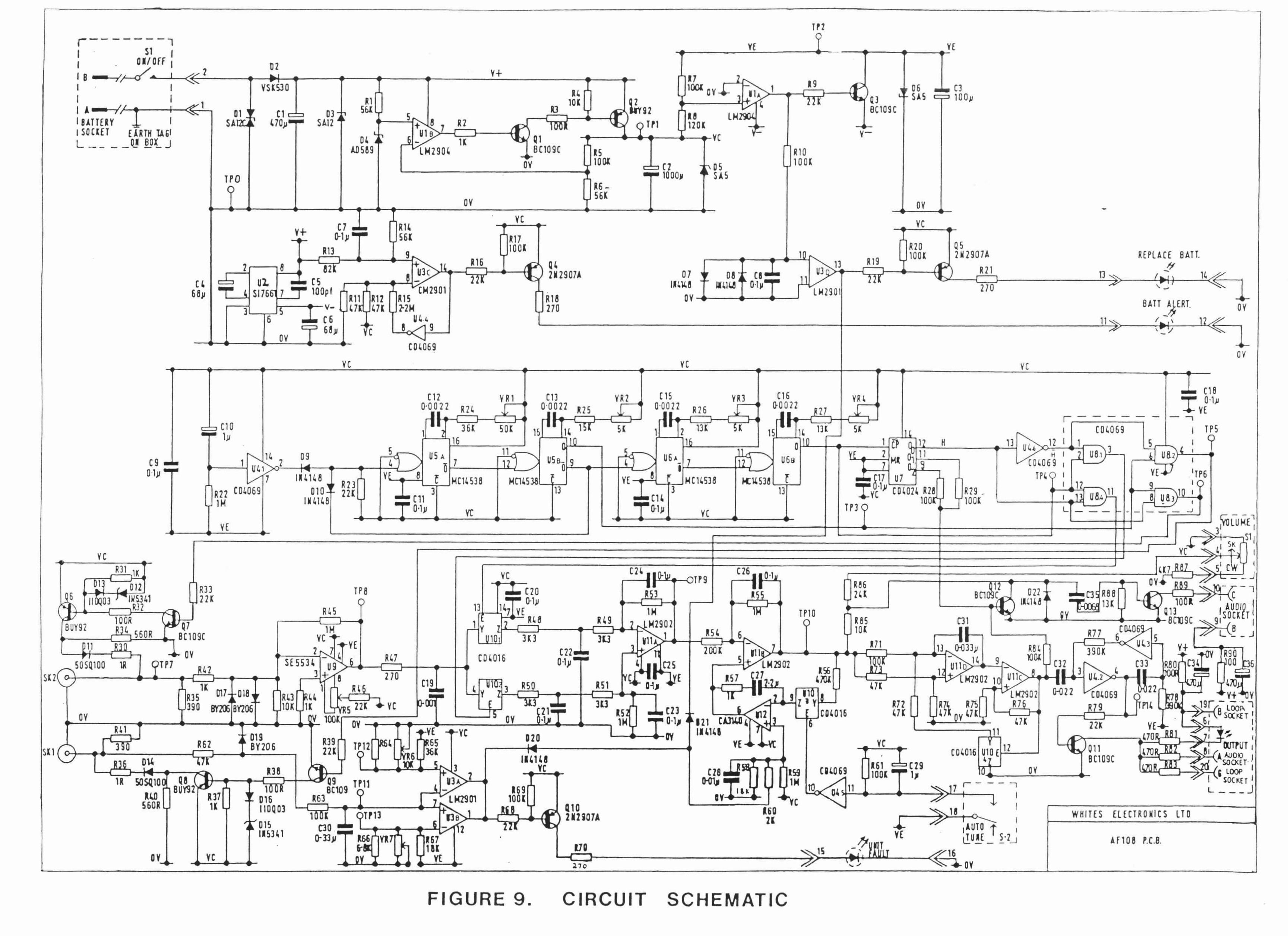

      It a double-mono coil, L1 is pulsed by Q2, then L2 is pulsed by Q4. Here is a complete factory schematic:

            Hi Dbanner,
            have you notice that the AF-108 circuit is almost the same as the Whites PI1000?
            yes. and also the surf pi clicker pro.
