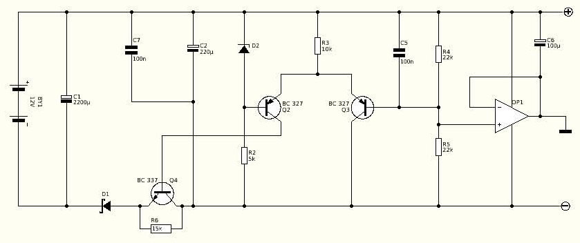

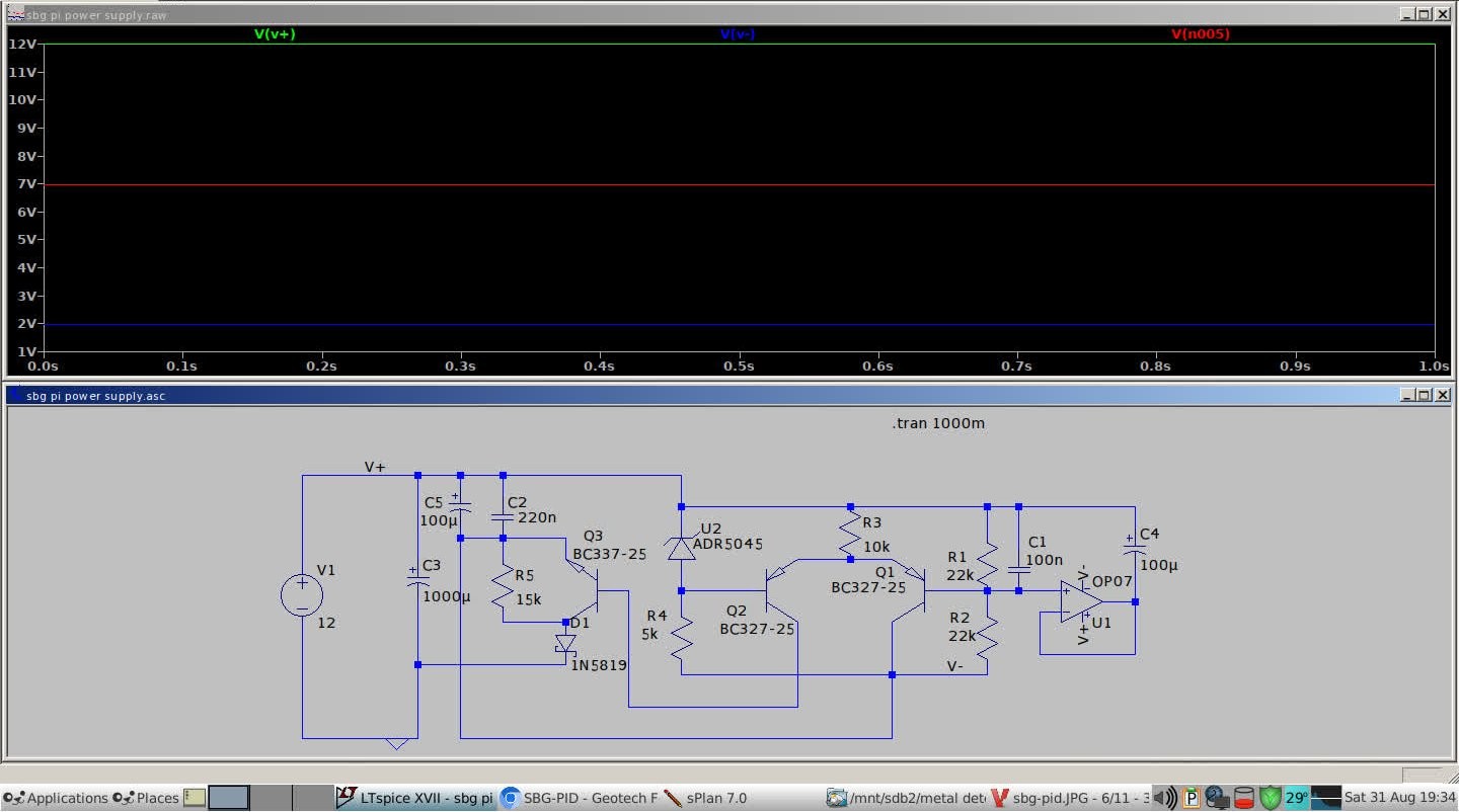

    • change 15K to 5K as in schematic on first post. LTspice results: V+ 12V V- 2V and split rail at 7V. So 5V either side of virtual ground. Seems good. Sacho schematic appears to be correct or am I missing something.

      • the circuit comprising (Q1,Q2,Q3) VT6,VT7and VT9 I cannot give a reason for it.
        • What you are trying to achieve ?
          • Originally posted by scs View Post
            I noticed error a transistor VT9 is connected back. Please for excuse.[ATTACH]46087[/ATTACH]
            yes

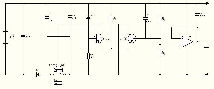

              • Click image for larger version  Name:	sbg pwr.jpg Views:	0 Size:	35.7 KB ID:	426868
                This is how it was meant to be, I think. Now I can make out it is a pass transistor. Circuits are easier to follow when drawn properly.
                  ...Circuits are easier to follow when drawn properly.
                  Exactly!

                  • Click image for larger version  Name:	sbg pwr.jpg Views:	0 Size:	33.5 KB ID:	426879
                    Even better rendition. Perhaps this is how a well drawn schematic is supposed to look. However, I'd much prefer a poorly drawn circuit that works, rather than a well drawn circuit that goes up in smoke.
                    • I always prefer ONLY well drawn schematic that works!

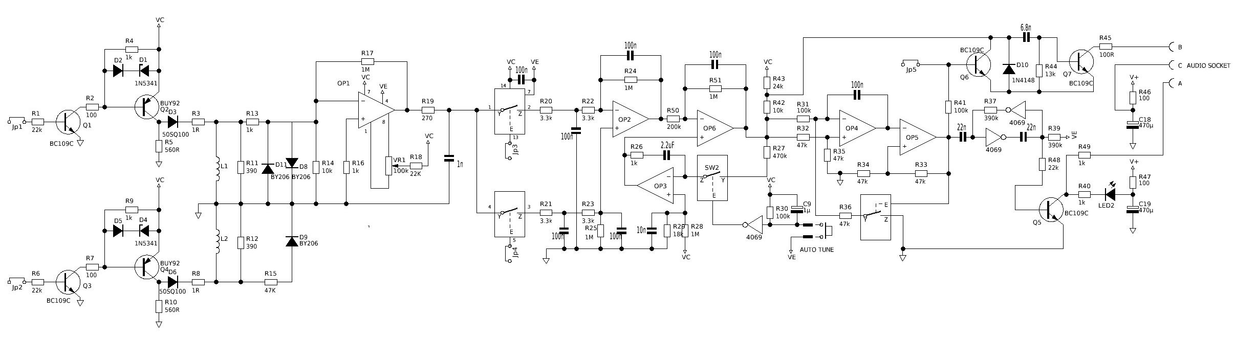

                      • Click image for larger version  Name:	scheme.jpg Views:	0 Size:	187.3 KB ID:	426882
                        An example of a schematic I'm working on. It's a redraw of the AF108 but without the frills. I'm playing around with sPlan 7.0 , getting used to it. I kinda like it.
                        Sacho's schematics remind me of the The Voynich Manuscript,​ for some strange reason it comes to mind.
