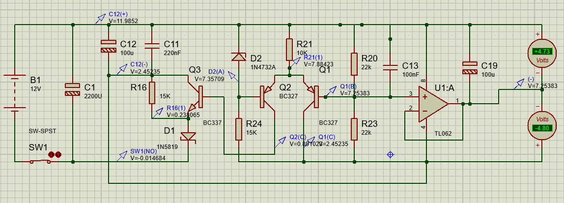

  • Q3 is the series pass negative regulator. In the sim it looks like it is shorted between the collector of Q3 and sw1. The emiter and collector of Q3 are reversed also. Probably other errors
      Everything between C1 and R20,R23... doesn't make any sense.
      Yes, I drew the power section according to Sascho's SBG circuit diagram .

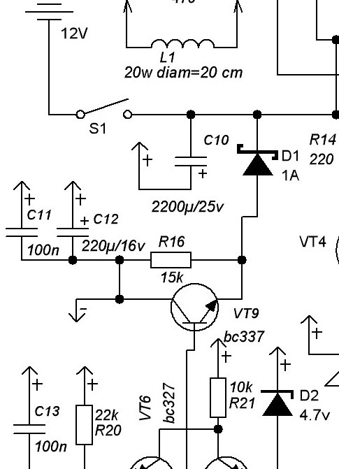

        see this transistor VT9 is not series .

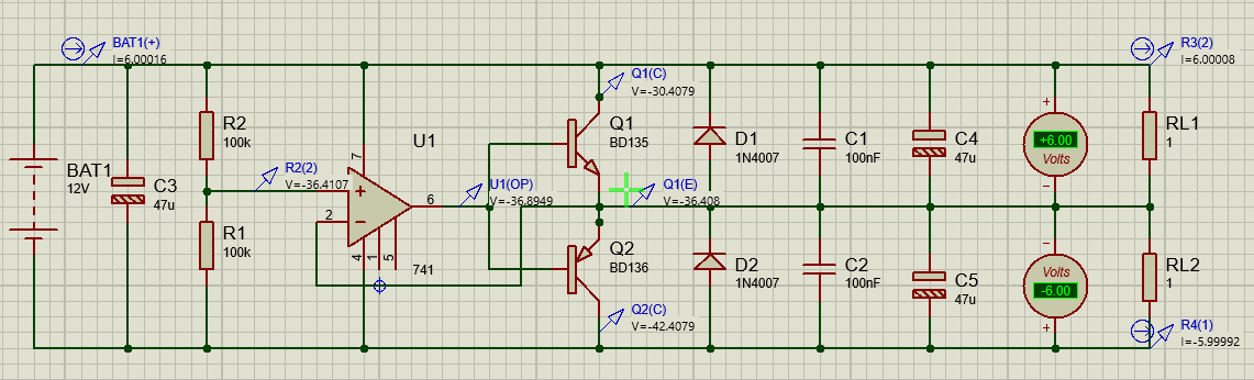

            also your power section drew ........simulation is OK .
              VT 9 is in series. The negative 12v goes through D1 and then VT 9 to v-. The feedback to the base of VT 9 controls the voltage to v- . Judging by the 4.7 v zener, the output should be about -10v and split supply +/-5v.
                but with this configuration .. out pout drop to 4.7V+...4.7V-
                • That looks more correct than the first sim. It will work fine on -9.4V.
                  Add try reversing VT 9 /Q3 collector and emitter and see what output voltage you get.
                    did this test out put drop to 3.18V+...3.8V - . this configuration not correct .
                    • Originally posted by aft_72005 View Post
                      but with this configuration .. out pout drop to 4.7V+...4.7V-​
                      Yes, this is correct.
                      That's not correct, and the original SBG schematic appears to have VT9 backwards. It will still work (sort of), but the beta will be about 2 instead of 100+.
Name:	sbg pi power supply.jpg
                        This works, note orientation of Q3.
