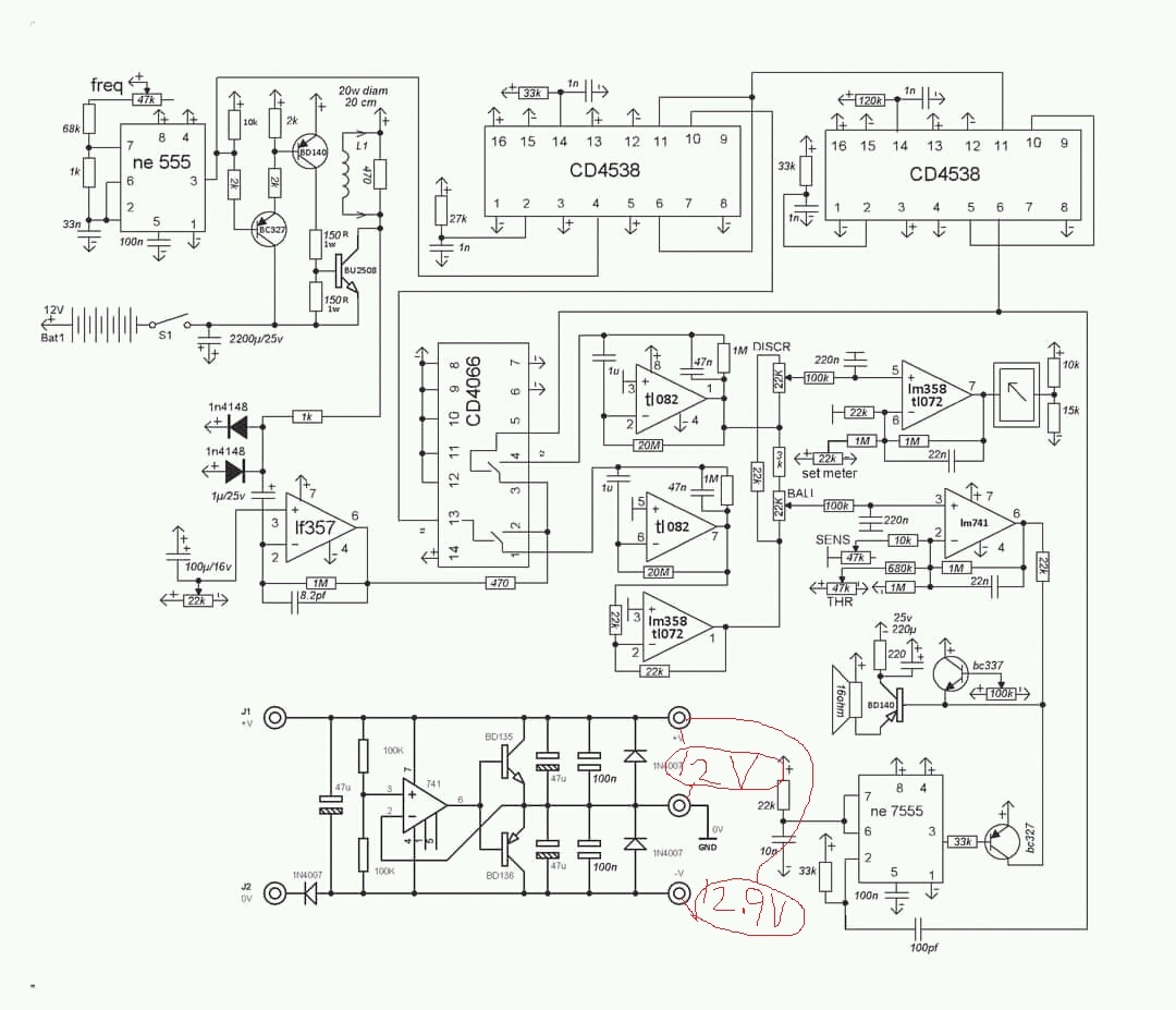

  • I simulated the 741 power supply circuit of SASCHO2 on the computer, the two voltages are 12V and 12.9V respectively, I don't know why it doesn't have a 5V circuit

        sometimes simulate doesn't work correct.

                      • Originally posted by ZOUjiarui View Post
                        [ATTACH]56269[/ATTACH]
                        And a sascho1.
                        who drew this schematic ?

                          • Hi Sascho,
                            I agree with Aft_72005. Interesting simple circuit. I'm wondering how does the discrimination part of the circuit actually works? Or maybe someone else here explain it?

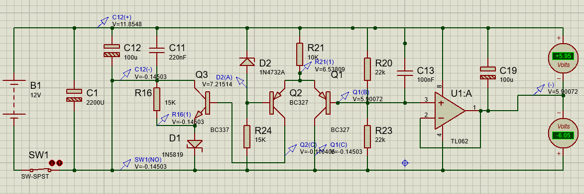

                            • Hi
                              power supply simulation .
                              • Everything between C1 and R20,R23... doesn't make any sense.
