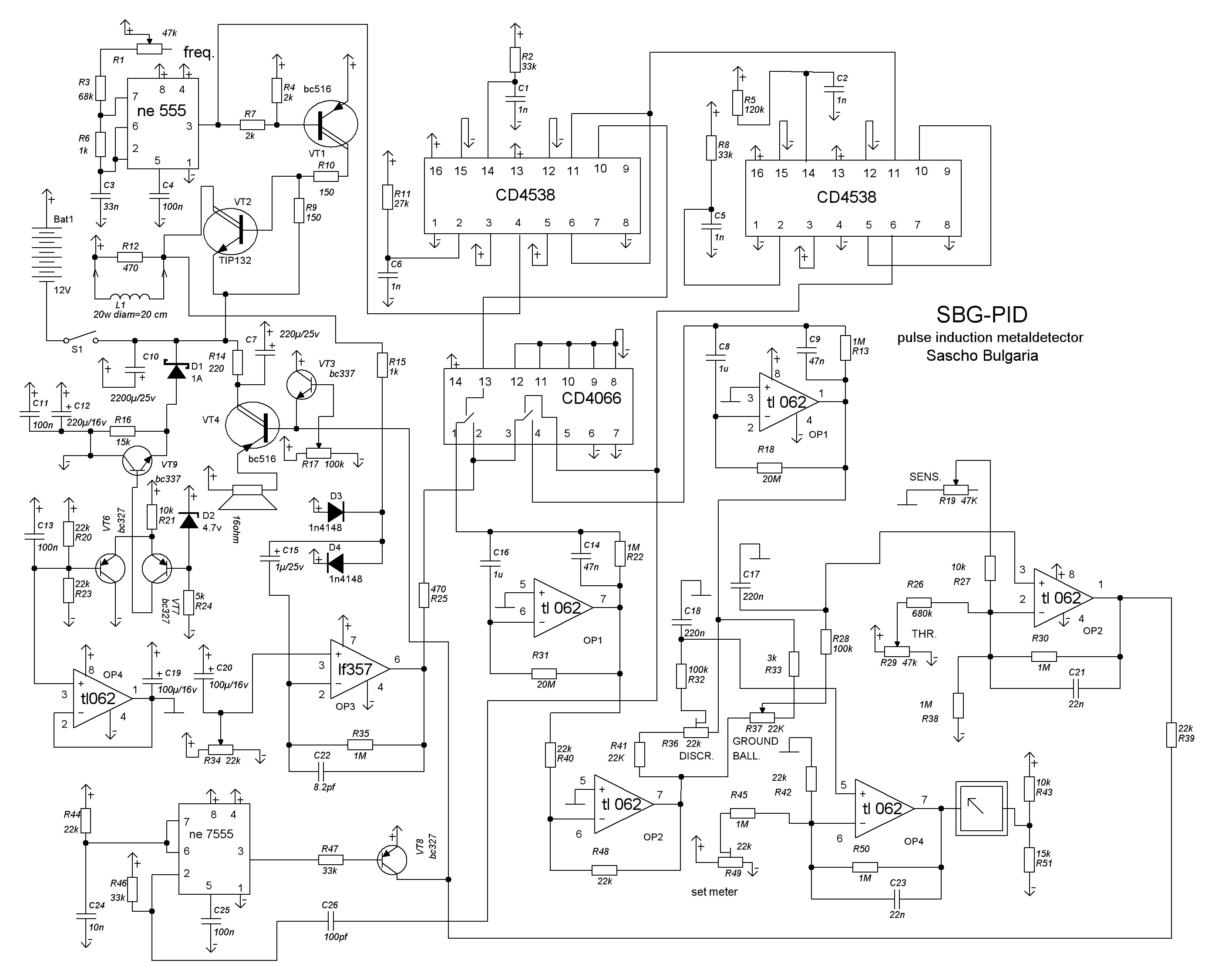

On the SCS schematic, he shows capacitors C11 and C12, they are across + battery and the new - voltage
with out C12 220uF the power supply oscillates, this oscillation wave form now appears on the + and - 4 volt voltage rails, and destroys the TX 555 pulse out.

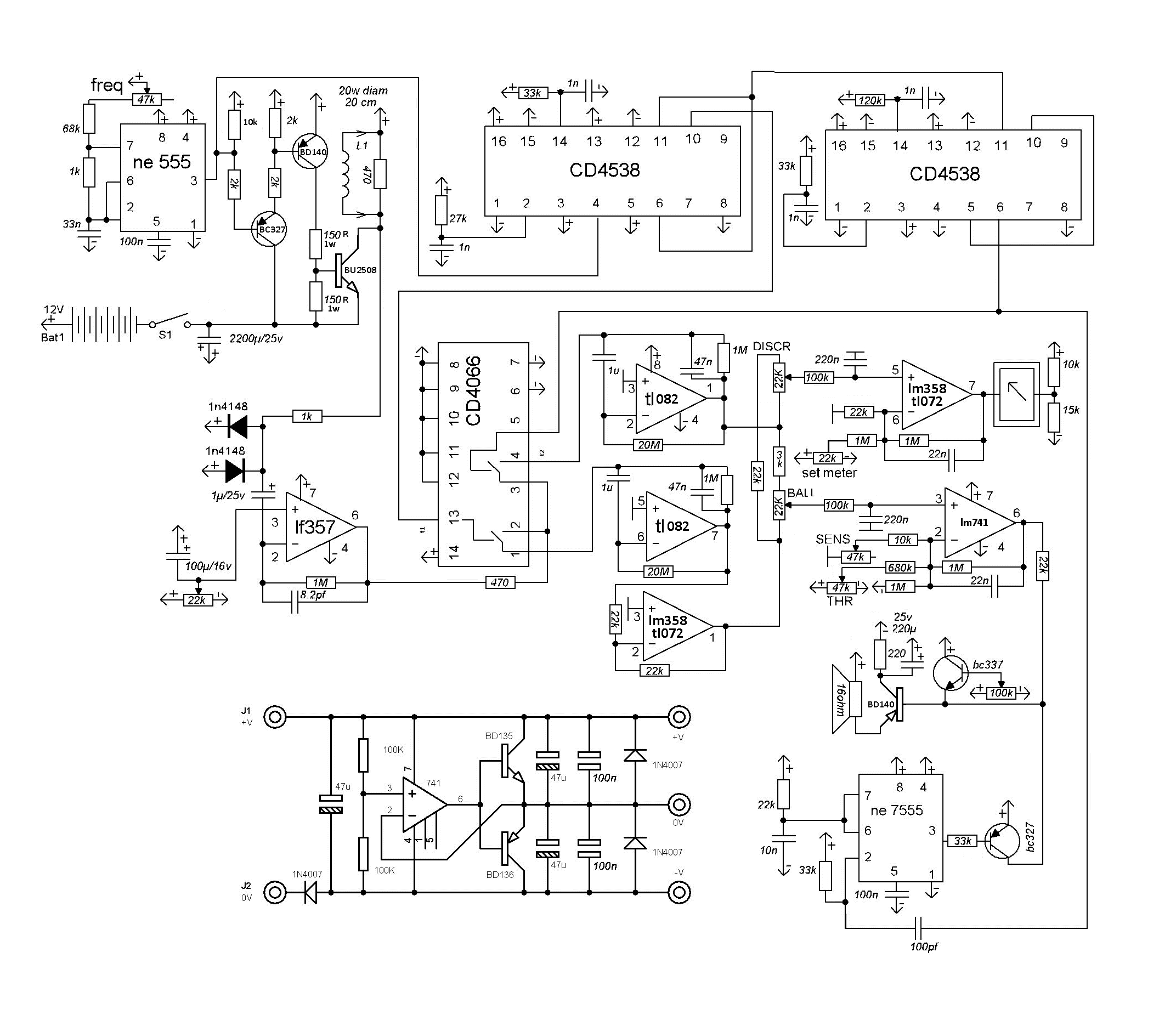

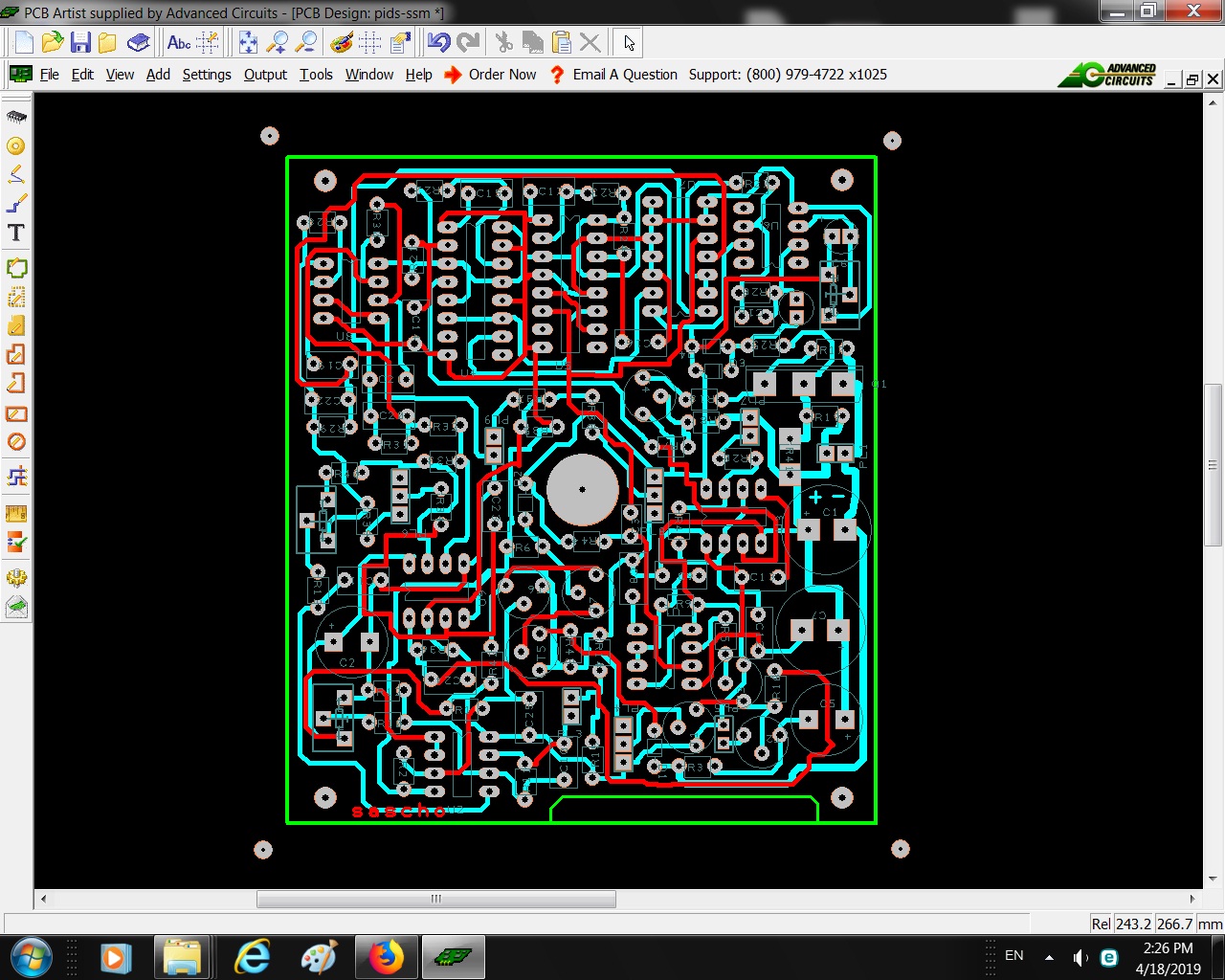

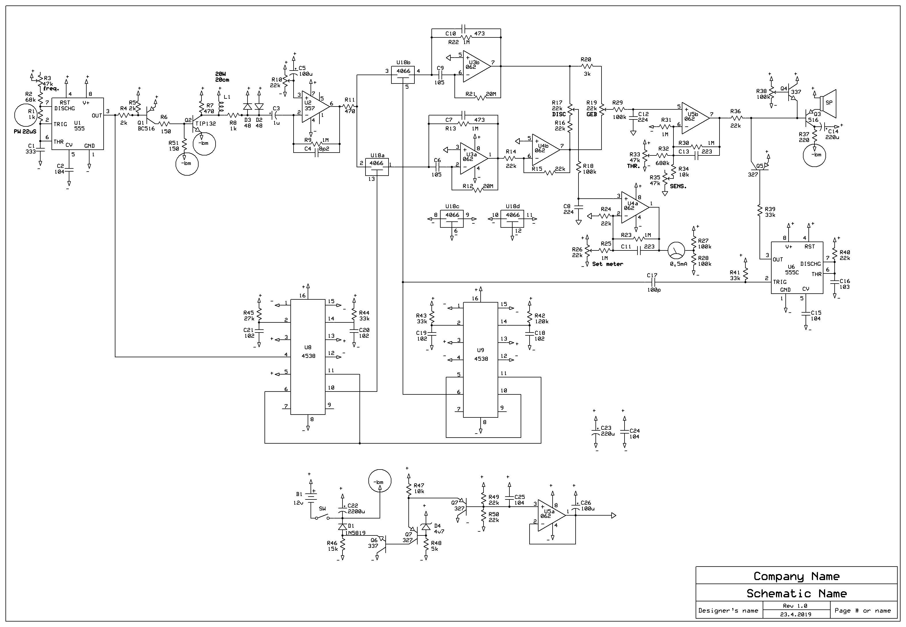

On the Ivconic schematic he has drawn these two caps c11-c12 as C23 and C24, but seems to have omitted them from the PCB layout, or at least I cannot find where they go.

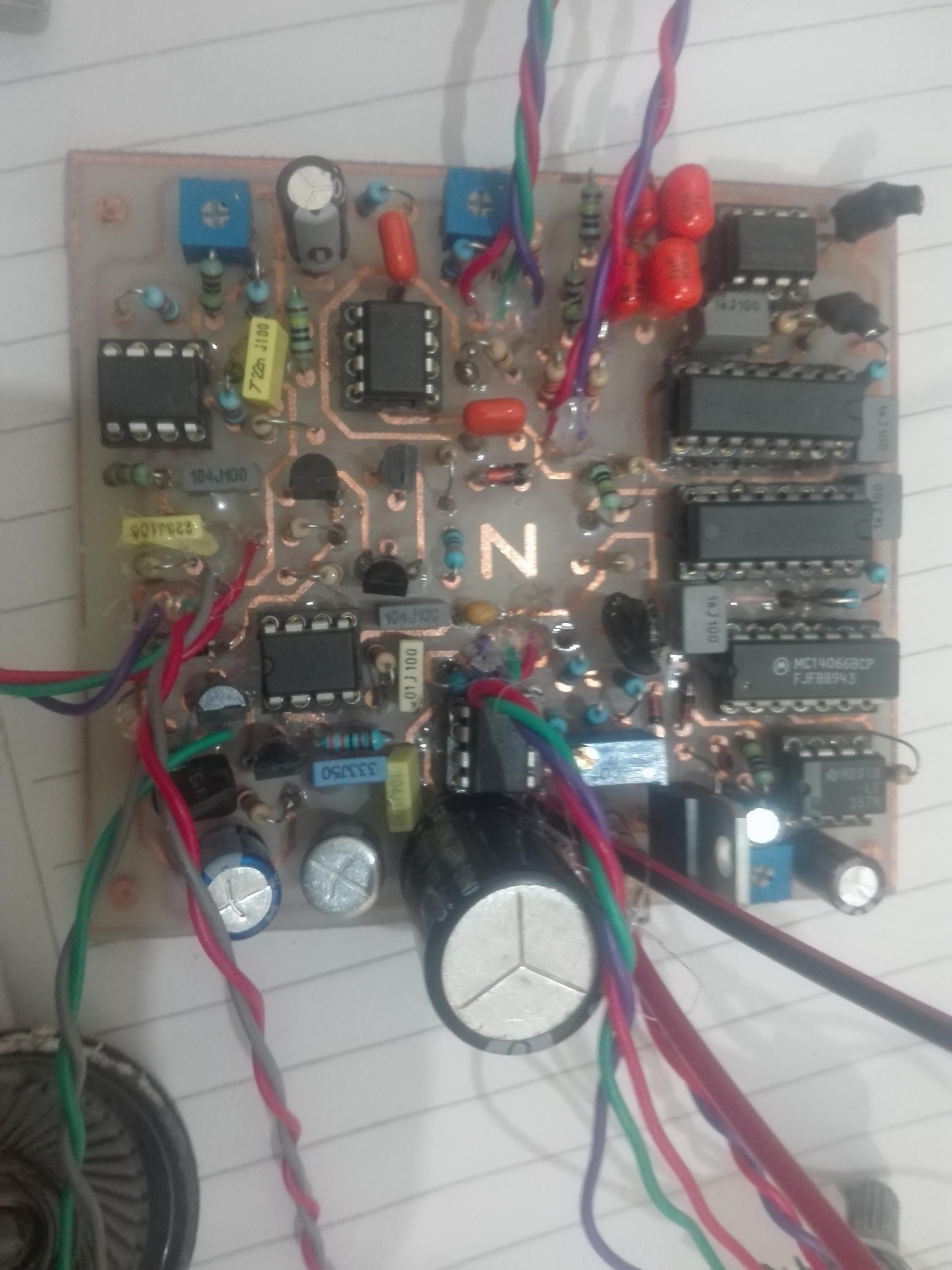

To fix this, I have soldered a 220uF cap across U5a +and - rail and the oscillation has stopped the rails are now clean DC and the pulse from the TX 555 looks ok
U5a is a rail splitter and produces + and - 4 volts
If you make this circuit make sure that the capacitor is in the circuit, and at least 220uF
